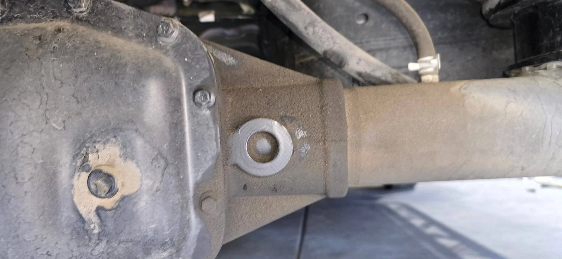

I'm just gonna ask, because googling takes me all over the place... where do I locate the axle vent and hose? I have a thousand pics of under there... but I may be blind and not seeing it?

Jeep Wrangler JL Rear Axle leaking 4642020433555738793-1-jpg
It's the hose coming from the top of the axle tube on the right side of the picture. Trace that hose and the other end there should be a vent little cap type looking thing you need to pull that off and make sure it's not clogged.
And your lift came with a track bar relocation bracket you might want to make sure they actually installed it. Otherwise your rear axle really shouldn't be that off center.

Yeah I knew that was where it attached to the Axle... just wasn't sure where to follow it too... I'll go check it out during my lunch again today. :like:

It's pretty easy to remove the vent hose from the axle ... a pair of pliers to move the clamp and some tugging to pull the hose. Then clean the end off and blow into the hose ... yes, I know it's dirty, but your spare tire cover logo suggests you'll do okay ... if the resistance is low, venting is not the problem.
PS ... the hose goes up to the bottom of the body and is clamped there. Take a look to see if you want to pull it down or remove the hose at the axle.
