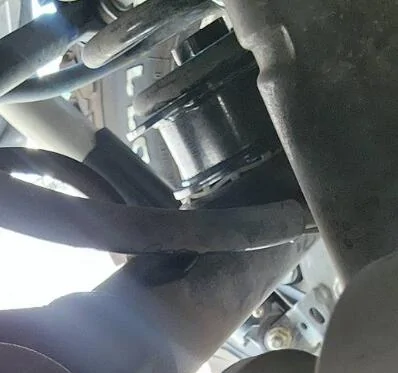

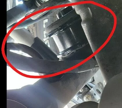

It's pretty easy to remove the vent hose from the axle ... a pair of pliers to move the clamp and some tugging to pull the hose. Then clean the end off and blow into the hose ... yes, I know it's dirty, but your spare tire cover logo suggests you'll do okay ... if the resistance is low, venting is not the problem.
PS ... the hose goes up to the bottom of the body and is clamped there. Take a look to see if you want to pull it down or remove the hose at the axle.

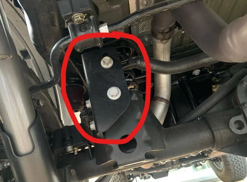

If they installed the rear track bar relocation bracket, it should look like this on your Jeep (rear driver's side):

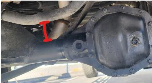

Looking at the height of the track bar in your photo below (how close it is to your axle compared to the photo above), my guess is that whomever installed your lift did not install the rear track bar relocation bracket which would explain why your axle is shifted to one side:
