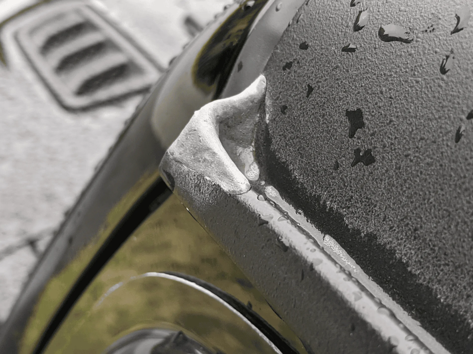

Just my $0.02 here...
While the cheap 'extension' from Amazon looks good and should work well once it's glued in, if you're like me and remove your Freedom tops on a fairly regular basis, you won't be able to store them in the storage bags anymore. :(
I personally think the best solution would be 'gutter dam' @Boatbuilder88 posted or the 'door sweep' solution from @Rubi-Zero, depending on which route you wanted to go as these don't add extra items to the tops themselves, preventing you from using the storage bags. While I like the look of the vent visors @Steven Yates posted up, and even considered them for myself, once you open the door, water will probably start flowing in as usual. Actually, these would be really good if you're stopped at a drive-thru or a drive-up ATM in the rain and should keep water out when the window goes down.
I think I'm going to try the gutter dam first and if that still lets water in during heavy rains or thunderstorms, I'll go with the door sweep method.

Quite correct. The dam solution does work near 100%. Top can be stored without damaging the dam. Dam can easily be sanded and painted. Cost is nominal. We do get a lot of rain in the fall and winter and this simple solution does work.
Just mold and form the putty accordingly.
