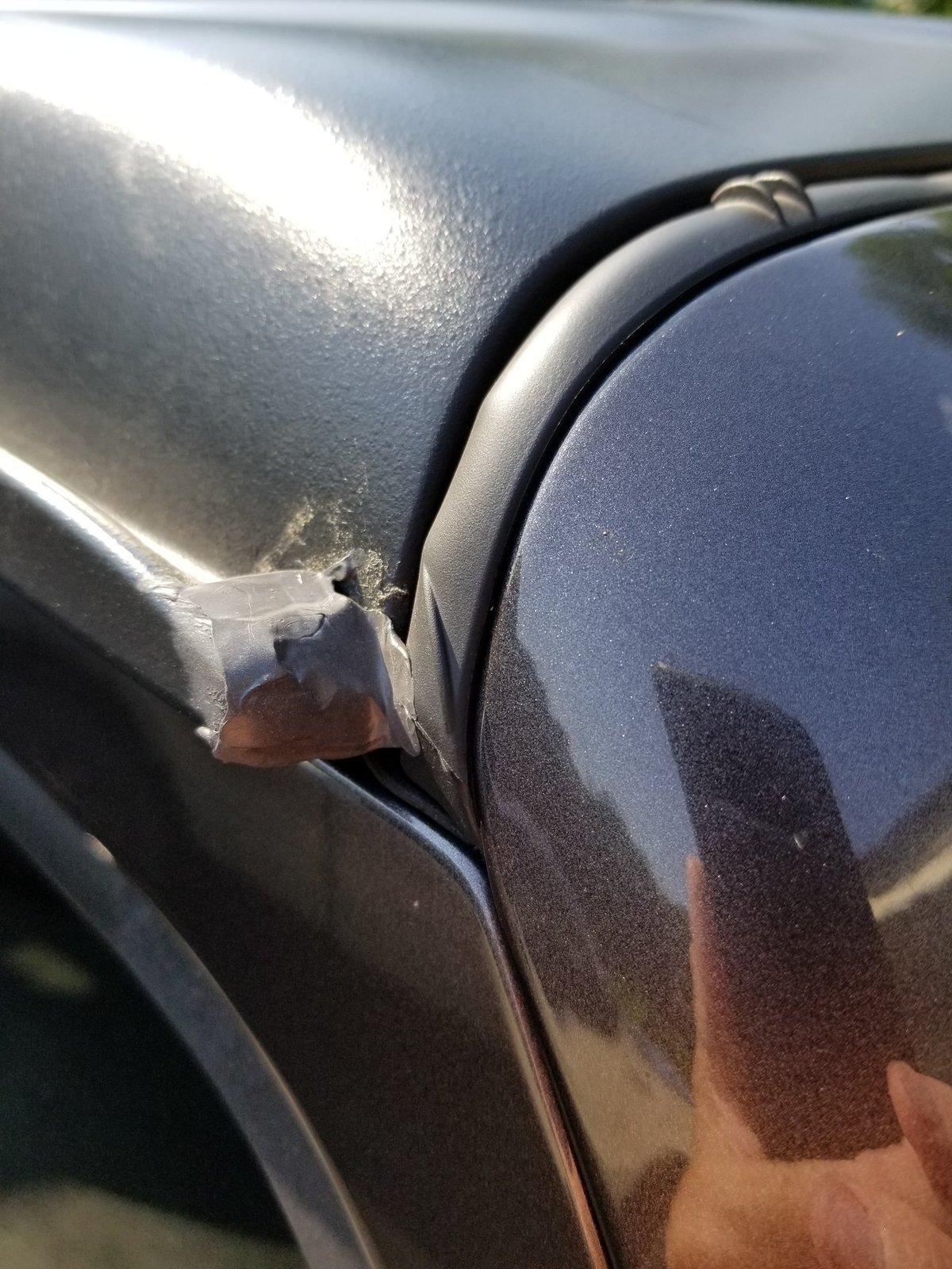

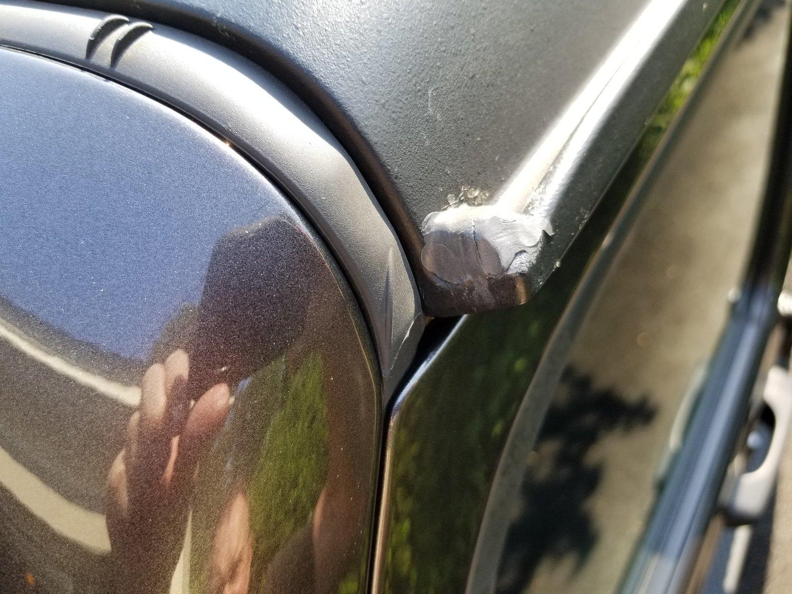

Black silicone - shape with an ice cube while it is wet.
Rained hard in Chattanooga yesterday and a good bit water streamed in every time I opened the door. The water came from gutter near the b pillar and not near the windshield. Are u doing anything to help this?

The problem is the channel from the front windshield, not the sides
No, it comes from the front of the side channels.

I used sugru...that moldable plastic stuff. Works well so far.
Agree. I did as well. I got my finger slightly wet as I moved it smoothly onto the gutter and indented the Botton. No rain yet. I saw a few posts ago the JK solution by a company. I wonder if the JKs will fit the JL with the more raked windshield.
