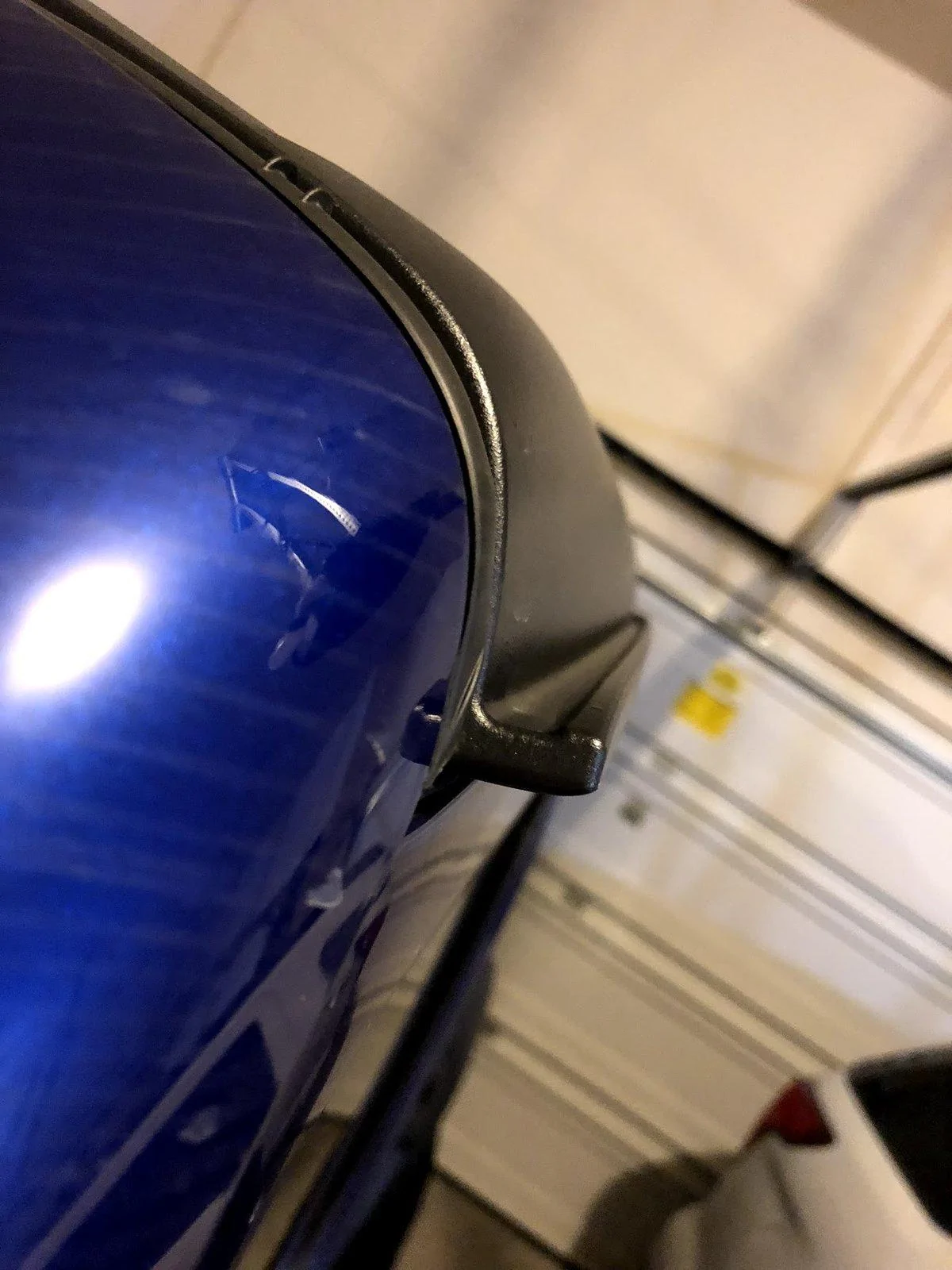

The other night it had rained while my Jeep was parked (flat). My windows were up. When I got back and opened the door, some water drizzled out from the front of the hard top "gutter" and onto my all-weather floor mat. I didn't mind too much, and it's not as bad as some stories I've read, but it got me thinking - why did they end the gutter right there? Furthermore, why don't they just plug the front of these gutters, so water can only run out the back (unless it overflows like in a downpour).
I was thinking I could squish a little black silicone at the very front of the gutter track, and it would block water from drizzling out like that in the front. Anyone tried this yet?? Am I missing something??

It actually comes from the front window track, not the side track. Its been an issue for some time now in the jeeps.

I saw it but someone used "SUGRU" Mouldable Glue and put a tiny square at the end.
https://www.jlwranglerforums.com/forum/threads/cheap-freedom-top-gutter-block.20460/
https://www.jlwranglerforums.com/forum/threads/rain-gutter-extensions-block.9933/

Yeah, though it doesn't rain a lot where in am in Phoenix, AZ, over the last couple months it has, and that's one flaw that is really annoying, is that the runoff from those gutters comes right into the cabin and drips all over the place - didn't happen on my previous JKU.
Never looked this up in the forum so glad I saw this and then the other threads about it so I can try figure something out to prevent that.

Not sure about blocking the front... it will hold water and I'd prefer it drain. Stock jeeps have a slight nose down attitude so it will always run forward. And if it's not draining, all that water that would normally go out the one spot in the front just might come over the edges wherever it wants.
I have seen rain gutter extension tubes mounted on the a pillar for the JK's, but haven't seen any for the JL... though I'm guessing at some point someone will.

I’ve gotten used to running my finger down the gutter to push the water out before I open the door.

Guess I'll toss in my 2 cents. After a pile of snow, was driving around and the snow on the roof is melting. Opened the door and there goes the drip of water. I think the reason the gutter ends where it does is because of the folding window. What they could have done is put a drain hole that would feed to the drain route on the front edge of the door. But maybe with the removable hard top that would not have been practical.
