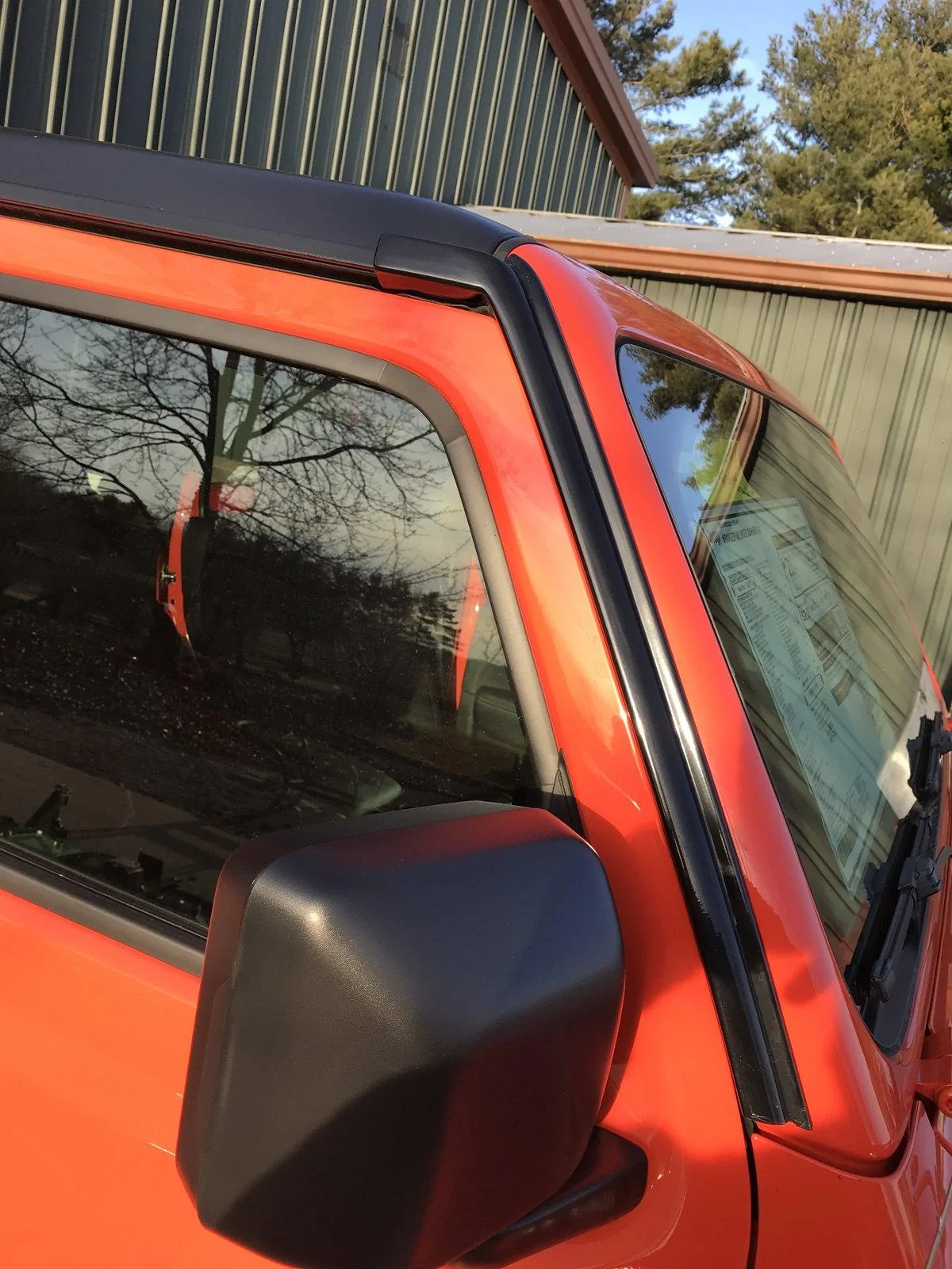

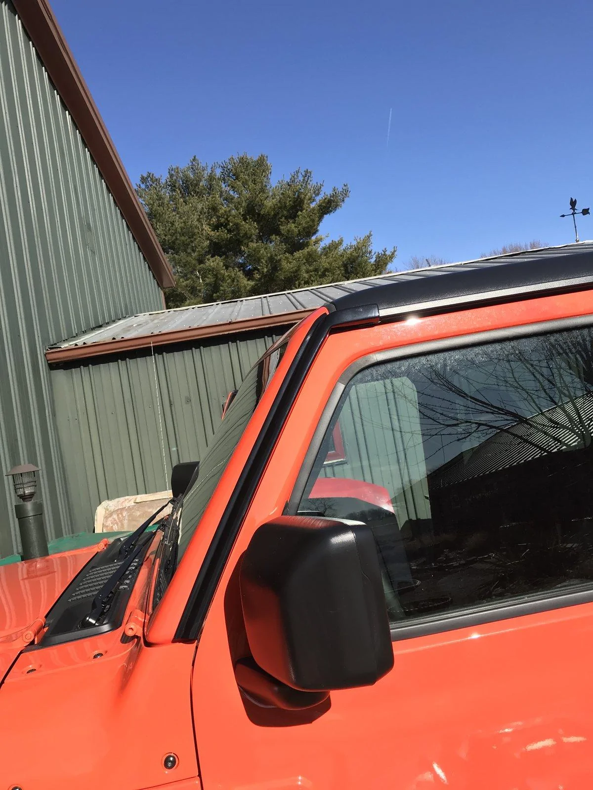

    This Prototype was from Late April/Early May when I asked for an update via email. Indicated they were still working on perfecting the changes to the molds needed to produce the parts.

    I’ll take a few wet spots in the pants and seat before these ugly things will ever be applied
    BCool, BDJeep1, jluriwan and 4 others like this.
  15. Rudolph Hart
    Rudolph Hart Well-Known Member
    First Name:
    Vehicle(s):
    2018 JLUR GME Mojito!
    Joined:
    Feb 23, 2019
    Location:
    Cheshire UK
    Posts:
    2,642
    Liked:
    18,692
    Occupation:
    Semi retired
    Just wrong, they’re hideous,,
