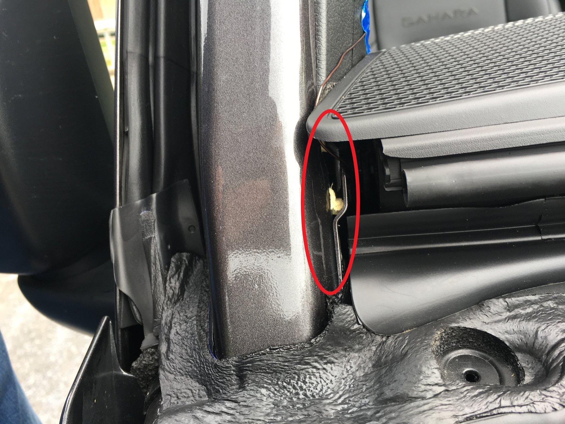

Where would they run the wires to the windshield?
I routed wires from my heater as shown. I used a flexible wire to fish through a path and then taped it in place until I was ready to run electrical wire. in the second pic you'll see the top to bottom wire routing down to the passenger footwell where I used one of my Aux switch wires. The ground point is circled.
