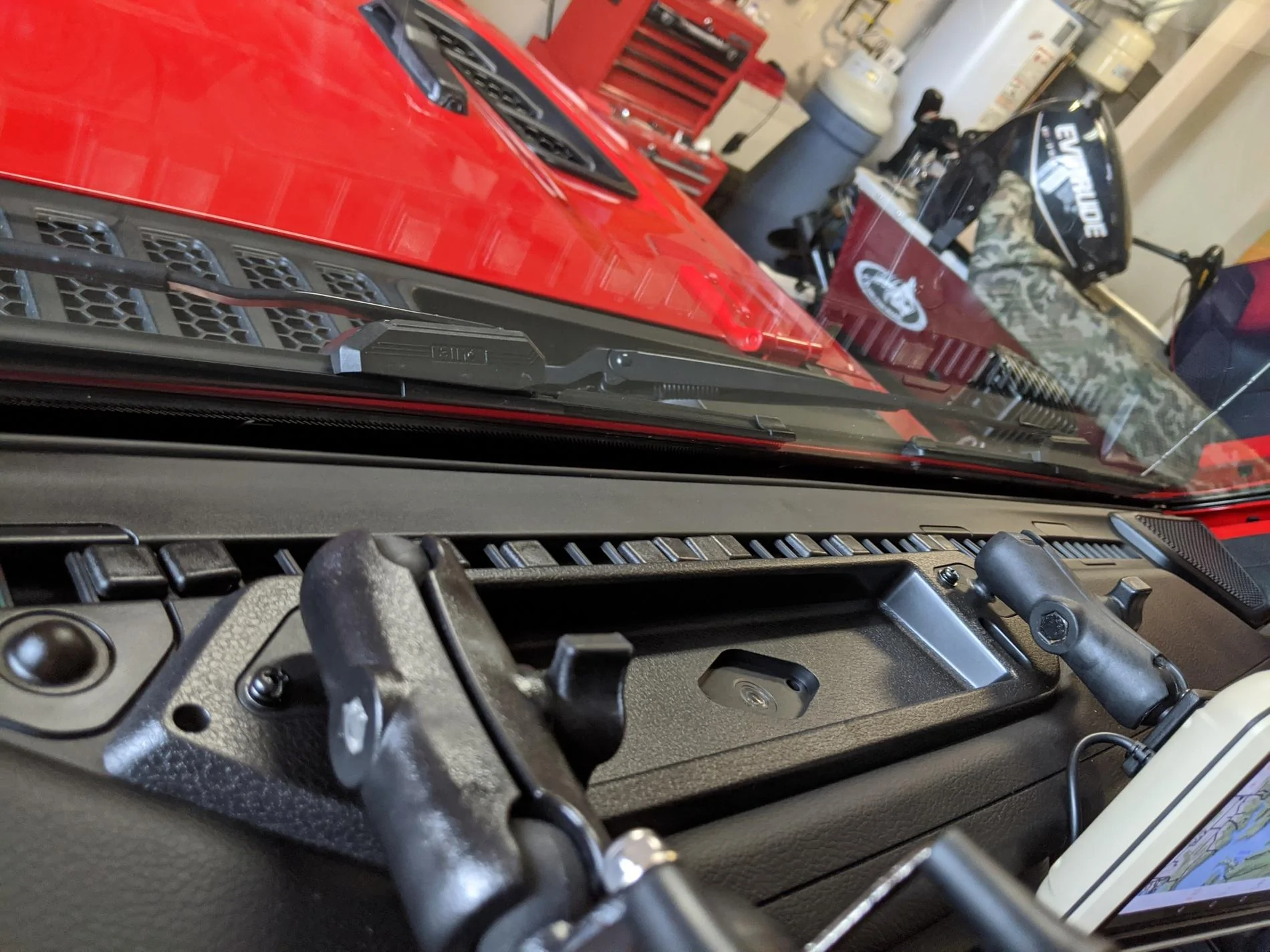

I think my vent cover is in its final form. We had some freezing rain recently and with one notch in the middle there were two spots of ice at about 10:30 and 1:30 near the top of the windshield, each about 6 inches in diameter. I cut two more notches near the ends of the cover and I'm getting good airflow at 10:30 and 1:30. I'm calling it good.

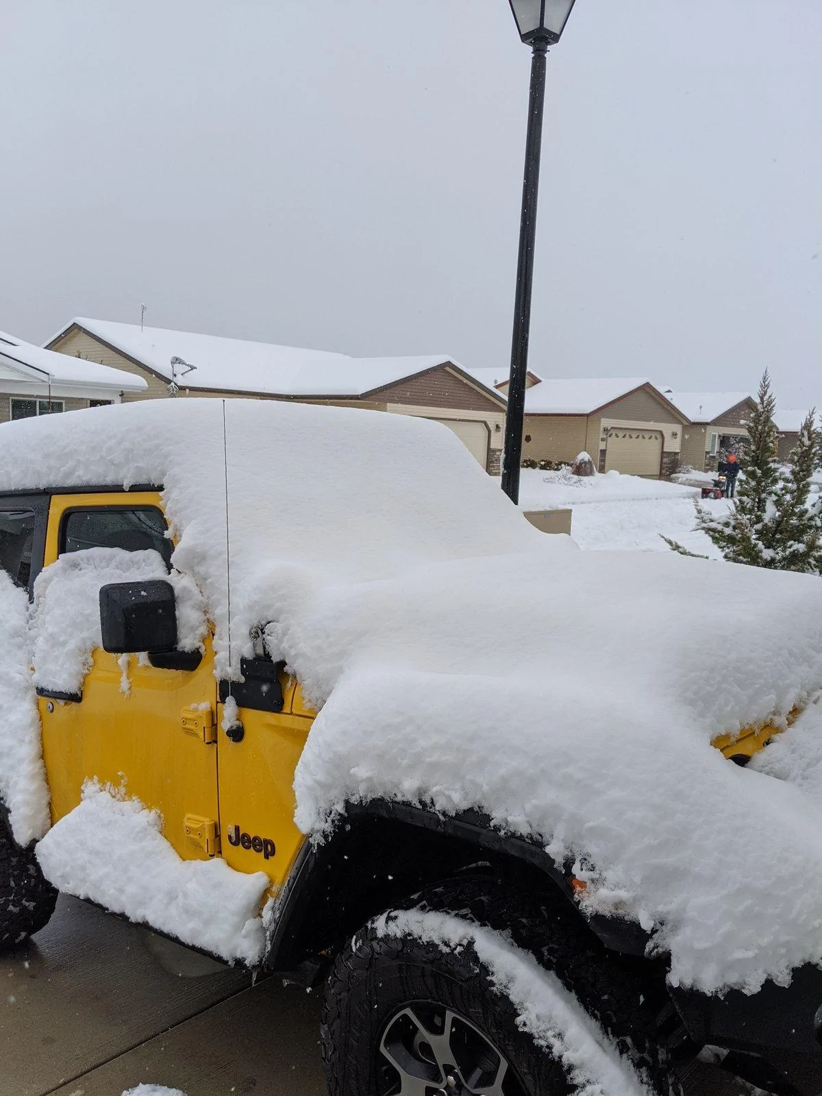

"Our high defrost setting only works on the center 12" of our jeep windshield. The 1/3 on both sides, driver side and passenger side are getting zero defrosting air. My brothers 2019 and hundreds of other 2018 and 2019 jeeps also have this problem according to blogs. The dealership stated that our defrost is working the same as other new jeeps on the lot and refused to acknowledge the dangerous design flaw. I have installed duct tape on the center portion of the defrost vent to redirect the air to the drivers and passengers side windshield. I plan to make a patial perminant block from plastic and install it today. We live in the Rocky Mountains and this jeep would be undrivable in the winter without defrost air flow aftermarket redirection. Zero defrost air hits the driver and passenger side without the aftermarket fix. Jeep owners are in real danger if their windsheild fogs up. We turned on our defrost to high heat and airflow to remove ice from an ice storm a few days ago. Only the center 12-14" were melted. "
Below is the dealer excuse.
The dealer write up pictured in this post states they found no Star cases but earlier in the thread, and I believe it was Jeep Cares that said it, there is a Star Case that may pertain. The number is S1924000008. I was going to bring it up to my dealer soon as I only have center airflow.

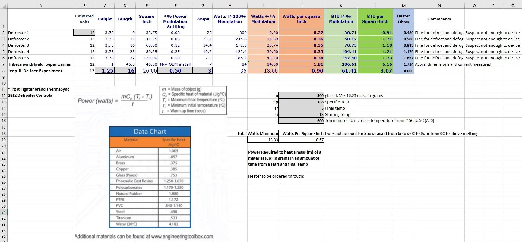

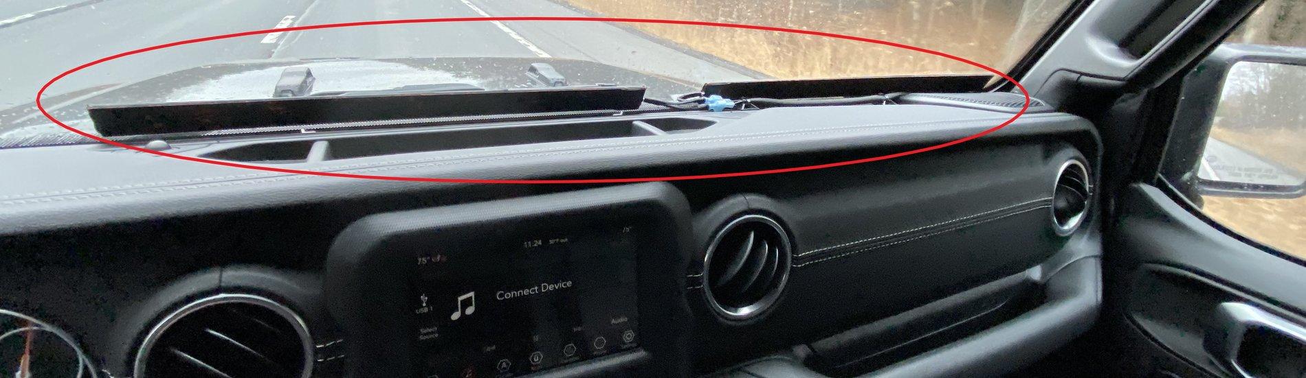

Heated wiper blades are pretty common. I was suggesting something that's just a small strip of the same electric resistance/wire defroster found on back glass. Not tall enough to be distracting
The attached pictures are what I'm working on at the moment in the way of wiper area heaters. I used the wattage output from the wife's car as my baseline. I'm presently only at 50% power (18watts each side) as wanted to experiment first and not crack the windshield. The heaters are easily removed In the case of needing windshield replacement due to stone hits. As for now it's a work in progress.
Yeah can confirm about this much airflow is all you need in the middle. The rest then gets pushed to defrost the sides - down all the way to the lower corners. Is a silly FCA design oversight - but is fortunately fixable. We just used 4 HD hook and loop adhesive squares to cover the slots and works a charm. Fast and low cost but a tad ghetto. Def play with the placement to get the airflow exactly where you want.
Aug 22, 2019
Chicago, IL
2019 JLU Manual
I experienced this Jeep quirk here in Chicago last week during a proper snowstorm. The snow and ice just stuck to the blades and only the center of the windshield was getting heat. As a quick and dirty fix I pulled up the rubber insert from the dash tray and placed it over the center defroster vent to divert the hot air to the sides of the windshield. Worked like a charm.
