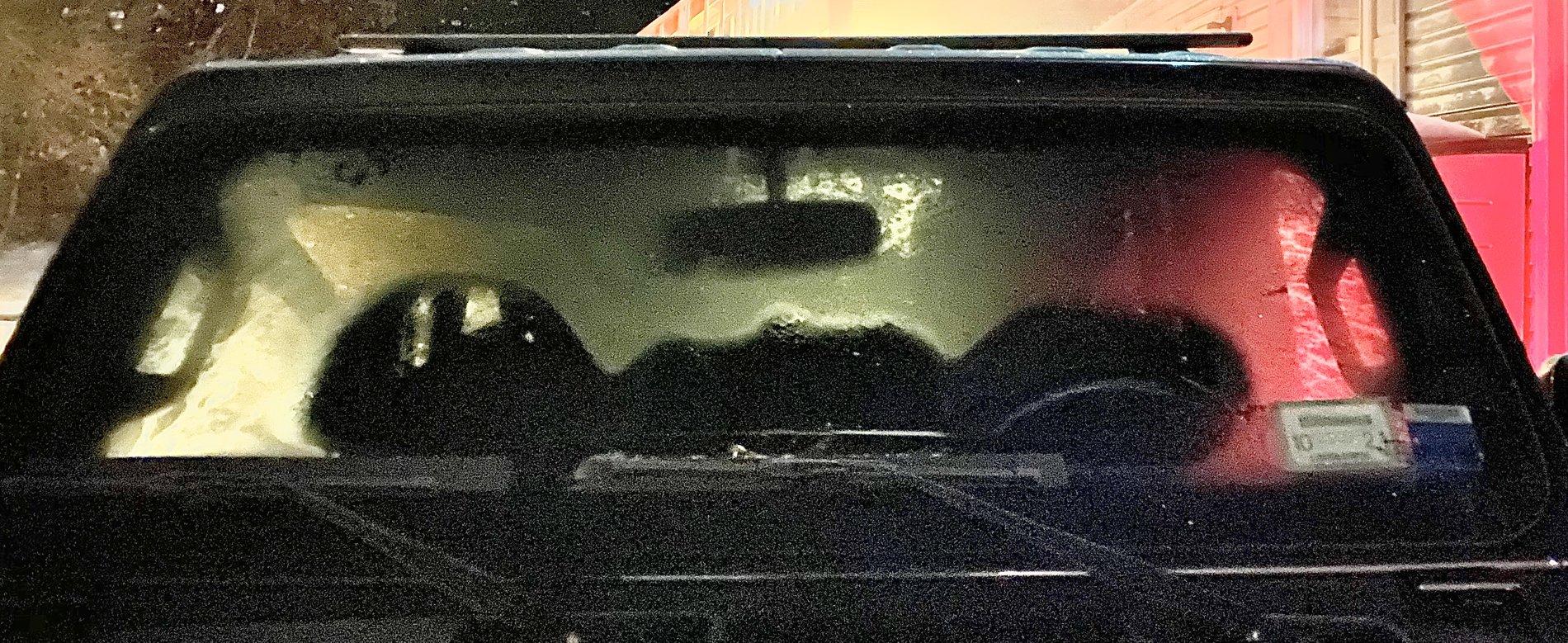

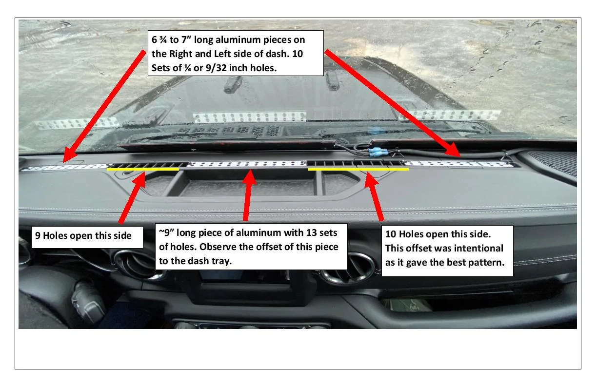

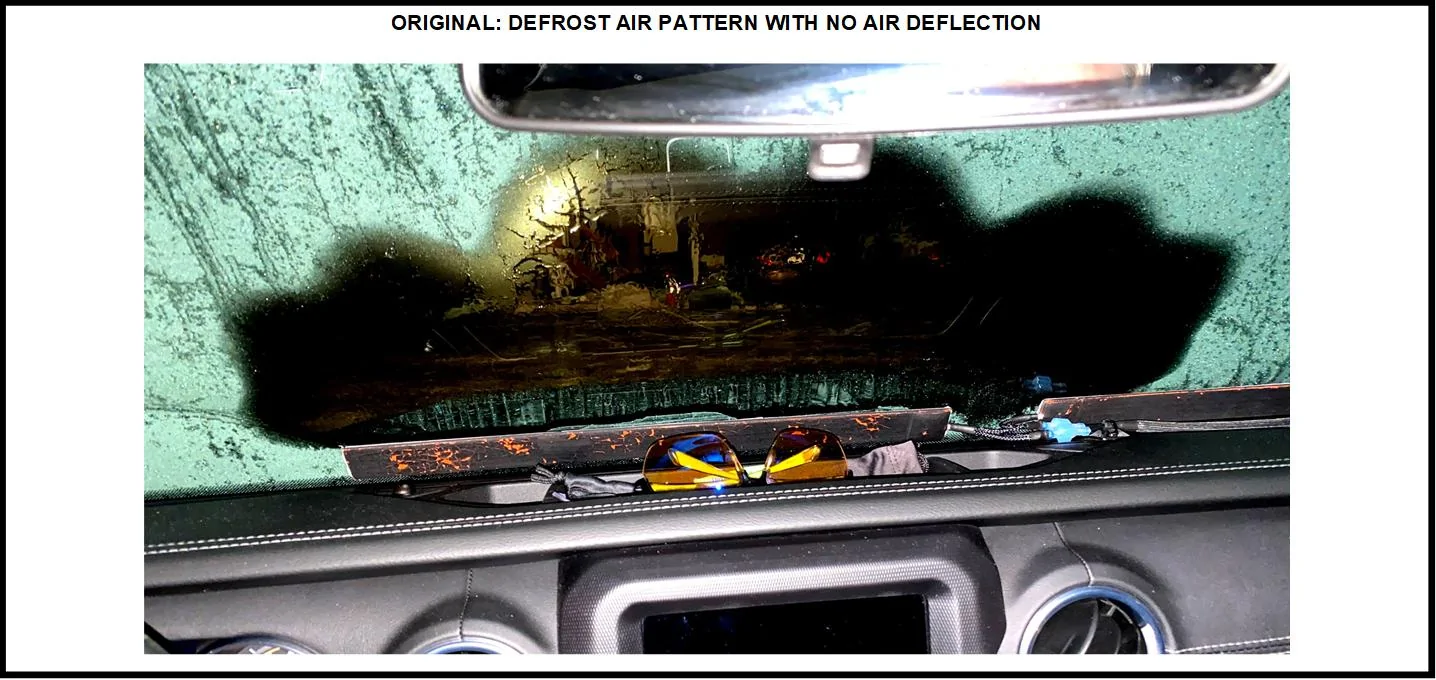

I'm getting closer to a final defrost modification setup. You'll see in the photos that I my last task is to shape the air flow a bit more on the passenger side but overall a huge improvement over oem. Once it's finalized I'll paint it black and make two more sets for my wife's and sister's JL.
I used 1/16" x 3/4" aluminum and used a metal punch to place the holes.

When I use the windshield defrost, I get warm air coming out of the green area but no airflow at all from the red area. (Of course this picture omits the passenger side of the dashboard but it's the same thing on that side.)
So does anyone have any updates on this? Has anyone had a dealer fix this or even recognize this as not functioning properly?
I'm going to include this problem with my clutch recall when I take it in. I've got the one Star case number (S1924000008) & the factory debris removal story from this thread but if anyone has any other information or successful resolutions of getting air to blow from all the holes, I would appreciate it.

In Jeep's opinion there is nothing to fix, works as designed. As owner's that is the issue, poor design.

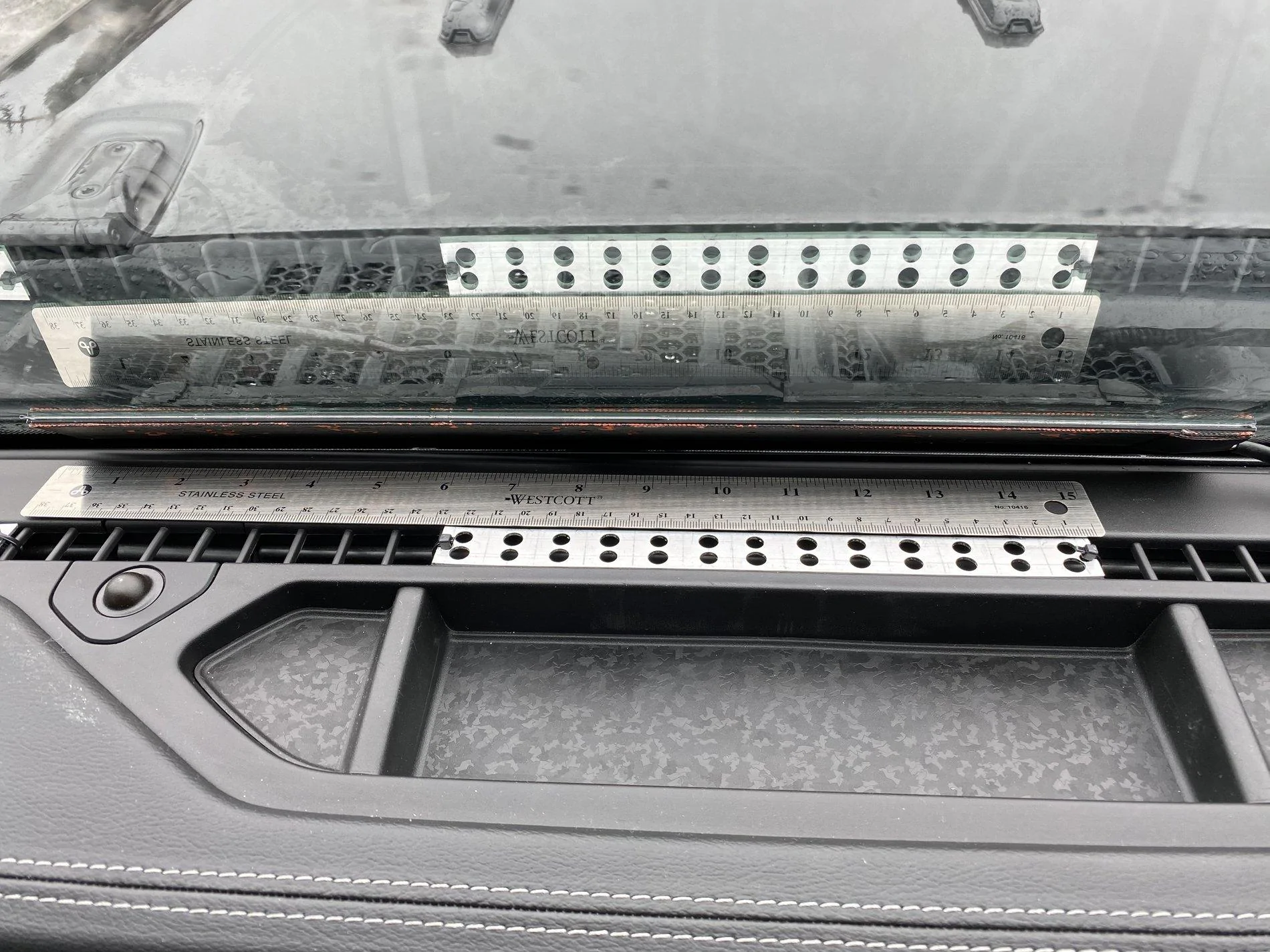

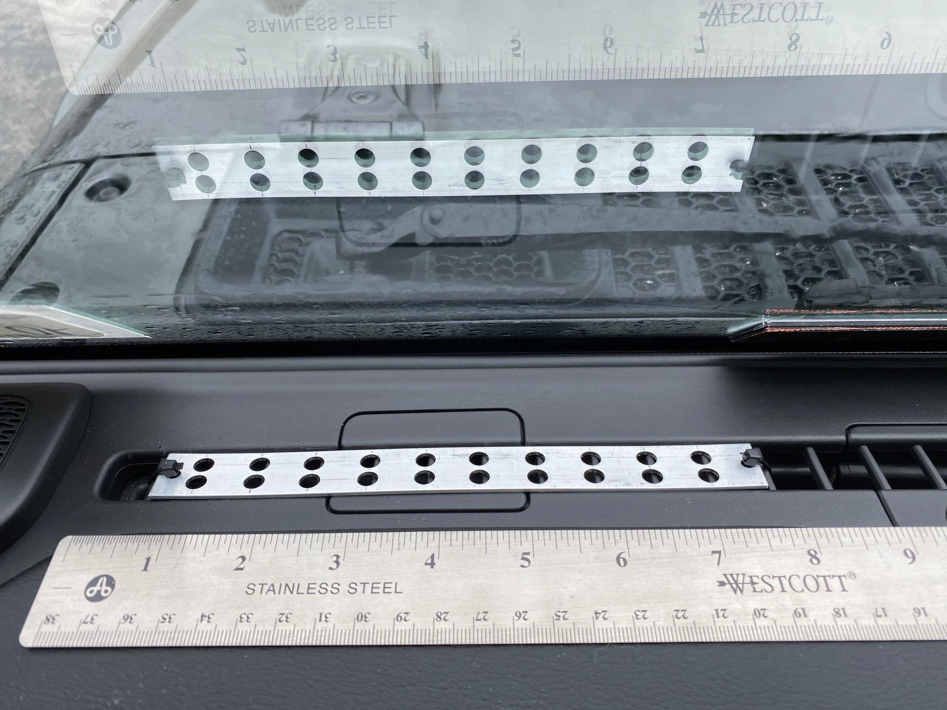

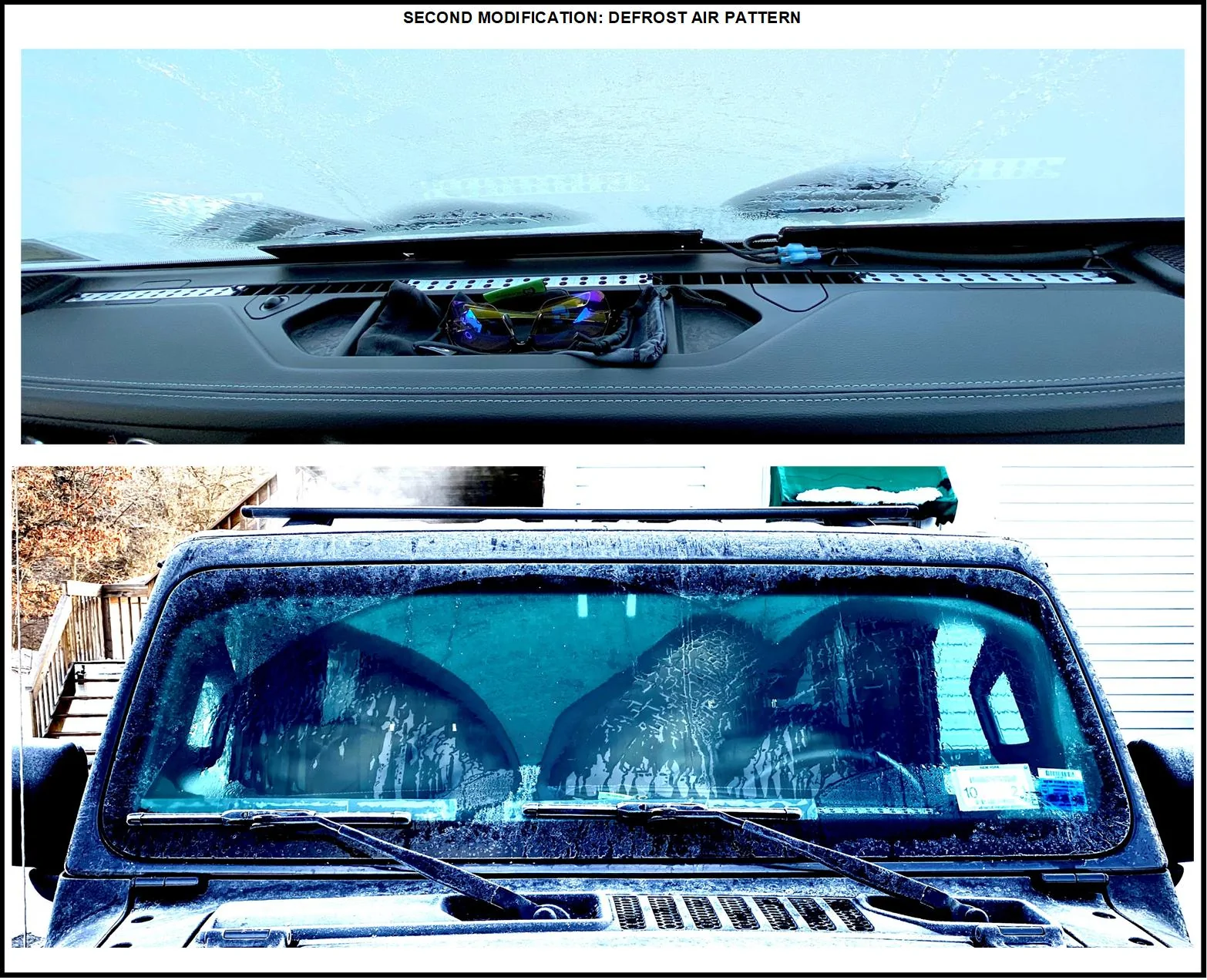

My final adjustments worked fine for me. The best fix would have been a shaped plenum under the defrost grid but that's for Jeep to do.

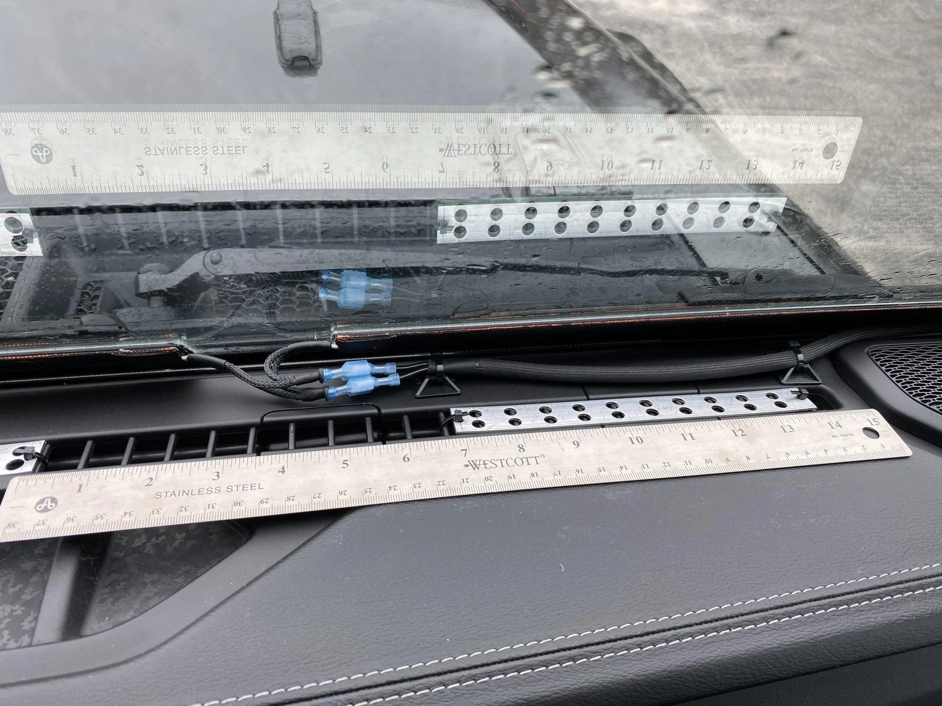

The pics should help you make a set from scratch. The aluminum is ~ $4 and the metal punch ~$30. Once you've used that punch a couple times you'll be happy you've got it for other projects.
