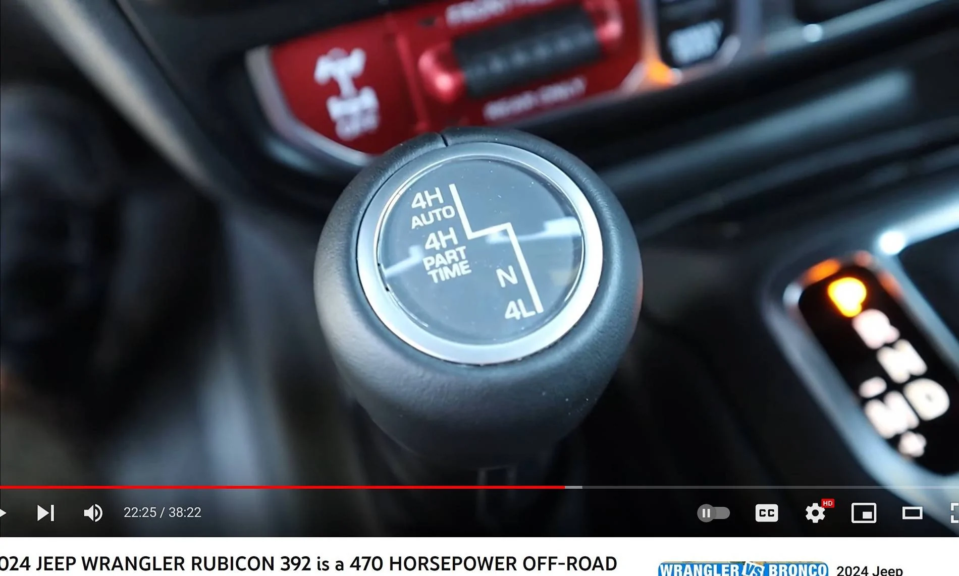

Sounds reasonable. Note that some Wranglers (e.g. 392s) don't do 2wd unless you use something like a Tazer.
Well, from what I've read, the 4H-AUTO setting in the 392 is indeed 2H on dry roads with the added feature that the front axle is constantly monitored for road traction loss and, if loss is encountered, it automatically goes into 4H. When traction is regained, it switches back to 2H. The driver no longer has to mentally evaluate changing road conditions for this, a convenience for all and a boon to guys whose wives only occasionally drive the vehicle in bad weather and may not think to watch for this. From what I read, this constant monitoring of the front axle has its cost in lowering the MPG to an extent, more than if the vehicle had the true 2H setting.
