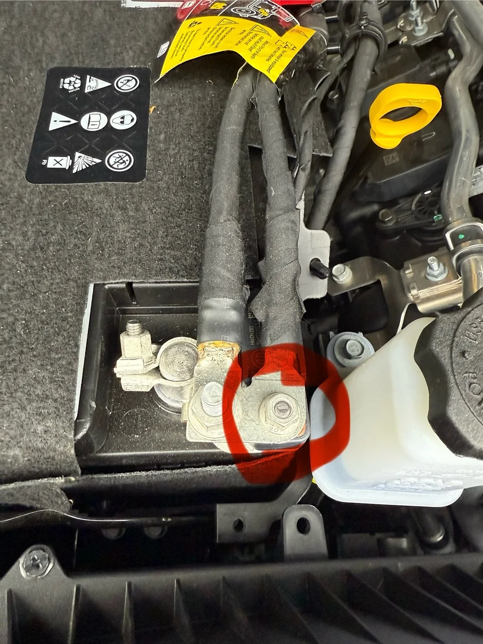

2022 Jeep JL unlimited. the aux battery is dying and after reading I don't think I need it.
I removed fuse 42 and the cable on the 13mm nut.
Jeep no longer had power.. Hooked it back up and it it works fine and has power. (I remove the one shown in all the video's posts from others *the one with the taller threaded stud on it. (nearest to sidewall)
Are there certain years the aux battery delete method does not work? (no it's not an etorque it's the v6.)

I don’t remember the date but the cable locations changed places on the main battery connection. I have a 2020 and mine had different size negative wires. I had to remove the narrower of the 2 cables and its location was closest to the passenger side. Have you tried disconnecting the other cable?

I did not. the first runthrough upset the cluster/ac and controls and I stopped there.
I can try that tomorrow
was worried after everything electronic acted odd post powercycle
**I now know after reading this forum that's normal and it should "remap" all the devices within a day or two **I hope :)
But I found no other post saying it was the other cable.
I will try that tomorrow and report back **I'll see if I can trace the ground to the frame/aux box to confirm before I unplug it again

Yes, the pictures in this link are correct. This is what I did with my 2021 and my 2025. It's annoying that the extra stud is attached to the aux negative cable so you can't use it to make additional connections if you do the aux delete.
When I did this on both of mine I didn't notice any weird electrical issues on the first start up, at least nothing that doesn't occur when you disconnect and reconnect the battery.

so.
I removed the correct negative this time.
And 2 things happened.
The AUX Battery was isolated.
And the car did not start.
The car did not start because after 2mins of being unplugged from the charger the main battery was at 10 volts.
Surprisingly, the AUX was at 12.4v at this point.
I guess I'm buying a new main battery, I was not expecting the AUX to be good lol.
Thanks everyone for the help :)

Hi @Blu3fan:
A couple of thoughts here.
* While, if one of the two batteries is to die it will most likely been the Aux battery first, it can of course be the main. Regardless of which it is, connecting a new battery up with the old working one is a bad idea. I suggest that you either bypass the Aux battery or replace both the Aux and main.
