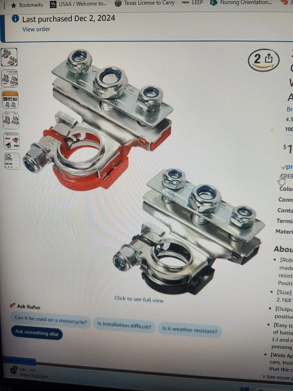

I have a 2021 with added stuff. I bought a new negative post so I could hook up my stuff.
Jeep Wrangler JL Question about aux battery delete 20251026_093530
