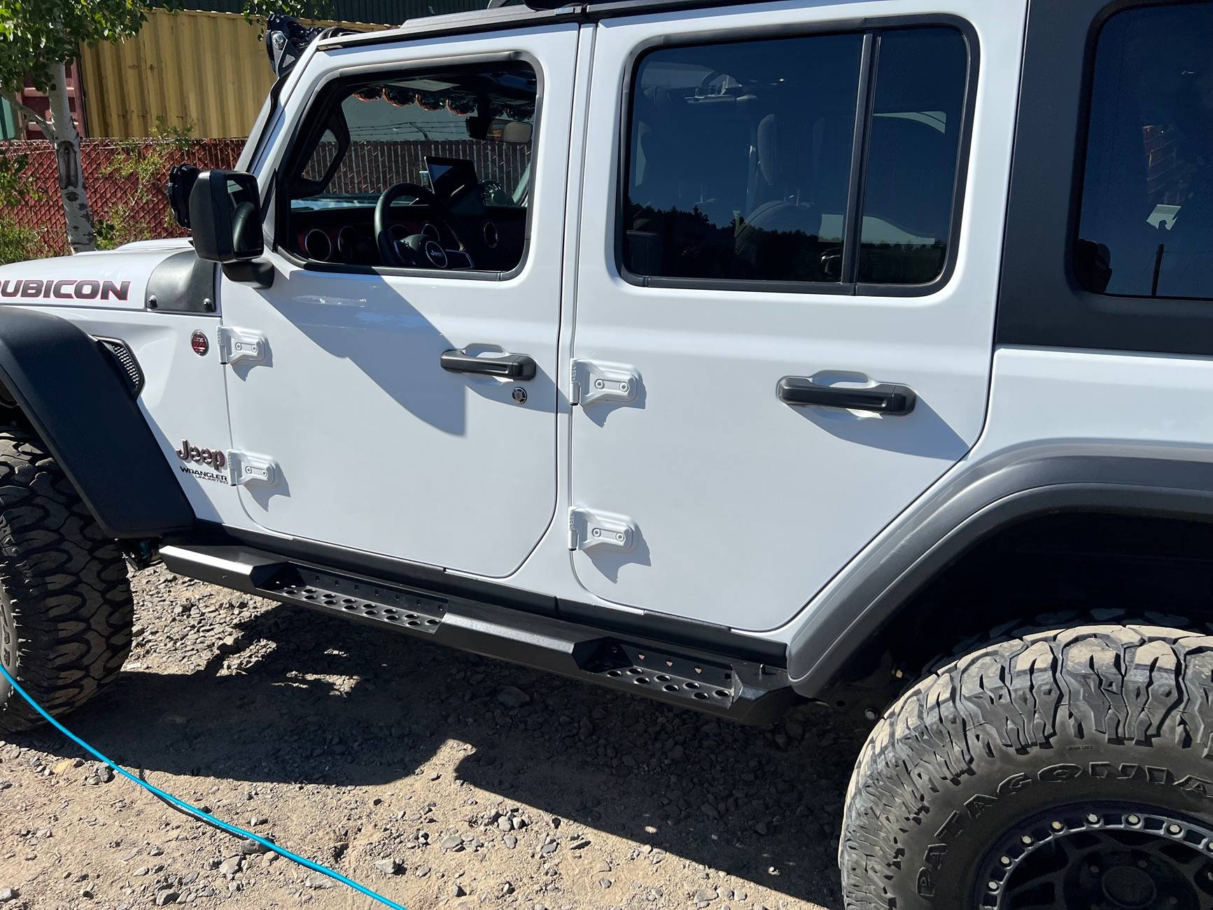

I was in Moab in April for the first time with my new Dirty Life bead locks and that's when I came to appreciate bead lock.
I think that most people who go off road can benefit from bead locks.
We where exploring and came across cobble stone rocky road and was only going to investigate the trail..
After a few slow miles of getting beat up I decided to air down from 28psi to 10psi. What a difference in the ride.
I can now travel farther faster smother.

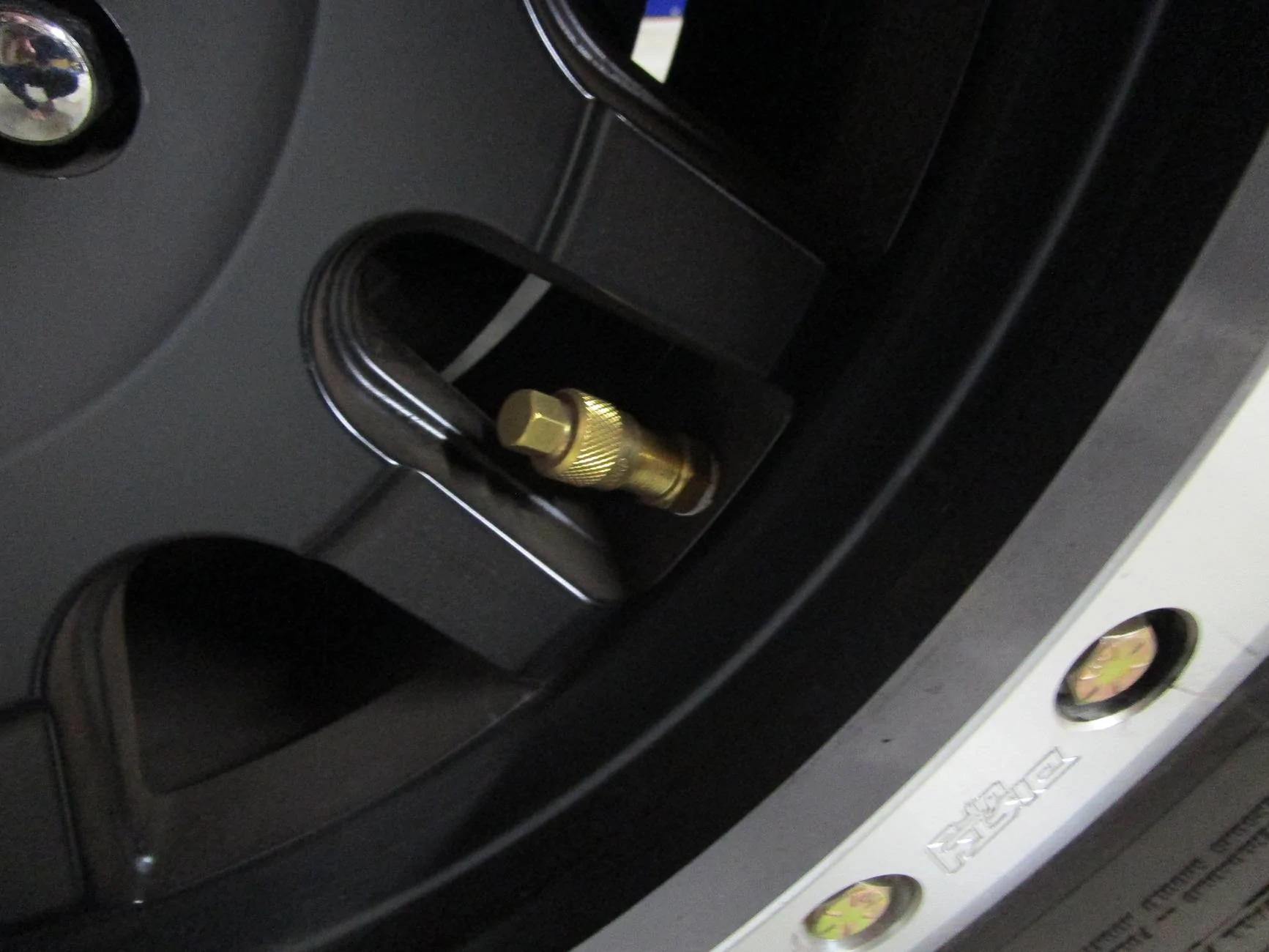

Before leaving for Moab I made some changes to my air up system.
First was installing H-47 large bore tank valves in my new wheels. These are a large valve used on large tracker wheels.
https://yourtireshopsupply.com/product/694/large-bore-tank-valve-hah47
https://www.amazon.com/gp/product/B093KHZF9D/ref=ppx_yo_dt_b_search_asin_title?ie=UTF8&psc=1
Second installed an onboard ARB twin compressor and running 3/8 air hose to both sides of the jeep with quick couplers and covers.
To get air volume from the pump I tossed the little 1/8 hose coming off the compressor and had a 1/2 hose made running to a manifold.
I can now air down from 28psi to 10 psi in 30 seconds per wheel with out removing schrader valve and air up two tires at the same time from 10psi to 28psi in 2 minutes.
It is now a short and easy process.
I also keep a small torque wrench with a socket in the jeep so I can check ring bolts at any time.
https://www.amazon.com/gp/product/B0C8MVHQ47/ref=ppx_yo_dt_b_search_asin_title?ie=UTF8&psc=1

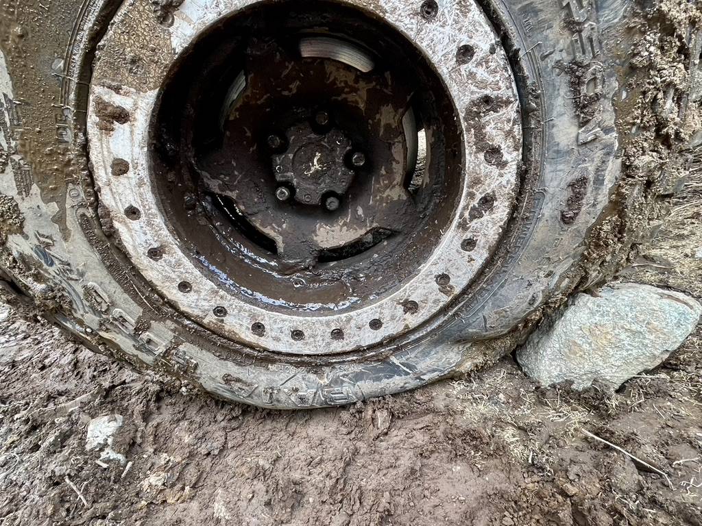

I could not make this climb in Disney Ok at 12 psi. I made several attempts. I aired down to 7psi and made the climb. I was the only one on bead locks and the rest of the Jeeps you see in the video were not able to make the climb.
This is what a bead lock wheel with a 37 looks like with all the weigh loaded on to a tire with 6 psi looks like. If you are wheeling like this, you may need bead locks. A standard wheel, you would most likely pop the tire off the bead.

can't remember if i've seen you mention it before, but do you run TPMS with those valve stems?

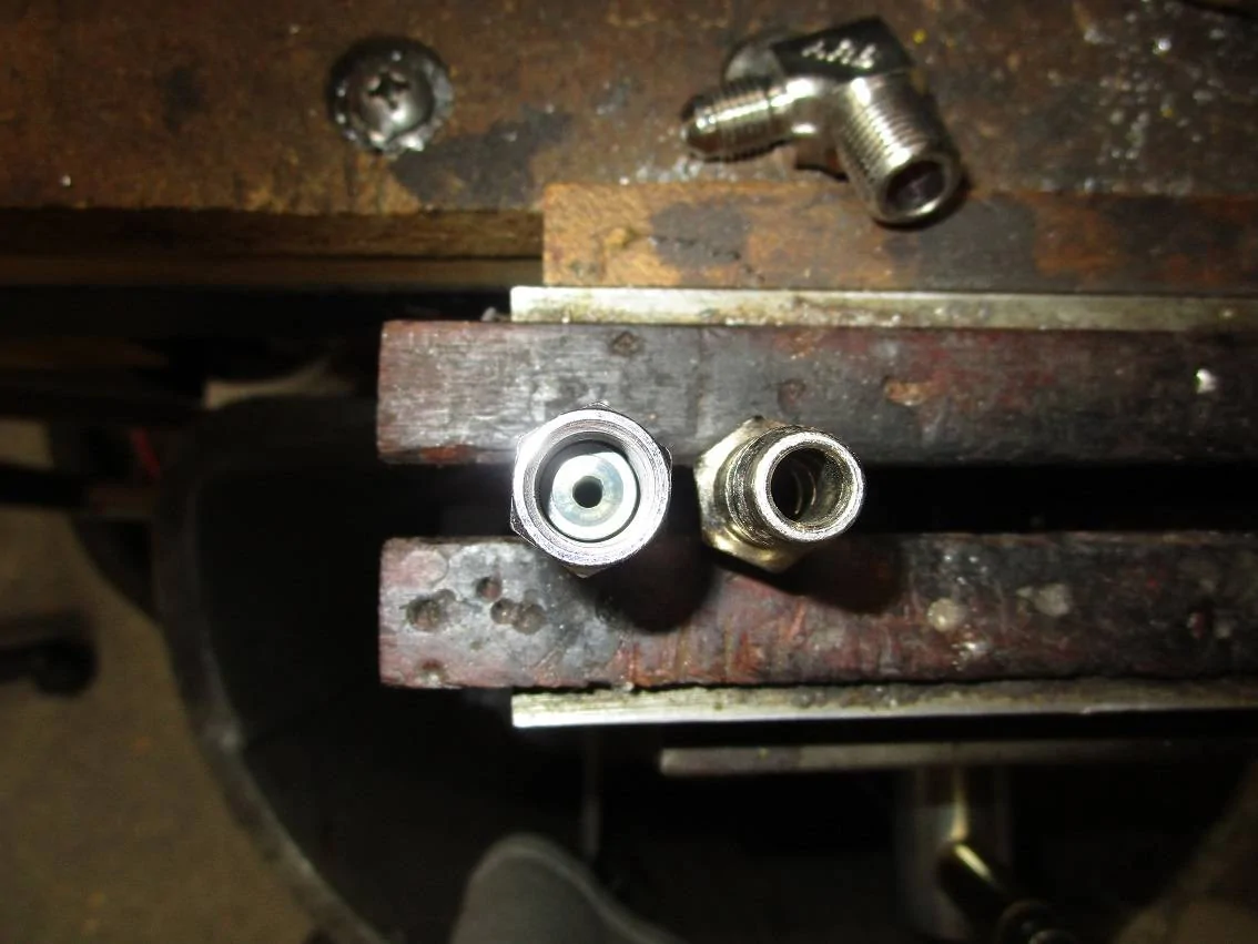

They are an added valve stem.
I drilled and taped a 1/4 pipe thread in the wheels and installed them.
The biggest benefit is they allow very high volume of air in and out and they only cost about $7
The second benefit is I can have a gauge on the standard valve stem wile filling with the large bore valve stem.
It makes for a fast air down and fast are up.

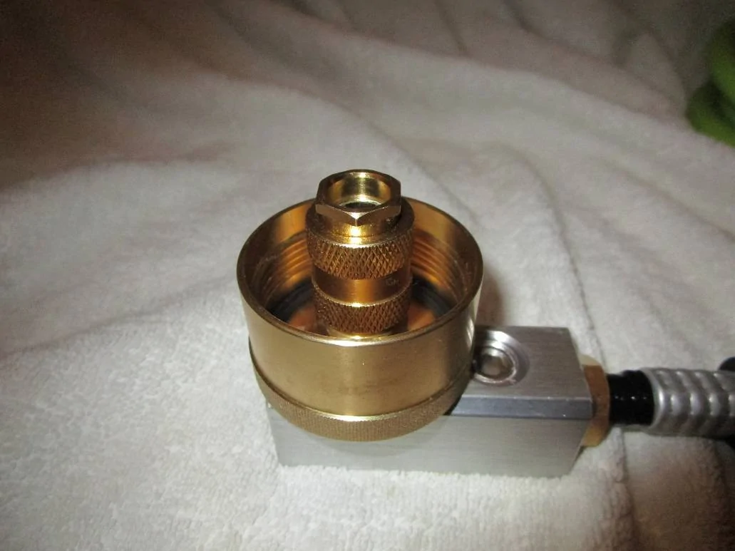

Like I said the biggest improvement you can make to any system is eliminate any small hoses like what comes with the ARB compresses.
The fitting / hose on the left is the one that comes off the ARB compresses that I replaced with a 1/2 hose.
The fitting on the right is a jaco high volume coupler fitting.
https://www.amazon.com/gp/product/B09GW4J3P3/ref=ppx_yo_dt_b_search_asin_title?ie=UTF8&psc=1

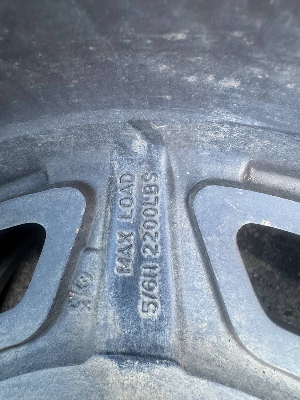

While working on the Jeep yesterday, I noticed this on my ATX Slab bead lock wheel.

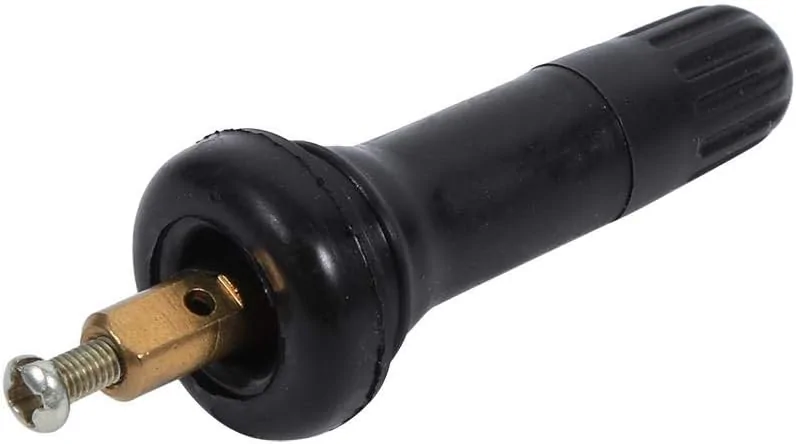

yeah, thanks; but the question was: "do you run TPMS with those valve stems?"
I have the factory TPMS in the rubber valve stems.
No TPMS in the large bore valve stems. They will not fit. And if you adapted them to fit it would greatly reduce air volume passing though the valve.
You can see in picture the small hole in the factory rubber valve stem that greatly reduces air volume.
