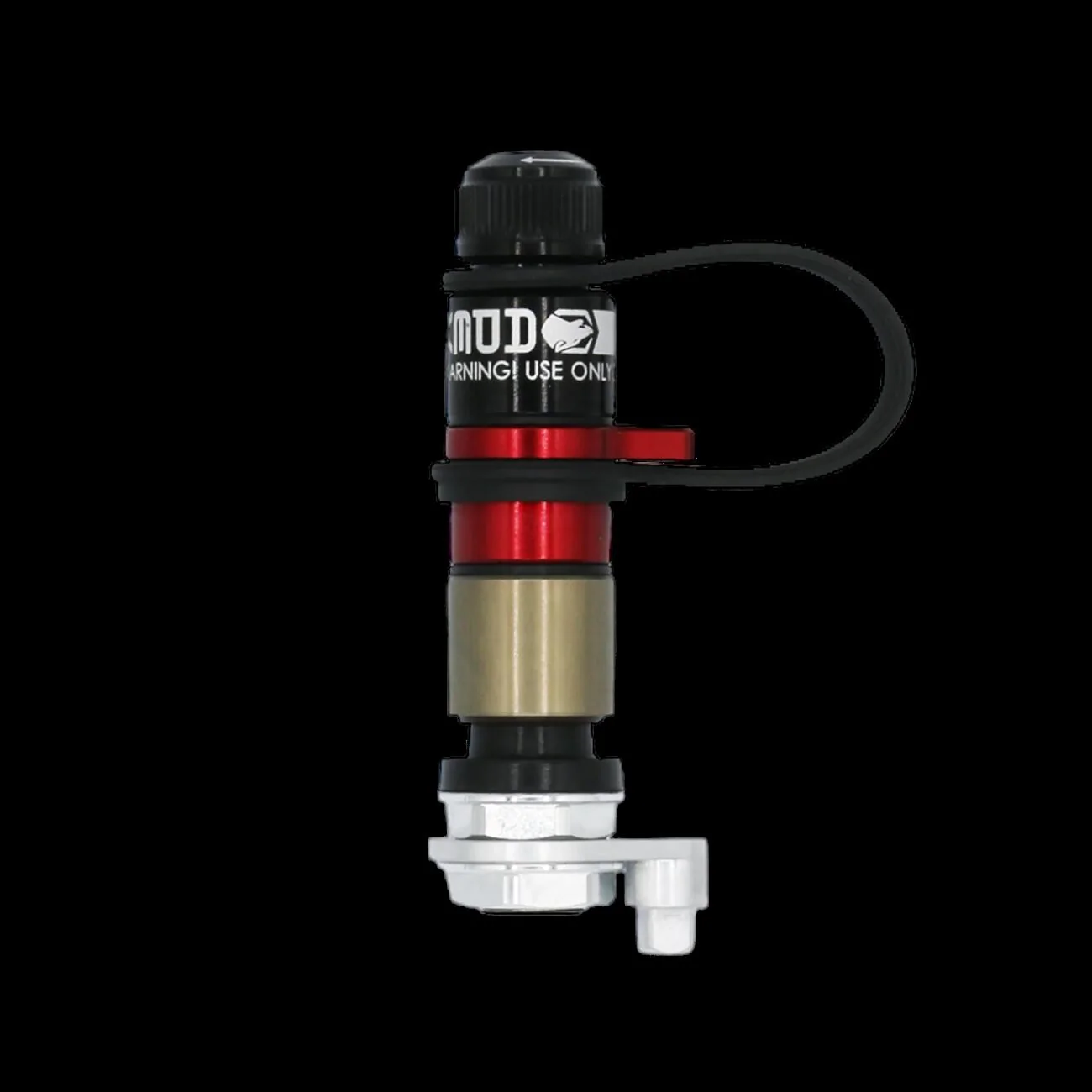

I use the Apex Design Rapid deflate valve stems. They drop air crazy fast. Like form 30 PSI to 10 PSI in or about 10 seconds. They have a bracket that set the TPMS sensor off to the side.
Look here.
https://www.apexdesignsusa.com/collections/inflation-deflation-products
I love these valve stems.
https://www.apexdesignsusa.com/products/rapid-precision-valve-xl

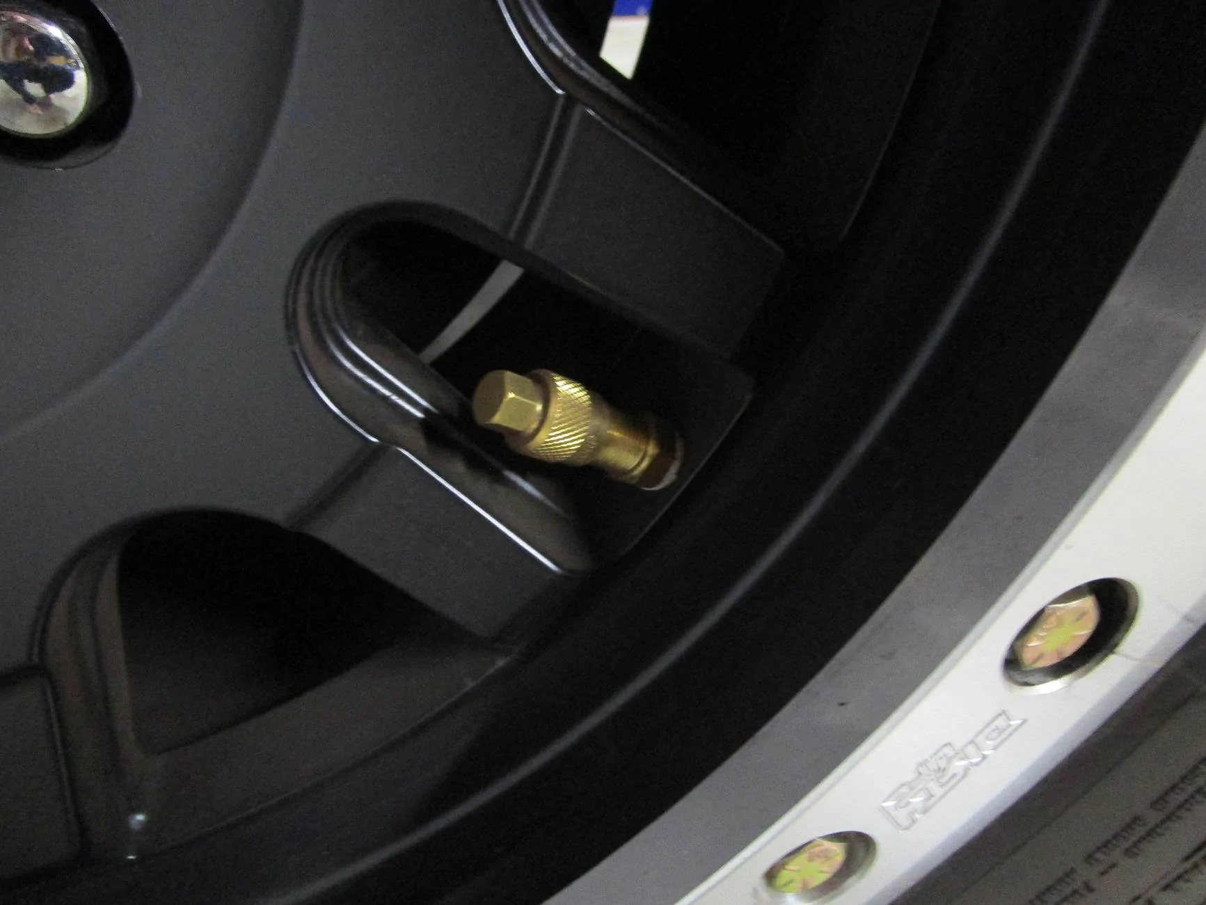

I was considering Apex put I wanted a valve tucked in as far in as possible.
In my opinion the Apex in my location on my wheels would be at risk of damage.
Jeep Wrangler JL PSI & Beadlocks IMG_1986
I agree. But I also stay away from metal valve stems as they are stiffer than rubber stems and more likely to break with a slight rock scrape.

Since you run balance beads, what type did you buy and what valve core are you running in these? I like the idea of these valves but am also leaning towards trying beads for my new tires this time. My compressor runs hot and not at full capacity because of normal valve core restrictions even doing all 4 tires at once so their inflate ability looks intriguing too.

I ordered my balancing beads off Amazon. Each bag of all the balancing beads that I have bought over the years come with valve stem core to keep the beads out of the valve stem. The big thing is the TPMS sets off to the side and not on the valve stem. So airing up or down, the air is not going through the TPMS.
