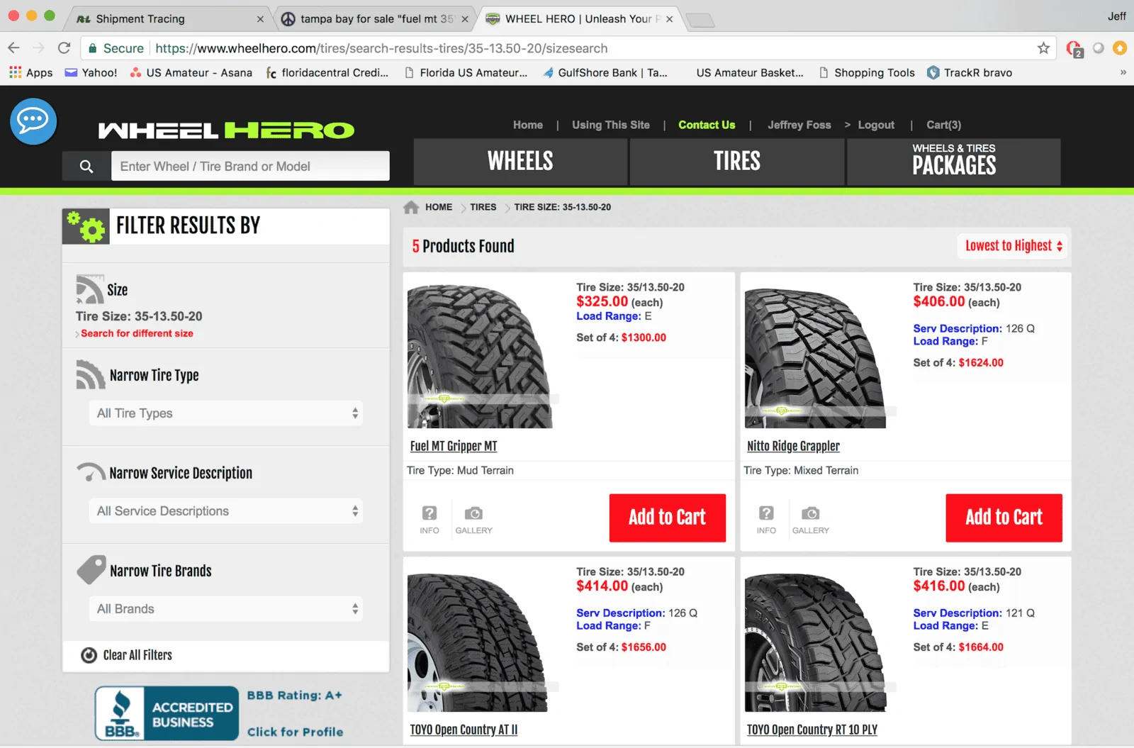

Yes... story is even worse than I originally posted.
So I ordered these on wheelhero.com and they had 2 tires in this size that were "E" rated (nothing lower at this size). I chose the Fuel tires because it saved me $500 and they were telling me how great they were. Plus they were MT's which is what I wanted.
So turns out when I got them they were F rated... I didn't realize this until I had them on and was concerned about the shaky ride.
I contacted wheelhero.com and they are telling me D, E, F, all ride the same... and are clearly not wanting to correct anything even though they were posted incorrectly on their site. Thing they don't realize yet is I have a really good lawyer... like better than you guys are imagining right now... that will go after these guys for the fun of it.
Now... on the other side, I've driven these things for a day now... and they really are riding good at 35psi with the new balance... so kind of questioning what my next move will be.
Here's a screenshot of their website... they've changed it since I notified them of the error.
