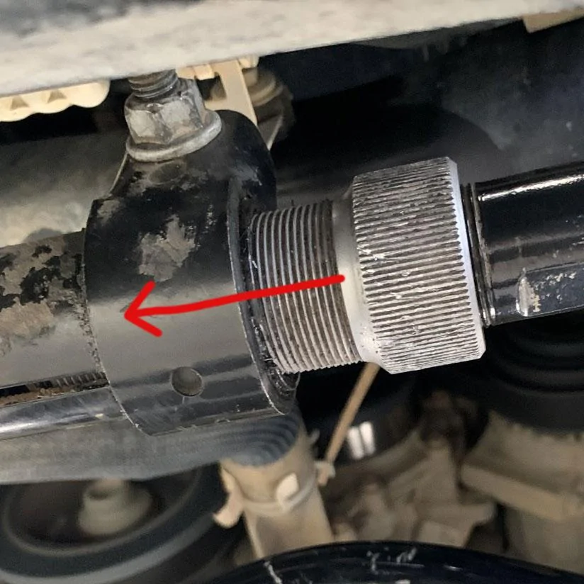

Shortening OAL will pull the wheel right.
Lengthening OAL will push the wheel left.
If you truly can't turn it anymore I agree: disassemble completely and "split the difference" with the sleeve. It'll become clear once you have it apart.

Factory drag link doesn't have adjustment on that side, it's fixed.
Actually CT -- you can drop the drag link at the passenger knuckle instead and then turn the whole thing to get it fully threaded in at the adjuster. That side is a lot easier to get off typically.

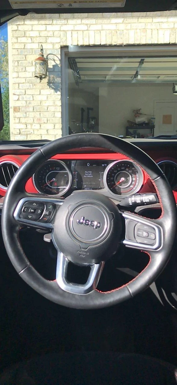

Thanks for all the help. I’ve got it now. It may just a few degrees off, but very close and I’ll be able to fine tune it to get it dead center if I want to. Any trick to get it 100% perfectly centered without the help of a second person? Other than trial and error.
The adjusting collar seemed to be stuck for some reason. Mud or dirt maybe? It was so stuck that turning it any more seemed like I might damage it. I cleaned up the threads and lubricated it and it’s silky smooth now. Thanks again everyone for the help.
