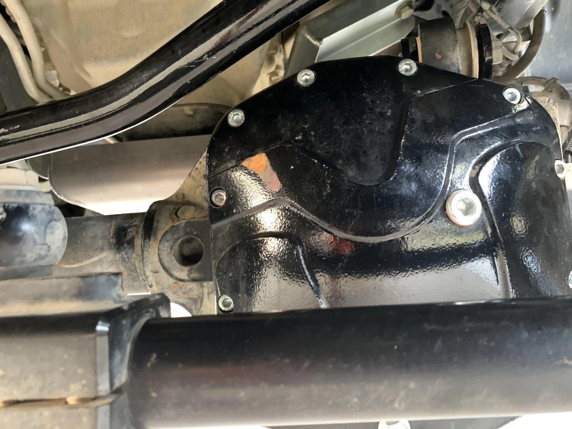

I didn’t have adjustable control arms when I installed these parts, I do now. But in retrospect it seems obvious that I could have adjusted the SteerSmarts track bar to not make contact with the diff cover. The SteerSmarts is a 3 piece unit with 2 adjustment points, if I’d have removed it and adjusted it so the bend was moved about an inch to the passenger side everything would have been just fine.
My buddy suggested the same thing, when I had interference between my Yeti bar and arb diff cover. But with the axle centered, only the adjustment sleeve could be oriented back and forth, whereas the bend stays put. The axle would have to be offset to the drivers side to clear the diff.
Not at all trying to nitpick, just don't want you thinking that you could've avoided the 2nd track bar.
Glad to hear of your lift project getting done and in the record books. How bout some pics of the beast?
Yep, you’re right about not being able to shift the bend side to side. Where the bend made contact is toward the passenger side, the axle would need to be shifted further that way for it to clear.
