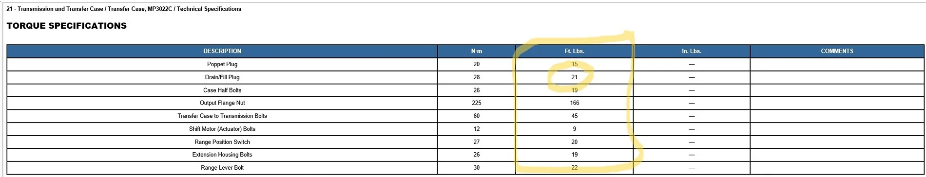

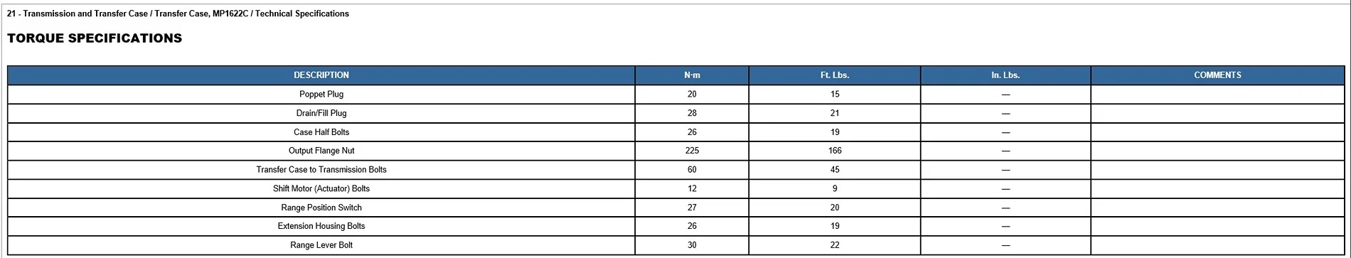

A few thoughts...
The torque value
This is from my Tech Authority Service Manual for my 2018.
When you add pipe thread sealant, the torque value gets adjusted 15% to 25%. It looks like the service manual says 21, but that end value after the dope is maybe 18 to 19 ft/lbs.
Not a huge difference, don't know if it really matters that much. I'd think 18 may be better to prevent stripping if you're using pipe thread sealant.

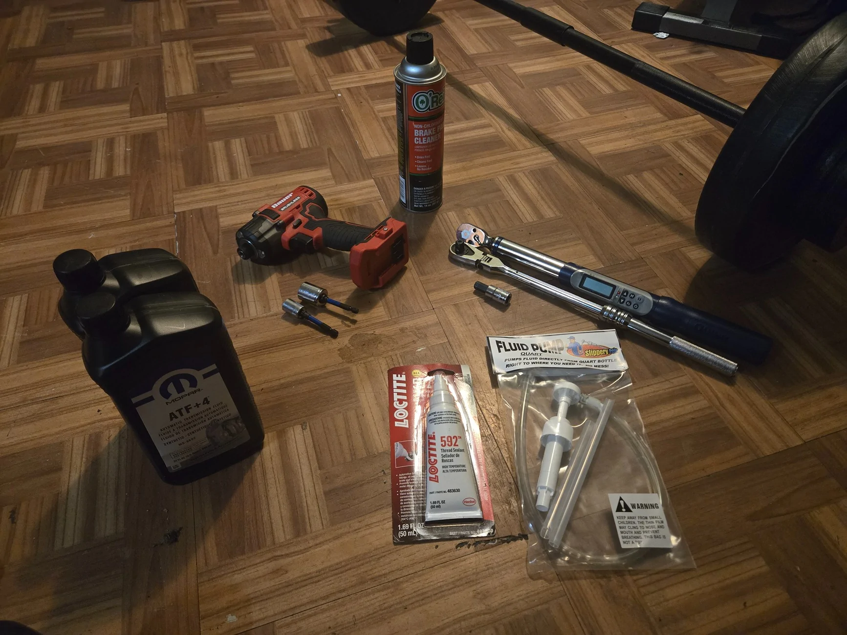

Everything looks good. 13 mm and 18 mm sockets for the skid plate, 10 mm Hex for TC drain and fill plugs, sealant, quart bottle pump, torque wrench, ratchet, and brake parts cleaner to clean the plugs.
I learned my lesson, don't open things with the torque wrench, torque wrench only for the last precise closing. And the impact gun only for opening the skid plate bolts, ratchet for closing them.
A few thoughts...
The torque value
Agree. Torque is greatly affected by lubrication.
In this case, it's a pipe thread. It's also in aluminum with a steel plug. In my experience, the biggest concern is galling the threads, where metal from one surface grabs the other surface, due to high friction, then is ripped away and sticks to the opposing surface. It can happen in many combinations of threaded, sliding, or rotating metals, where there is high friction. The next concern is over-torquing which can crack the female threaded part, due to the taper of a pipe thread. It likely will not happen on most parts until it's severely over-torqued.
