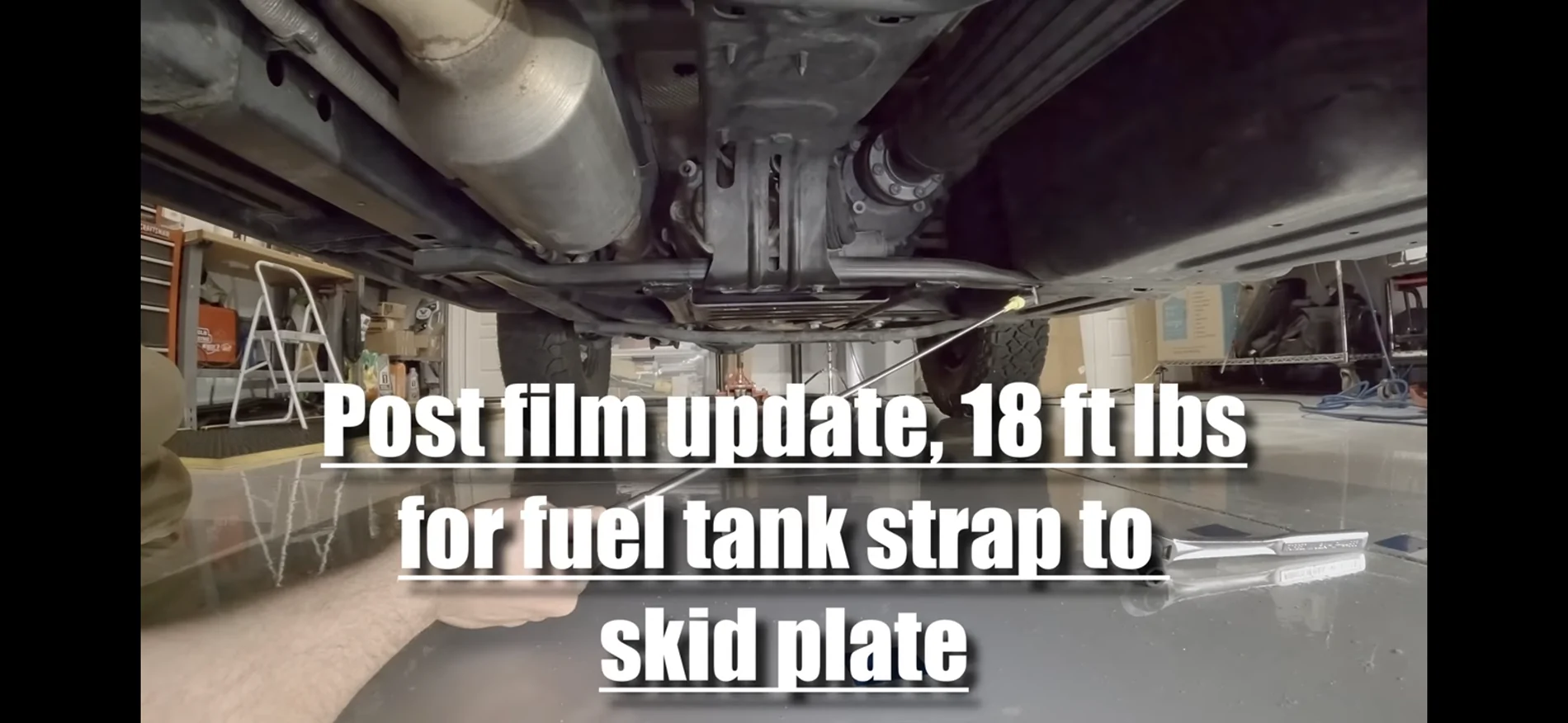

That thread sealant is a good idea but if I recall correctly there is one incorrect torque spec given. No way that bolt goes that high. It’s actually 18 ft lbs per Alldata iirc. I looked at that video when making my own and talked about this.

It was one of the bolts. I’ll go check and edit this post. I think he said it was 48 but my memory isn’t recalling off hand. These days I reference my own videos so I don’t have to remember😄.
Edit: It was said to be 48. Per Fastenal tables, the max any M8 bolt would go is 29 ft lbs with a 12.9 grade. I can’t recall if that bolt was 8.8 or 10.9 but either way it would not even approach 48.
Alldata leaves some to be desired having nomenclature with no visual location reference. I recorded and said 16 but added text during editing letting people know it’s 18 along with a screen shot and bold red underline of the correct spec.

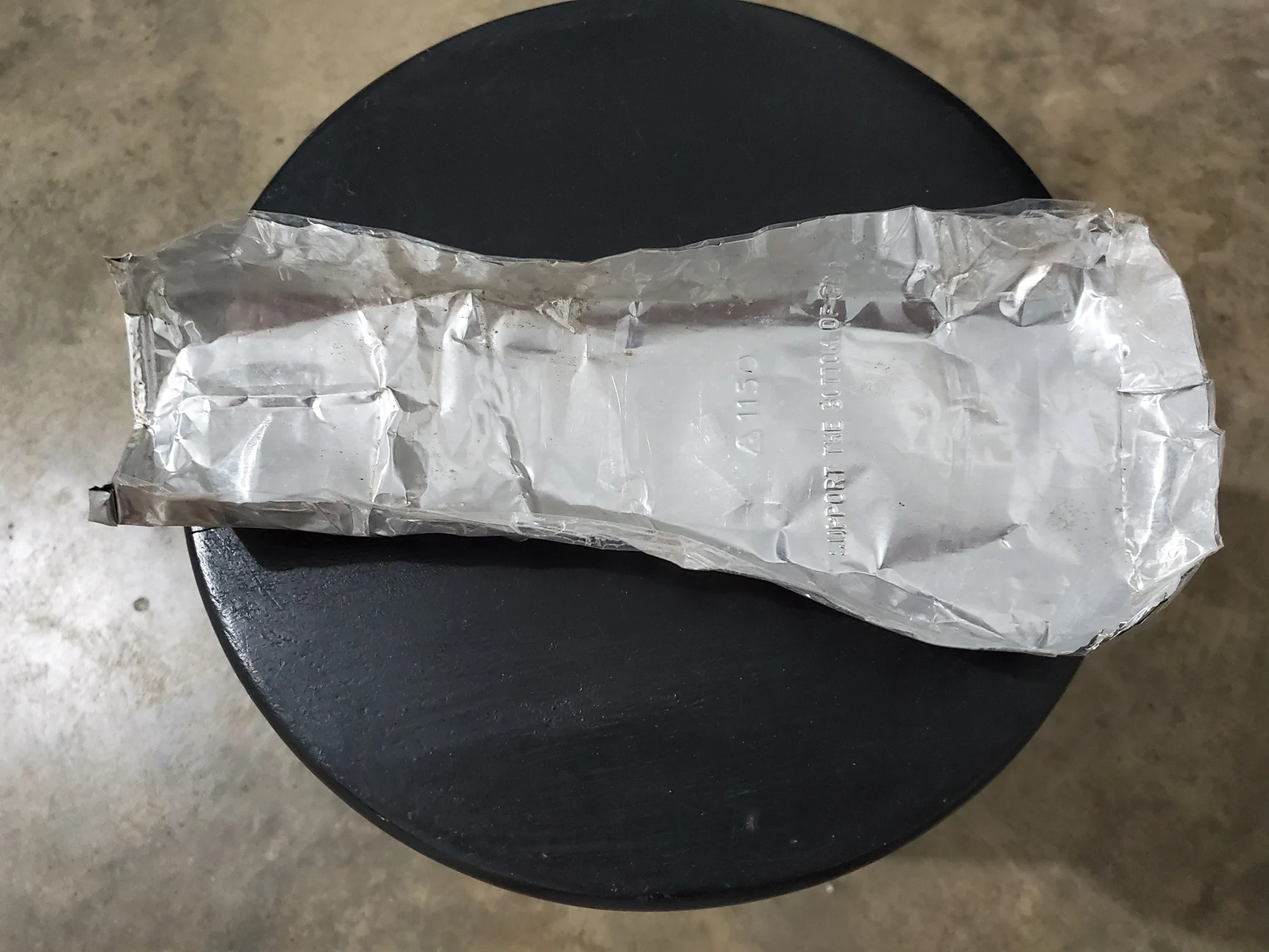

ALSO.... I encourage guys and gals not to remove the guard. Not necessary. Slows you down and you risk breaking one of the bolts that secures the guard. Just use a foil tray like pictured below when draining the transfer case. You can buy a foil pan at the Dollar Store and easy shape it.
By the way, using Yellow or Pink Teflon Tape is not just to prevent seeping but it also cuts down the chance that the drain plug will seize up and be a bear or impossible to remove the next time you want to remove.
