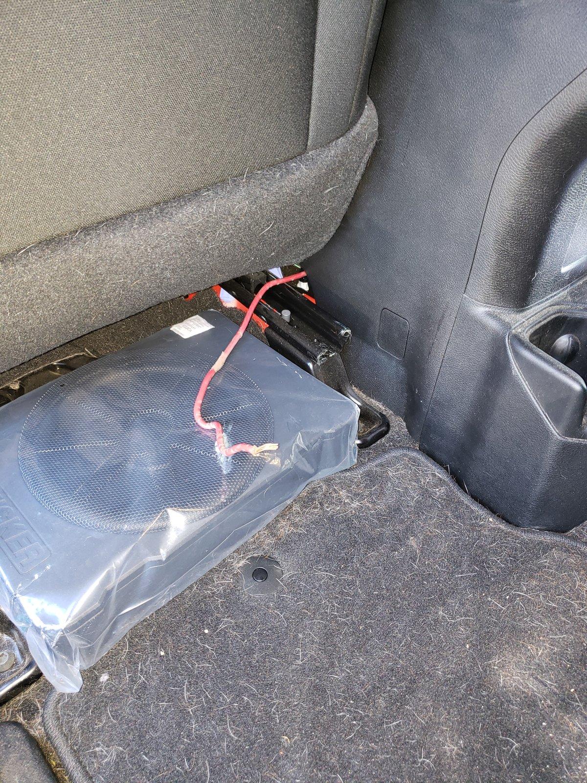

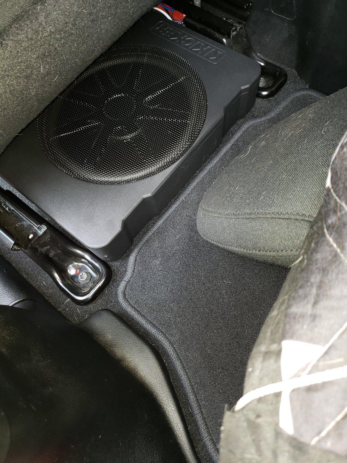

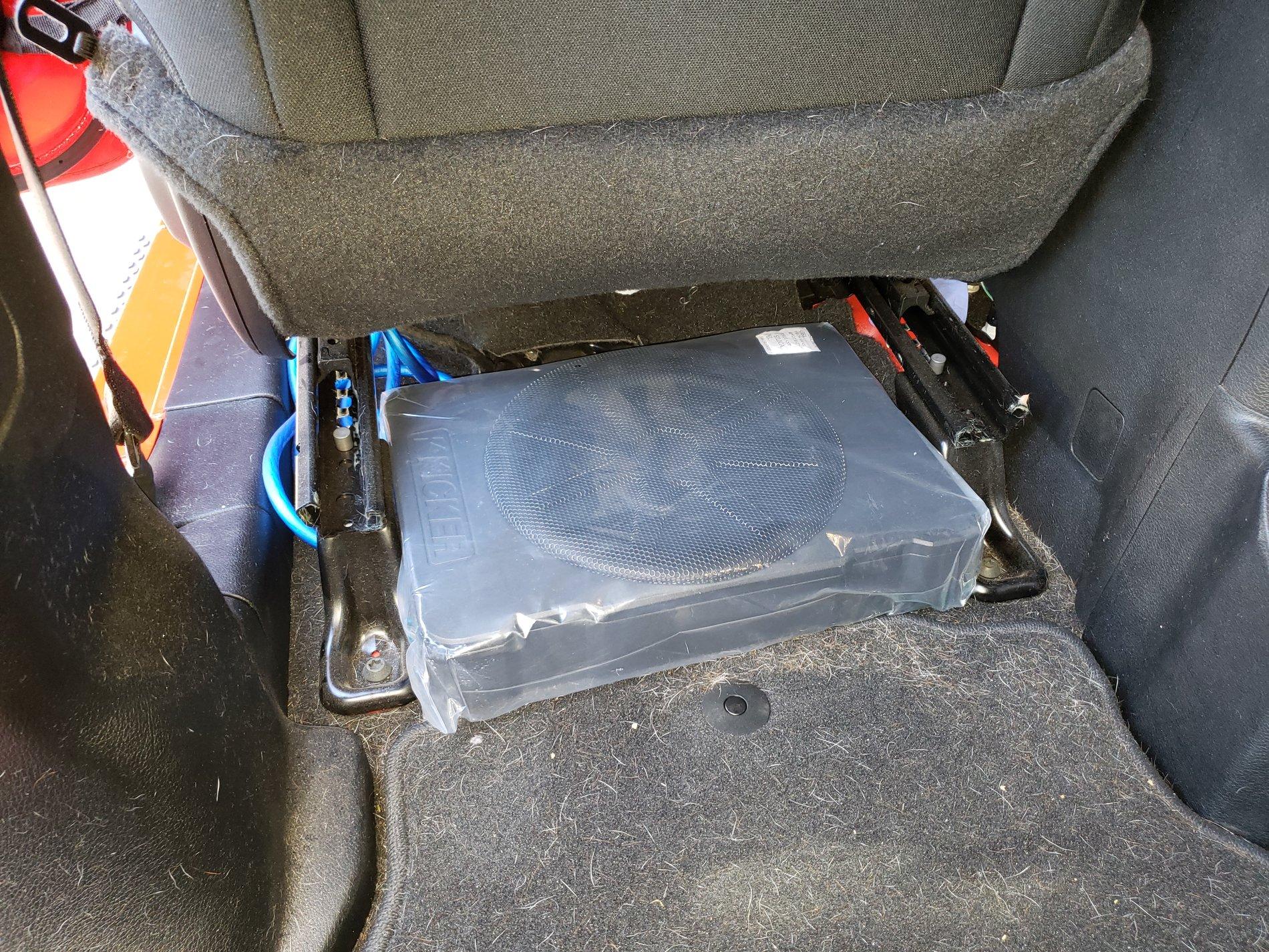

Just took a break and wanted to update. I had a brian fart, thought I should put the back seat down, after I ran the wires, DA! it was close!

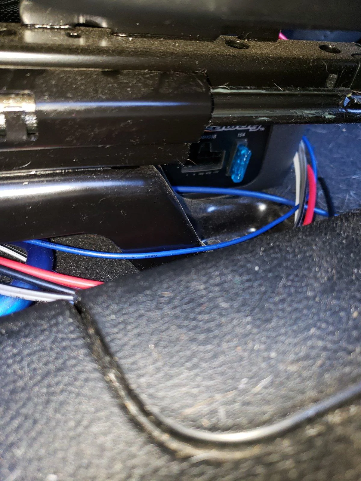

The JL has a lot less room, under the seat, then my JK had,the 10 sub is a real tight fit, with the JL.
I didn;t take into account the wire for the base ramote, on the first fit, because of this, the 10 inch base sticks out a little more, into the leg room of the back seat.
If you leave your back seats up and carry a lot of passengers, it might cause a problem.
I was thinking of, taking out the back seat vent, I don't know if that will give me more room under the drivers seat. I was beat up from the 97 degree heat, I just stopped, with a little slop,left to take care of
If you go with the 8 inch kicker, from what I read, it's longer 13 7/8 vs 10 inch 12 3/8.

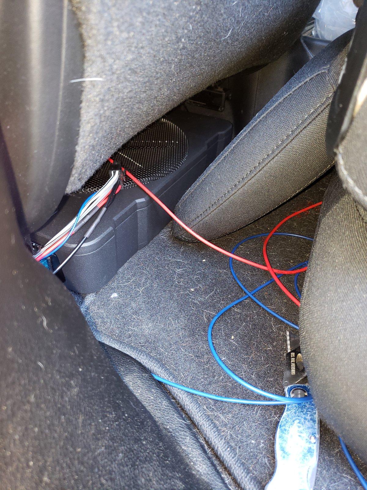

well guys I'm going to call this brian fart two. I really wanted to make it easy to adjust the sub amp, so that is one of the reasons I turned it that way in my pictures,the fit wasn't the best for the wires.
I pulled it out and turned it 180, no problem with the wires fitting now and there's foot room for the back seat.
