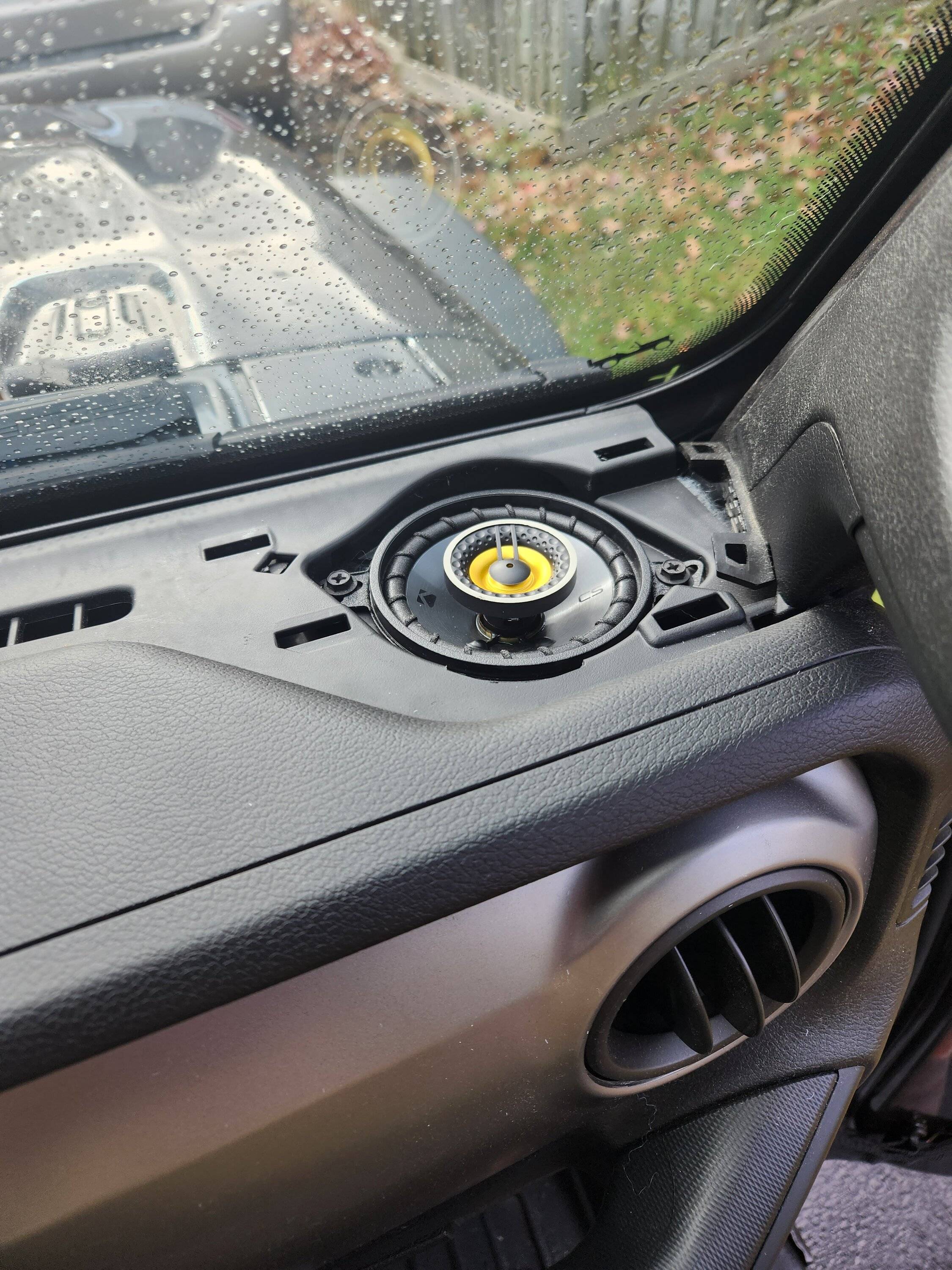

Just finished swapping out the factory Wrangler JL speakers for a Kicker speaker upgrade. No amp, just a quick and easy replacement of the OEM speakers to the factory head unit ...and they sound great.
Total time is 45-60 minutes (about 5-10 mins per speaker). I changed the 2 dash corner speakers and 4 soundbar speakers but left the knee speakers alone.
With the Metra cables this was 100% plug and play. I went with the 4 inch Kicker KS speakers for the soundbar since it comes with a mounting bracket that perfectly fits the Wrangler JL (and it's their premium speaker). Then, I used the 3.5 inch Kicker CS speakers for the corner dash and soundbar because they do not require crossovers and fit perfectly (note: the 3.5 inch KS model requires crossover wiring and is a pain, so that's the main reason I went with the CS 3.5 inch models).
Added poly-fil ($5 bag from Walmart) and had almost the entire bag left over. You probably only need 4 ounces of it.
These speakers sound great and are much louder and crisper than the stock speakers. They are punchy, but not a lot of low bass. Good mid bass sound with clarity. I turned the treble to -3 to reduce the bright sound. Added a pic of the equalizer setting that I thought sounded best.
Overall, if you want better sound without an expensive professional upgrade (amp, sub, etc.) then I recommend these for fit, ease of install, price, and sound.
They sell these on Amazon but I went with Crutchfield since they included the plug n' play Metra cables for free (need to talk with agent on chat or phone). Overall, $160 total price for everything. Great price for new upgraded sound.
The Crutchfield site (and other sites) say these speakers don't fit but they do! I think the dimensions might be off by like 1/18 of an inch or something and their system doesn't tag it as an "official fit". There are several YouTube videos of others installs as well as my pics here.
