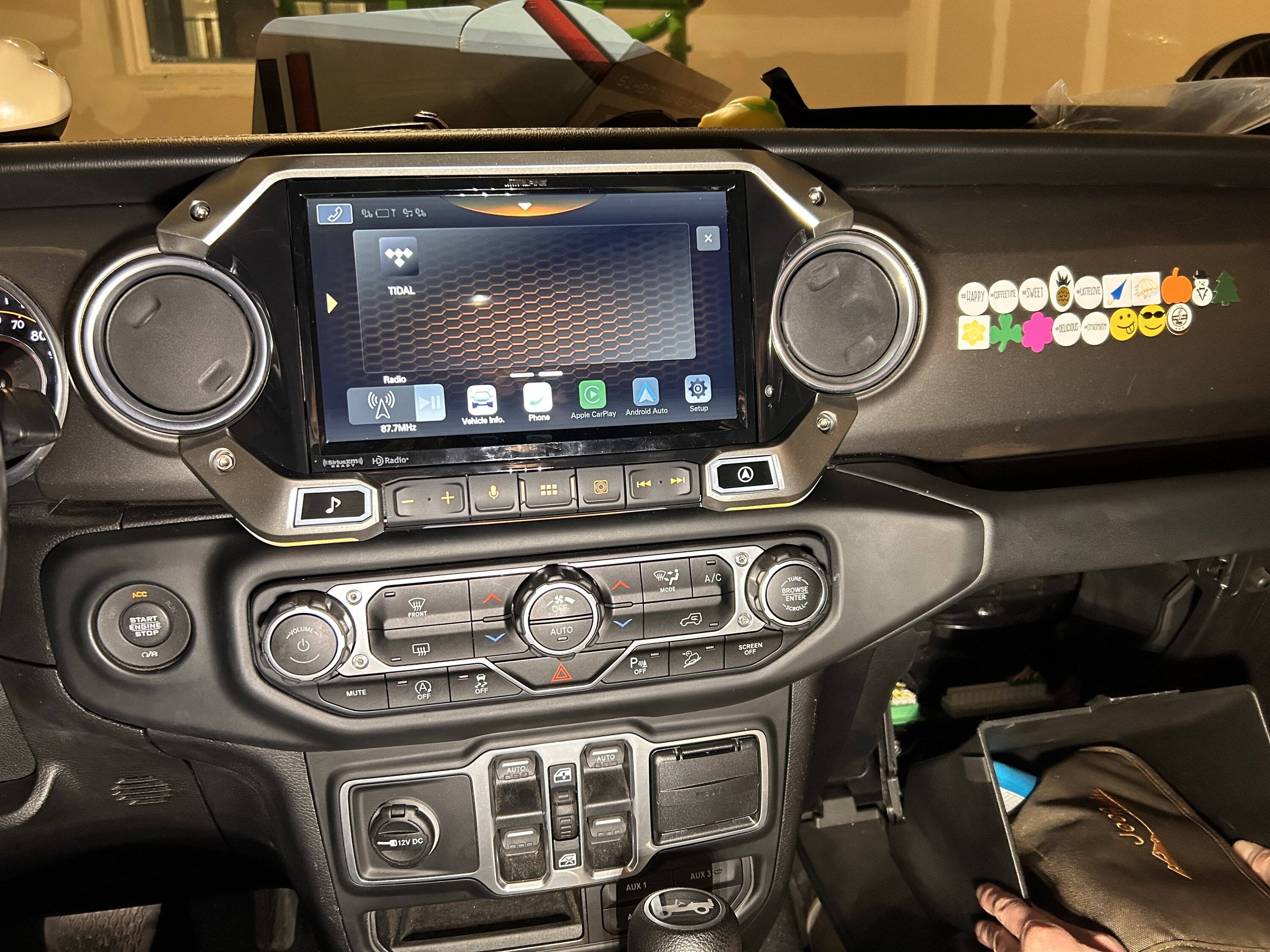

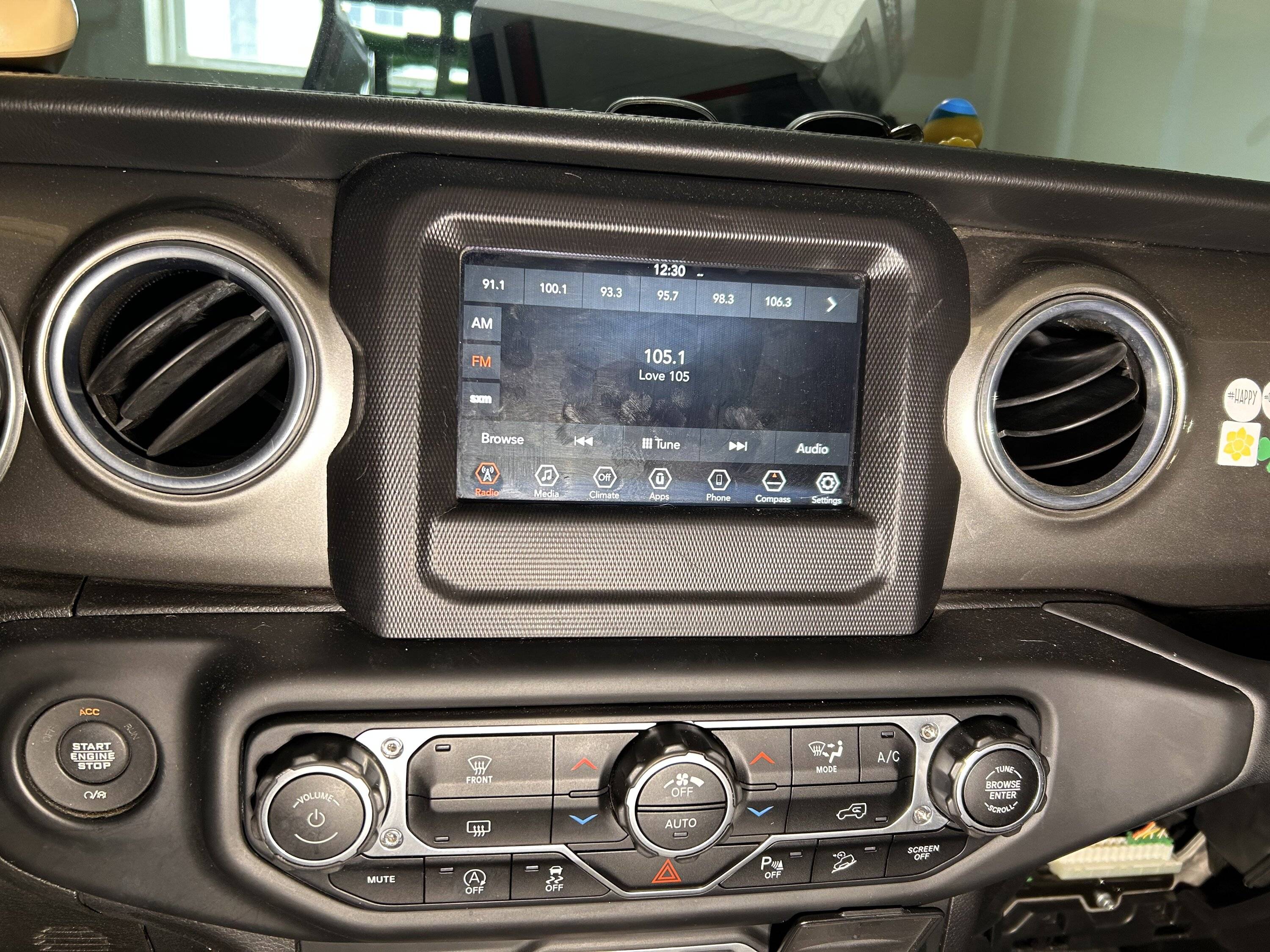

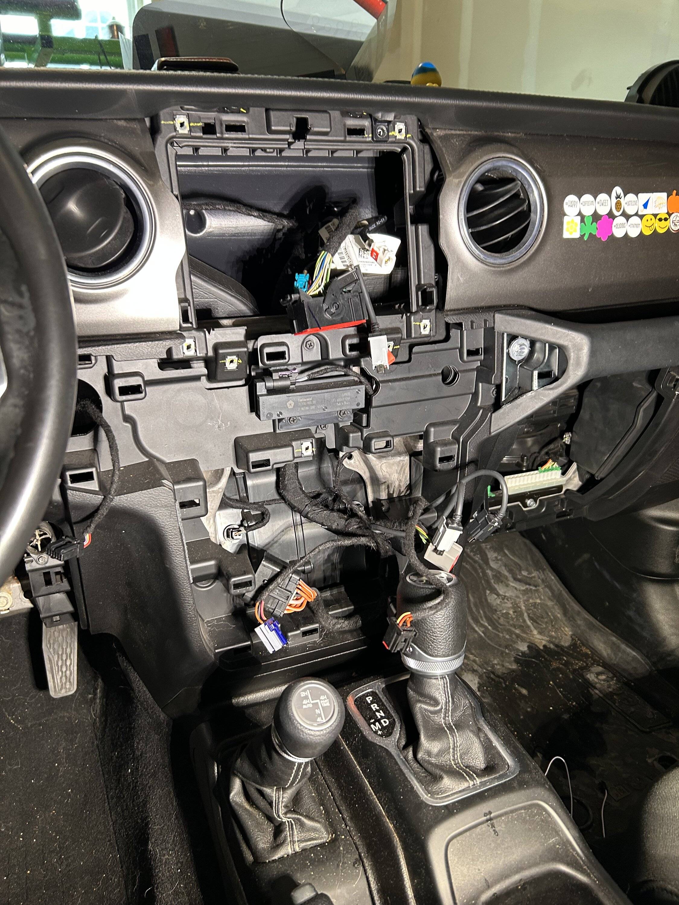

So it’s installed! Approximately 3.5 hours to install the head unit and screen. With the Kicker CS Plug and Play Bundle, it absolutely lives up to my high expectations. This is the basic system that every Jeep should come with from the factory. Gone is that crappy hard to use UConnect 7” screen. Retains full camera with backup lines (not that I use them), but they’re there. I got a deal on the front and rear DVR dashcams, but I didn’t put those in yet. I will probably have to make a bracket for the rear one as connecting to the glass in the back isn’t an option as I like to have the top off in the summer.
I look forward to riding in the summer and being able to actually hear lyrics coming from the stereo. Another plus, hasn’t overheated in the two days commutes, which it did everyday previously at about 40 minutes into my commute. If you install one though, make sure the front and rear speakers clips on the harness are connected properly. That’ll save you some time troubleshooting.

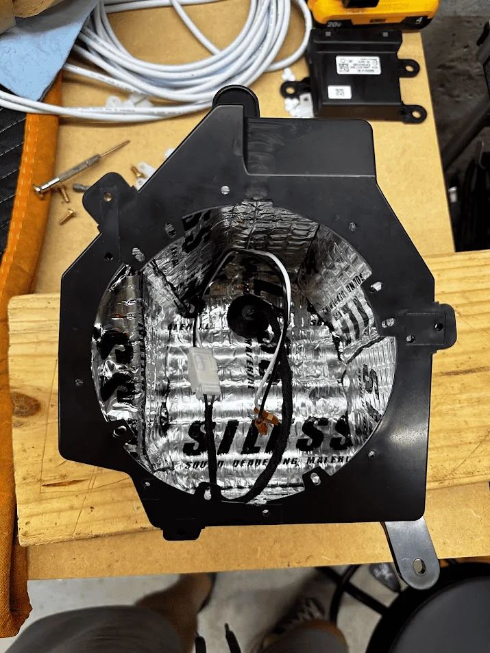

Yes, I installed the Kicker KS 6.5" in the knee panel. Used sound deadening tape and lined the new pods you'll need to fit the 6.5" speaker. I also added polyfil to the knee pods, under the upper dash speakers, and in the sound bar. The knee panels, upper dash corners, and sound bar all have Kicker KS. I kept the factory amp and subwoofer in place.
Upper dash corners are 3.5" coax with .75" tweeters. Went with plug and play sound bar pods, they have a 6.5" coax speaker and an additional .75" tweeter in them. No cutting needed. Knee panels have the 6.5" coax with .75" tweeter as well, BUT the factory amp is not wired to run a coax signal to the kicker panel so a good midbass speaker is all you need (lesson learned on my end). They still sound great though. If you plan to install your own amp then you can obviously wire all of them however you want. Huge step up in sound all around. No clipping or distortion from the KS series. I can clearly here the music now while the top is off and I'm driving. Also, sound deadening tape and polyfil took away all hollowness. So glad I did that.
Upper dash and sound bar swaps are quick. Yes, the knee panel speakers are involved with removing a lot of the dash, but you already have to so it's a no brainer to do the speakers while you're in there. Adding a 6.5" mid there will definitely up the music game for you.

Forgot to add, make sure to seal every hole in the knee panel speaker pod or air will whistle through ANY hole left unsealed. Because the pods can take 6.5" or 6.75" speakers from multiple brands, you won't use all of the mounting holes. Seal them up or you'll have to get back into your dash again.
