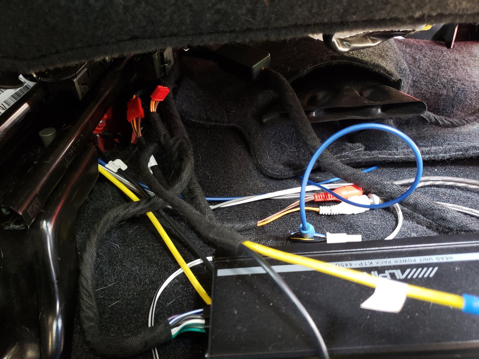

Anyway, the sub wasn't that bad to install,I had to find a way to get the power wire from the Alpine 445u, to the 4 gauge power wire under the drivers seat, also the spealer wires, and blue turn on wire, for the sub.. The picture of the red fish wire on the sub, is the spot I ran it, also there is a ground right thier,,under the drivers seat, for the sub..
Anyone using the alpine harness, the 445u is grounded by the harness,so I just had to run a 12 gauge power wire, as per Varilux. I lucked out when Emgeesea was kind enough to give me the RCA sub cable, for the Alpine harness.
I hooked up the blue turn on wire to the subs blue&white turn on wire in the harness.
I used fuse holders, with 15 amp fues,on both, the amp and sub.

Wanted to show the wiring up I did with the sub and Alpine 445u. I found out that just taking off the negitive battery cable does not work,so Quadratec vide is wrong on that and I'm sorry for saying that, darn ESS junk!
I used heat shrink and but end conectors. I know it looks like spaghetti, I have to mount the 445u, but it's working.

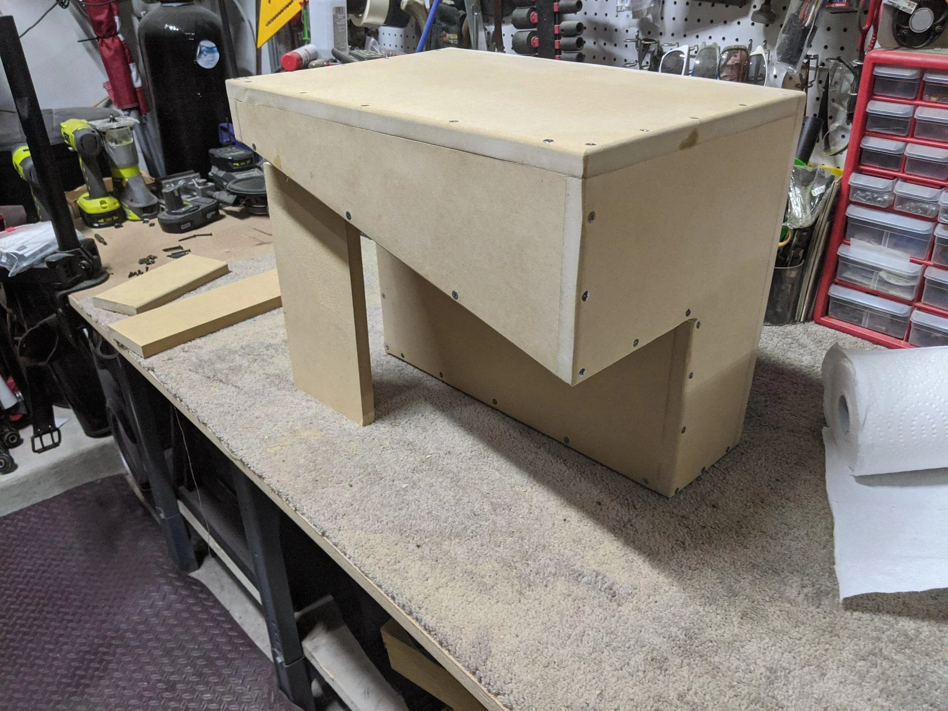

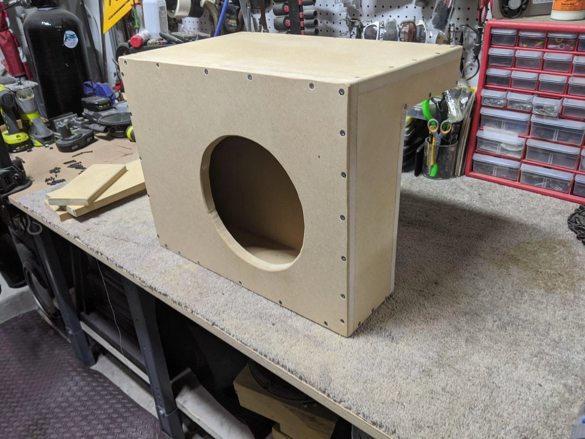

Got bored waiting for the ssv 6.5 brackets to come in and started building a new sub box.. Disappointed in the lack of sub boxes for 2 door JLs so I built my own. Box is complete just need to nail down how to keep it level and steady. Once that is done, I will take it and have it linex'ed here at the shop around the corner.
Jeep Wrangler JL Plug and Play amp upgrade to basic system IMG_20200710_224832
Jeep Wrangler JL Plug and Play amp upgrade to basic system IMG_20200710_224828
Jeep Wrangler JL Plug and Play amp upgrade to basic system IMG_20200710_224754
Jeep Wrangler JL Plug and Play amp upgrade to basic system IMG_20200710_224749
Jeep Wrangler JL Plug and Play amp upgrade to basic system IMG_20200710_224728
Jeep Wrangler JL Plug and Play amp upgrade to basic system IMG_20200710_224723
