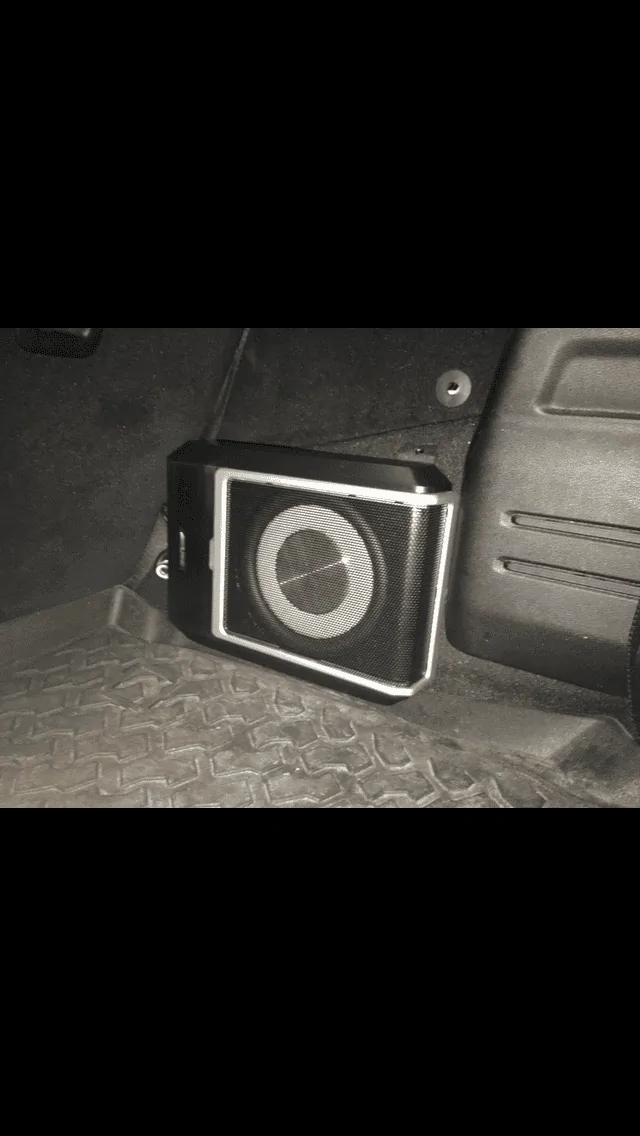

Alright peoples, I finally got my Alpine PWD-x5 installed, and I gotta say it is really impressive. If you want an all-in-one easy clean solution, look this unit up. It definitely exceeded my expectations, though of course opinions vary, but I highly recommend checking it out...sorry having problems uploading image, I had it installed where Alpine sub usually is behind right passenger seat, fits perfect...

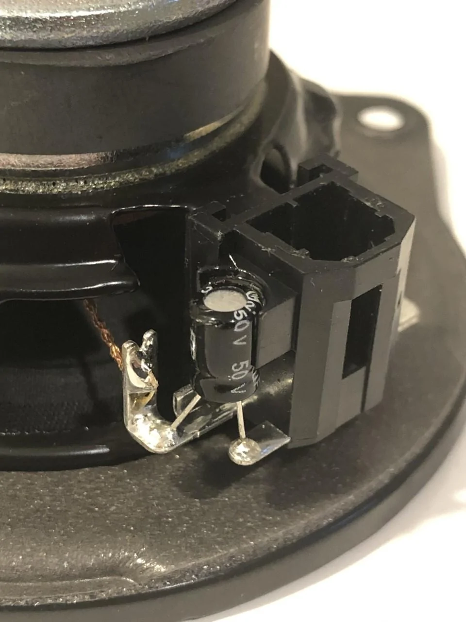

So, I went to install the front 77Kick25ABs today and noticed the capacitors on the factory speakers.
They are on the left side of the factory connector. I also noticed that the 77Kick25ABs have the exact same connector and it is just bridged with a wire (soldered), so... I was able unsolder the wire bridging the connection and solder the Bass Blockers onto the Kicks without modification to the factory wiring harness. :like:

Do you know what the capacitors are for? I installed mine so quickly(didn't want to listen to my wife say: why are you spending more money) didn't notice it on the speakers or they didn't have it?
Wolfy
Jun 18, 2020
291
331
SLC & Ivins Utah
2020 Jeep Wrangler Sport S
I'm pretty sure the capacitor is a bass blocker. I couldn't read the value on the factory cap clearly, but it looks like it might be a 2.2uF, which I think would create a pretty high roll off (>8Khz)?

Yep. The capacitor is a passive high pass filter. Aka Bass Blocker. The formula to calculate the crossover frequency is
freq = ___1___
2Ď€RC
freq is in HZ
R - speaker resistance in ohms
C - capacitor (1 ÎĽF = .000001)
Ď€ - 3.14159
here is a much easier HPF calculator:
HPF Calculator
