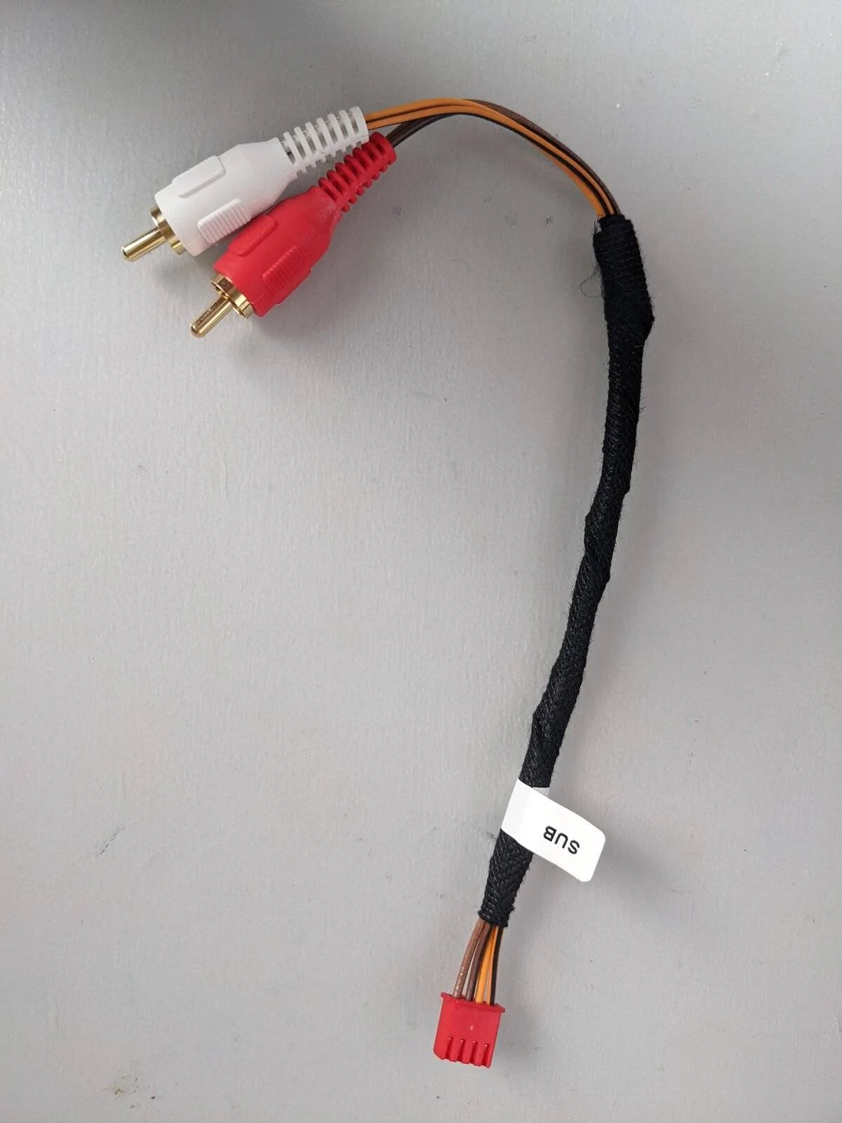

I just made a little discovery that everyone who is running the Alpine T/Main harness with the subout connectors should know (probably any harness really). Normally the sub uses the wire inputs in the hardness to connect to the PWE-S8 sub. Well, I just tried to use that same harness plug and use the connectors that convert it to a RCA input instead and plugged those into the PWE-S8 sub and HOLY COW what a difference. I do not understand why Alpine doesn't have this in its documentation. I'm baffled really. Its night and day. I am now completely happy with the PWE-S8. It made a 1000% difference. Its finally working the way it should. I now have a passenger seat massage chair :CWL:.
Do NOT use the wire inputs that are part of the harness. Use the RCA. Thank me later.

Its actually done at the end of the harnesses that attach to the amp/sub. Not the T harness (which is behind the stereo)
So I used the Alpine T/Main harness to connect the stock radio, the PWE-S8, and the KTP-445U AMP.
That T/Main Harness has a subout that connects directly into the PWE SUB IN connector which connects to the PWE wire harness directly. Seems straightforward and even label'ed/colored that way so that is what I initially used to connect the PWE sub. That was a mistake. At least for my sub.
I noticed that this wire below *also* came with the kits
Jeep Wrangler JL Plug and Play amp upgrade to basic system PXL_20211130_184542666
I unplugged the red connector that went from harness to the sub directly and instead used this connector to convert to RCA. After making that connection, the sub now sounded like a sub.

According to the installation instructions for the OEM head unit, using the RCA connectors to the SUB are required. I need to go check if that's how I have it wired and see if my spare parts include this wire or not...
