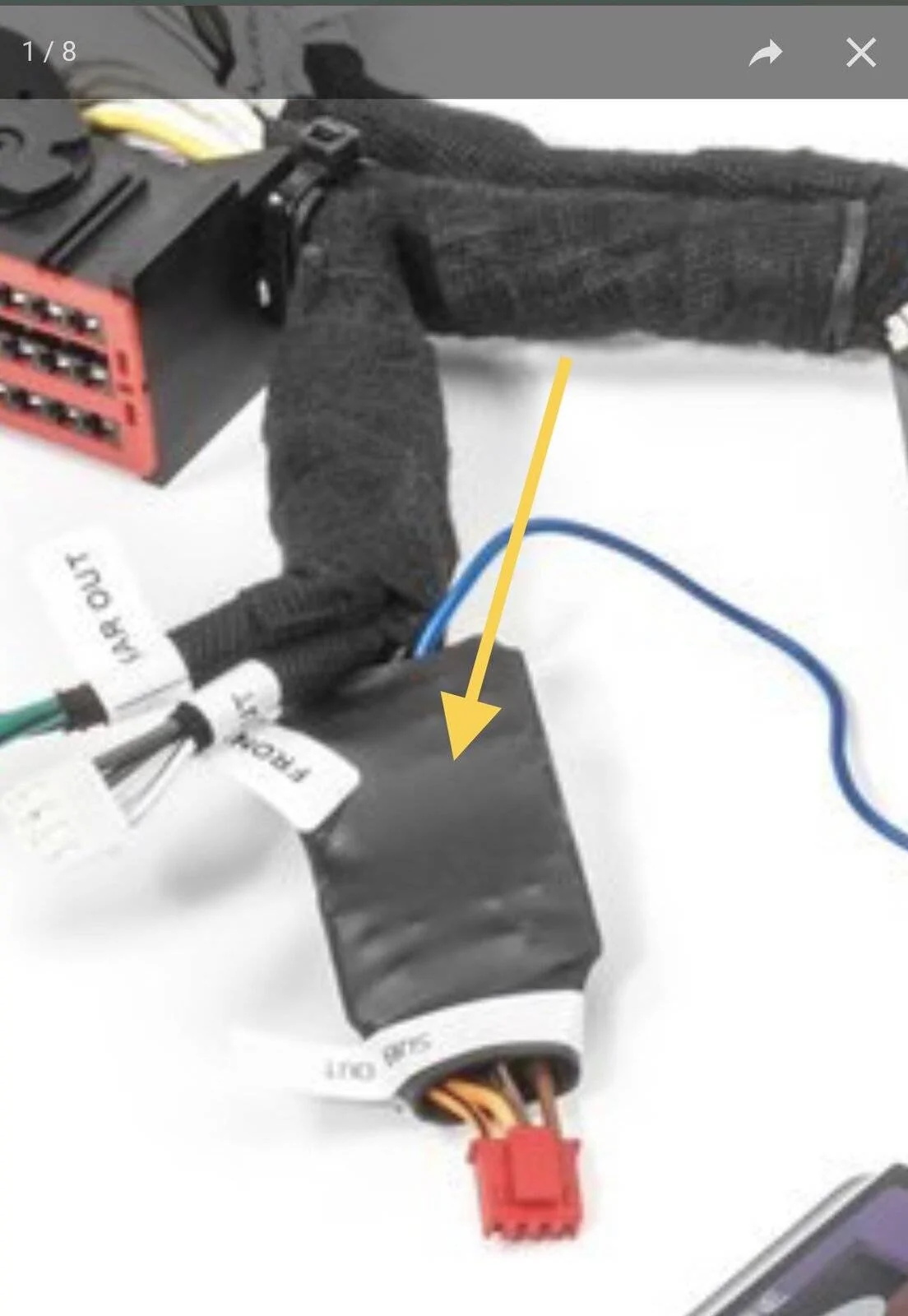

Thanks for the response. The harness you used looks like it has a LOC covered up under the tape for the SUB feeds or am I wrong see attached picture. Also how did u manage to secure the amp under the seat? Thanks

I believe (been a while now, so I might be remembering incorrectly) there was another part of the harness that converted the plug into RCA jacks. I think you can use the feeds from the sub out feed to hook up RCA plugs (you can either cut up an existing RCA cable, or there are adapters you can get through BestBuy or on Amazon). I also seem to recall that only one of the RCA plugs seems to send a signal (I found I could disconnect one of the plugs with no change in sound, your experience may vary).
As far as securing the amp under the seat, it is a tight fit with both the amp and the powered subwoofer. Honestly, I just have the amp laying on the carpet (it is heavy enough to stay in place). I like having the amp "loose," because it is easy to pull it out from under the seat to tweak the gains and dip switches if necessary (although after the first few weeks, I had it set where I like).

This definitely looks like it would eliminate the need to cut into the factory harness. It provides out and in wiring from the amp (and, it already contains the resistors necessary with most amps to make the head unit think there are speakers connected). The only wiring required would be to make all the connections to the amp's in and out feeds (which should be a total of 16 wires).
