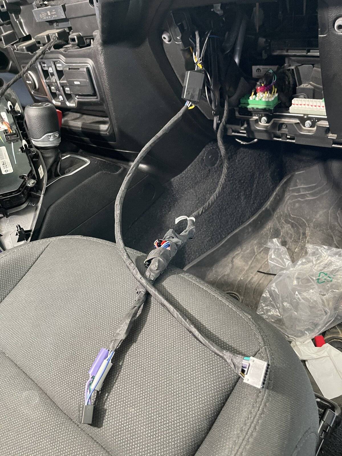

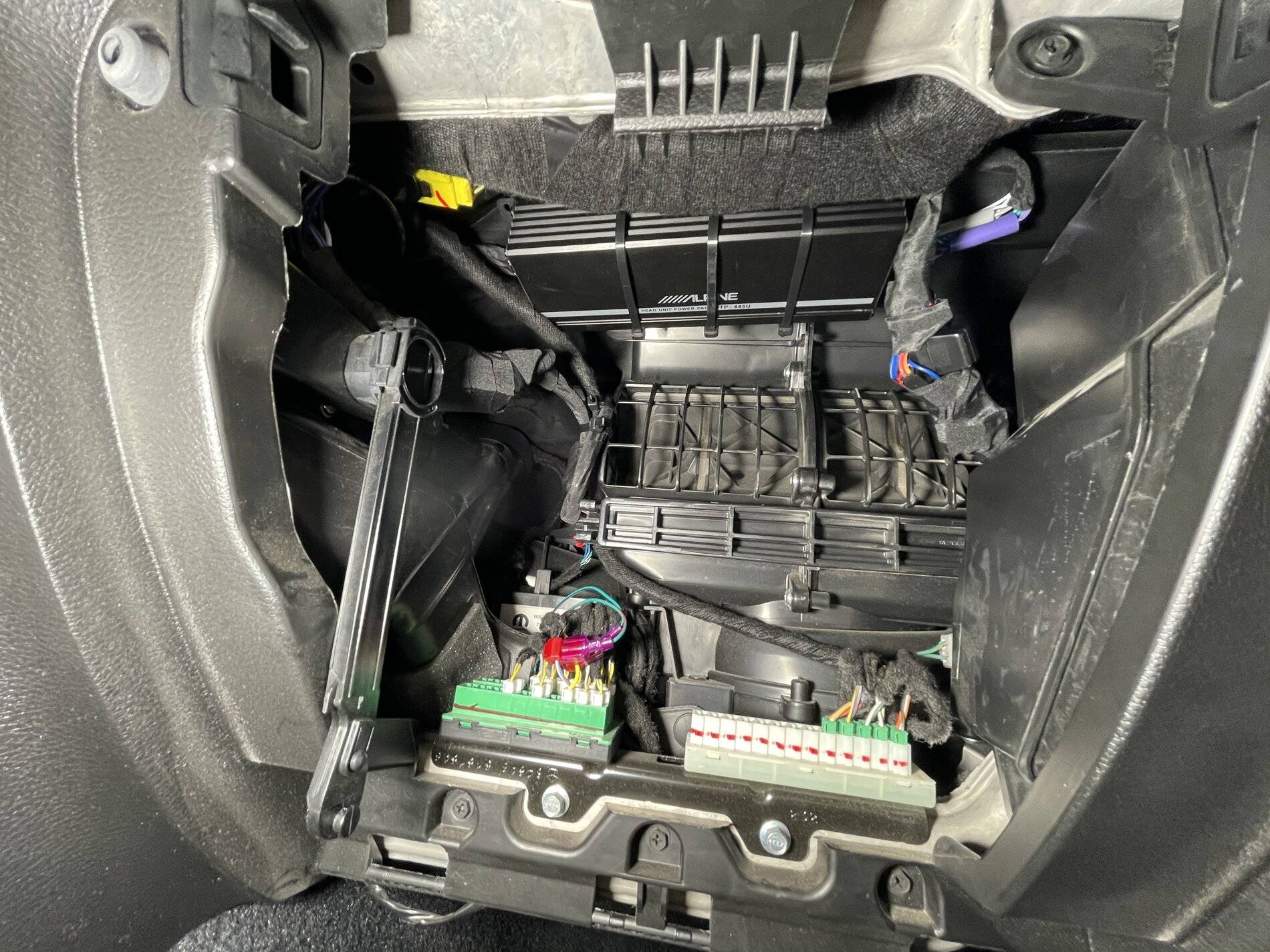

Success on my install!! Harness worked out great and the sound is amazing! Thanks for the help!
Couple questions:
Did you install any wires from the battery to the amp?
Did you need to install any resistors?
Beyond the wiring harness and the amp were there any other parts needed?
I just placed an order from crutchfield, I am very excited!

Awesome! I'm guessing you've noticed the boost from the amp? So did the harness you purchased plug directly into the Alpine, or did you have to make connections on all the wires? Either way- glad you found a T harness and enjoy the tunes!
Thanks. Yeah the boost to my stock speakers from the amp is really strong. Most likely will upgrade them in the future but now I have set the gains on the amp at a really low level and my stock speakers are providing me with great sound feedback. I was looking for an oem type of sound and this is great for me! It was not plug and play. I had to splice a total of 16 wires on T Harness and Amp Wiring. 8 for input and 8 for output and a total of 2 Wire Taps for + and -. But besides it was pretty straight forward.

Couple questions:
1. No
2. No
3. Thats it. Besides regular items like wire taps, connectors and electrical tape/fiber cloth tape.
where did you cut and connect the wires to? What positive and negative wires did you connect? Any pictures would be incredibly helpful!
