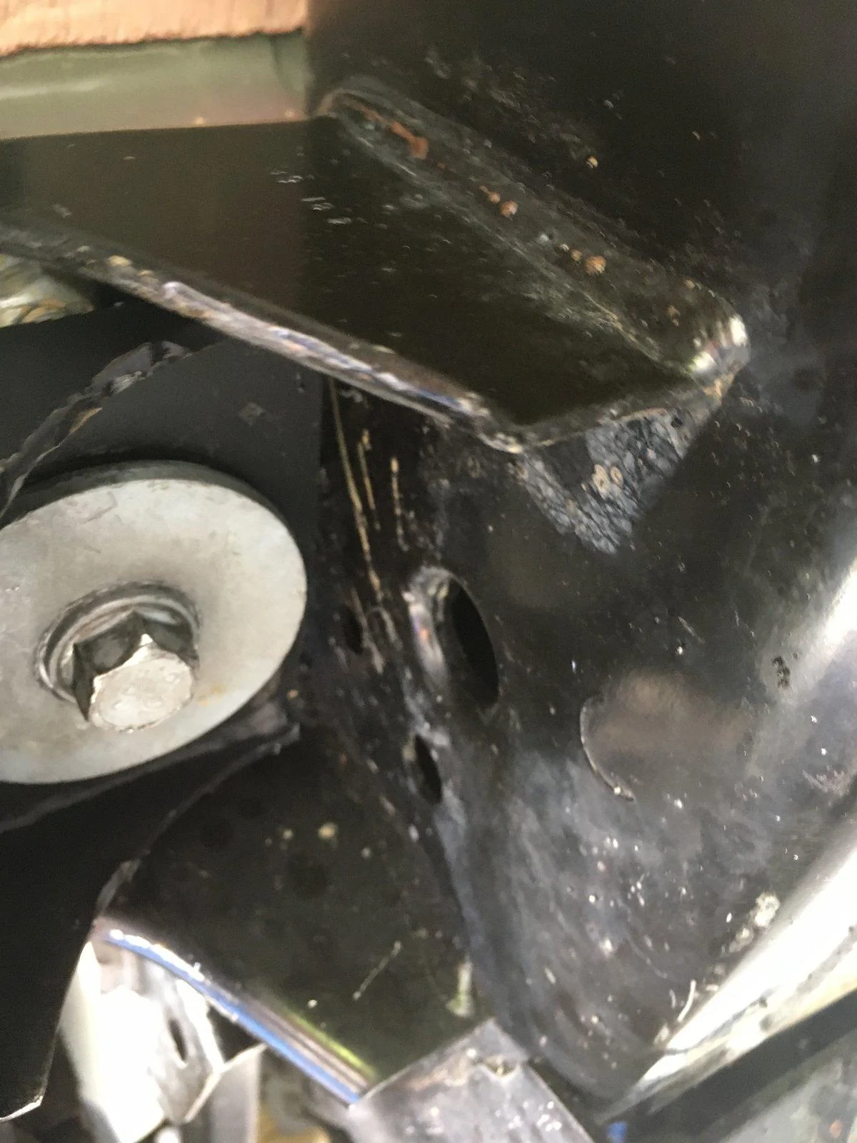

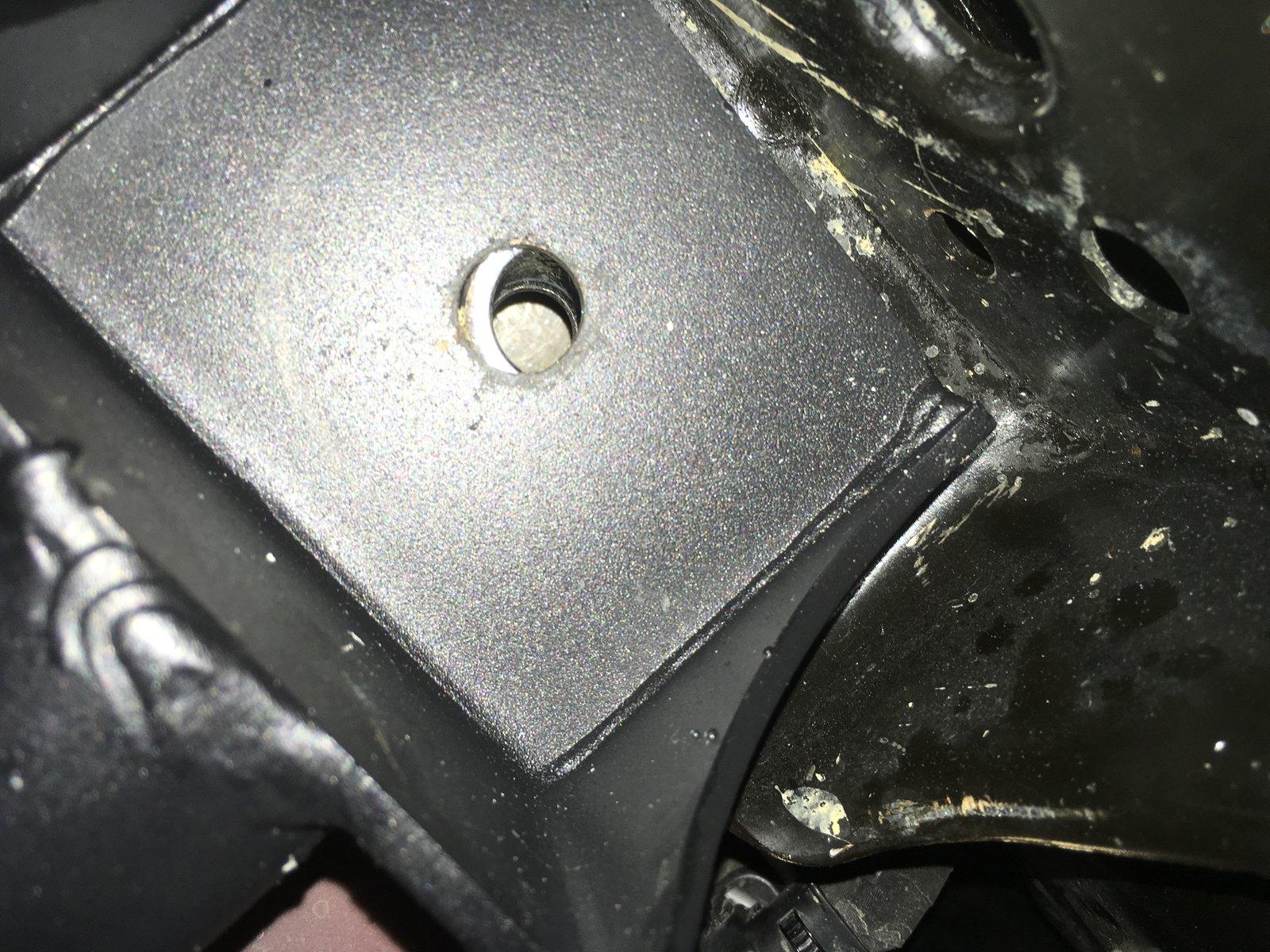

Well, we got it all except for the passenger side back bolt. The nut has disappeared into the abyss, and no magnet or hook can find it. I have no options left. The body bolt has nothing to screw into. Maybe I can alternatively use a swedge type bolt to replace it? @ACE Engineering
If possible, email these pics to [email protected] and give us a call at the shop. AJ is our Production Supervisor and has installed hundreds of Rock Sliders. He may have some pointers. 586-806-6641.

What about taking a rubber mallet to the frame around that area to see if you can jar the nut loose, listening for any vibration. I'd bet the nut just got wedged in there somewhere.
I have a USB Camera that fits in tight spaces like that. Got it on Amazon and it works on my phone/tablet/laptop. Know anyone around you that may have one? I do think the rubber mallet approach may work. Just don't get angry and hit something you shouldn't! Best of luck, wish we could help more.
Leaving to borrow a diag camera now...

Hi, don’t know if you found the channel nut yet. I ran into the some problem, a couple of taps with a small rubber mallet, found it was towards the front. I went to Tractor supply , harbor tools will do. I bought a small round magnet with a hole in the center and first attached it to a wire clothes hanger but it wasn’t long enough. T ended up using a long piece of stiff 10ga wire and got it back to where it belongs. Hope this helps

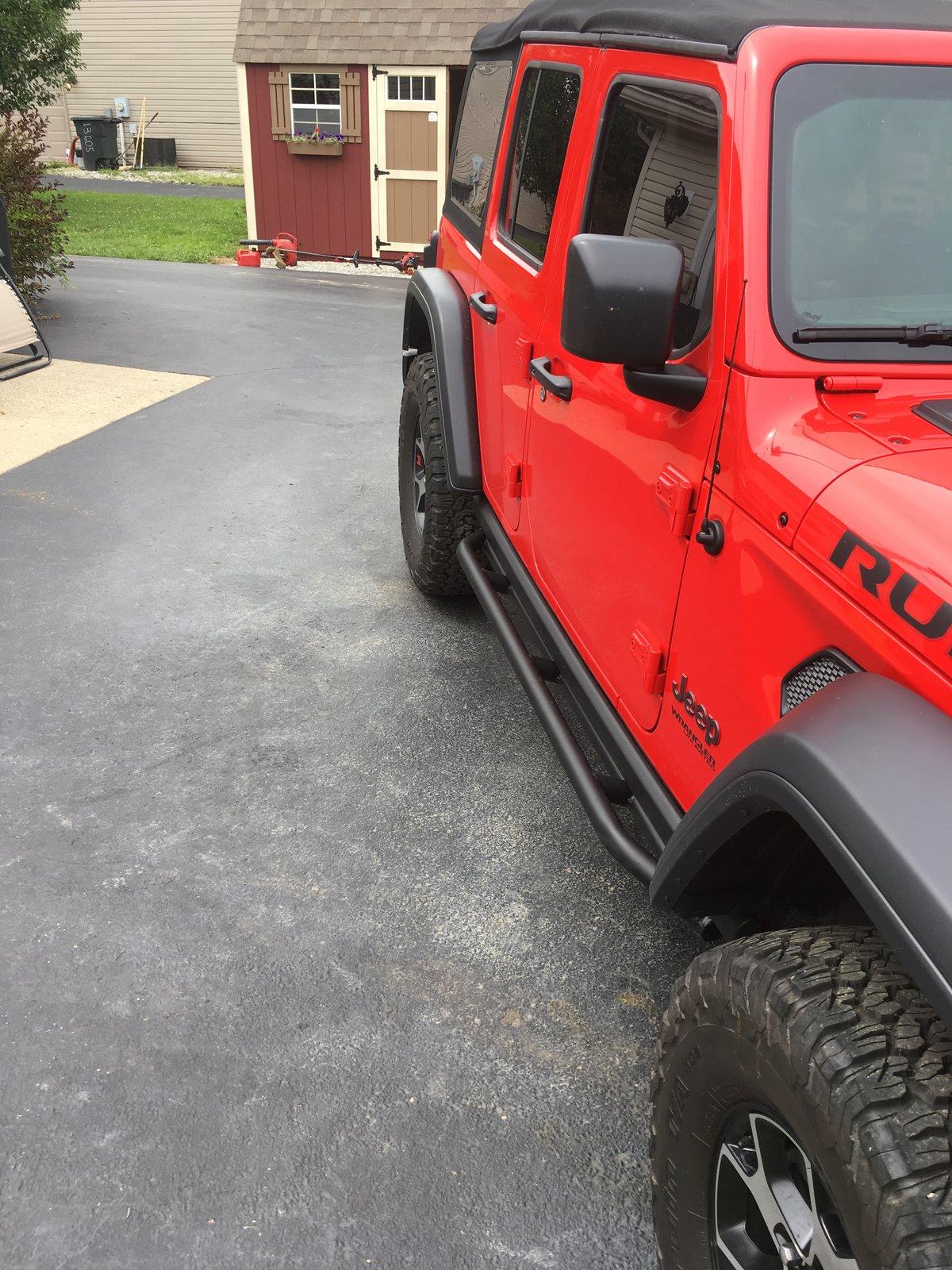

It’s true that not all super heros wear capes. We got them on! Thank you all who replied for the assist. That’s what this forum is all about, and couldn’t have done it without you.
The diagnostic camera I borrowed was really the tool that was most helpful. We put it up in the body mount, and confirmed the nut actually still existed up there, it was wedged about as far back as it could go in that cavity. We then fished a wire coat hanger up there, and got it close enough to the hole to let our magnet do the rest of the fishing. These will be on for the duration of my ownership, as I will never touch those body mount bolts again, lol.
Thanks again, jeeper-heros!

Congrats. I love my Ace Sliders. Love the look and the toughness. And despite lots of gravel roads (and KO2s) I have no damage to my rear fenders or door hinges. I hear lots of 'pings' as the rocks hit the sliders but even though they are not solid, they seem to block the rock slinging. Thanks @ACE Engineering ! Trying to save up the money for their trail doors.
