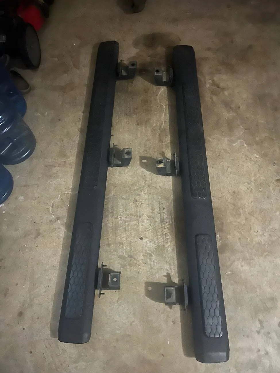

Bought a 19’ JL earlier this week and picked up some running boards from someone locally. They were pulled from a 20’ JL. I assumed they would work, but not 100% certain on that. What do I need to install these? They have screws in each of the brackets but they seem to be welded in. Any help/instructions would
Jeep Wrangler JL Need some help with running boards IMG_2956
be greatly appreciated.

you need the 6 nuts for each side and the 3 bolts. super easy install no welding. the bolts go up thru the brackets and when you hold them up to the jeep you will see where the horizontal screws go in and put nuts on the other side.

Any idea what size bolts I need to get?

And are there instructions anywhere? I’ve googled and can’t even find these particular boards.

Not sure how to reference a prior post, but this was posted a few days ago: “Which Bolts Needed for JL Runniing Boards”
The nuts are M6 flange nuts - you need six of them each side
The vertical bolts and nuts are M8-1.25 x 25mm, flange bolts and nuts or regular bolt and a washer will work.
They are the optional Mopar tubular steps, I have them on my 2-door. They are also side specific, so check where the holes are in your pinch weld and see which step lines up correctly.

Check under your Jeep where those mounting brackets line up. If you're really lucky, they may be there.
