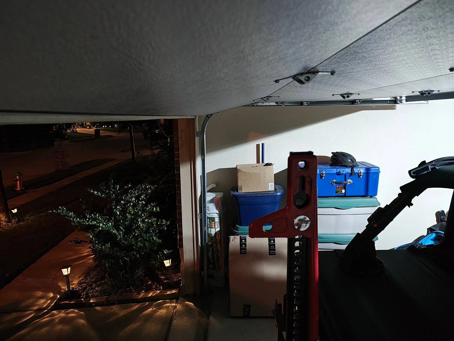

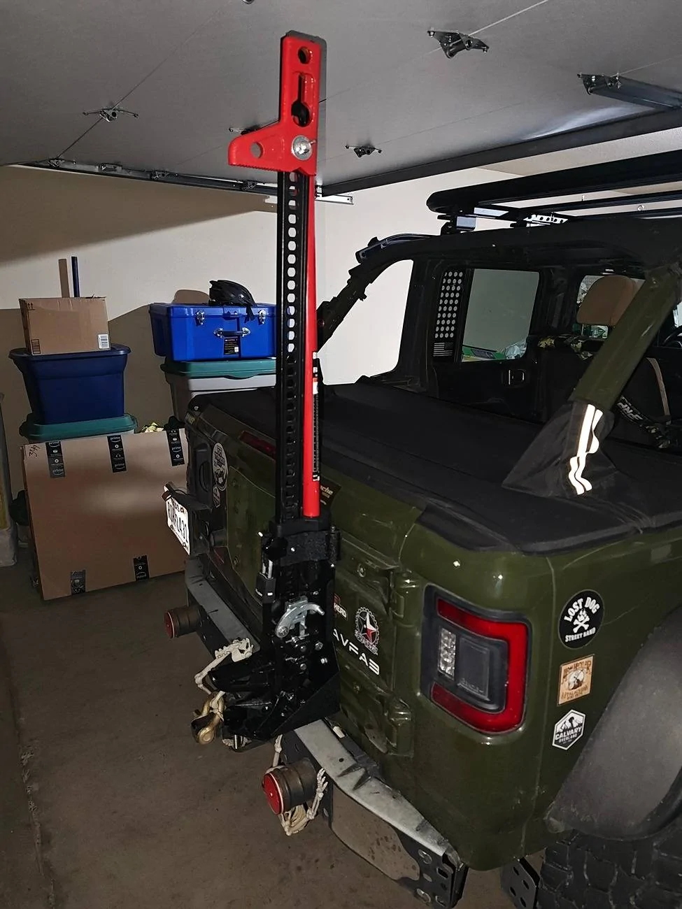

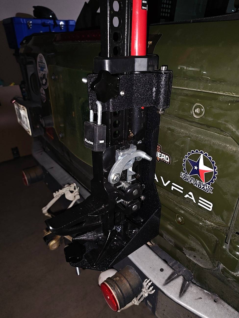

Hi-lift jack installed. This will be my permanent mount. That will probably purchase a better lock at some point.. bolt cutters could wipe this one out easy!
Install wasn't too bad, I was thinking it was going to take me 30 minutes max, even with the Chinese directions that were absolutely useless. Ended up taking me an hour because I had a few mishaps that were fully my fault, but realistically probably would have been solved if the directions were worth a dime.
Good thing I bought the 48-in instead of the 60-in from Harbor Freight. It just barely clears my garage door!

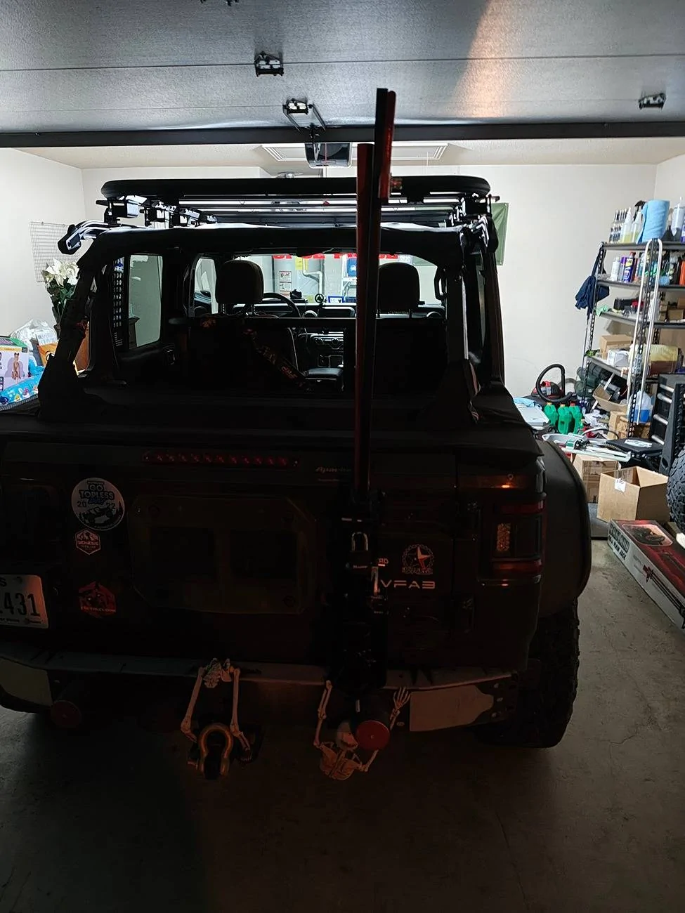

Jeep is all ready for tomorrow!

...will probably purchase a better lock at some point.. bolt cutters could wipe this one out easy!
I've that exact padlock on the fence's rear gate. With constant outdoor exposure, the rubber coating will eventually degrade (soften) and become sticky. You'll stain anything that your fingers touch after handling the lock.
Just an FYI. Replacing it will be a good idea. 👍

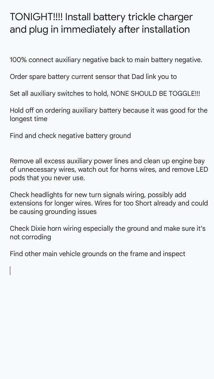

So one thing at a time, I had a code thrown for low voltage, I've been having issues with my battery on and off for the last month, it was a optima dh7 yellow top, which I'm now starting to think might have been the main problem.
That being said the battery doesn't seem to be recharging itself at all times it fluctuates. So I've done a lot of little things with wiring that I don't think necessarily all have to do with it or maybe even none of them, but at this point because my Wrangler is my daily driver and I need it to be reliable I'm going to backwards engineer a lot of the stuff I have done namely the stuff I don't use. I got a little checklist for myself and everything starting with tonight when I get home.
There is another thing that happened but I'm not going to get into that right now, mostly because I don't see how it played a part into this, I think it was just shit timing.
My goal through all of this is that I can stabilize the battery, as it is a new battery in the engine, and if I can get it to hold a charge and numbers look good on the voltage meter on the dash, I'll be able to relax a little bit and move forward with some of my other mods that I have available at the house, namely my jk fog lights.
Also though it's not in the list my stage 1 tune on my tuned PCM has a security light, it's been that way since I had it tuned and until recently it hasn't become a concern. Part of what happened when my Wrangler died (I think, because at this point I don't really actually know anything I just know low voltage, but beyond that it's a guessing game right now to make sure it doesn't happen again) is my tuned PCM which already has the security light on, dumped my Wrangler into anti-theft mode. I don't really want to go back to my factory tune but as of right now it's the safe bet so that's probably what I'll end up doing.
So my goal for tonight is at the trickle charger, and try and revitalize my battery just to where I'm comfortable with it, and then I'll swap out the PCMs, and I might do a few other things. We'll see what kind of time I have when I get off of work.
Get yourself a DVOM if you dont already have one and read on how to do a Parasitic Draw Test. If you have alot of stuff wired up it may be something you want to look into.

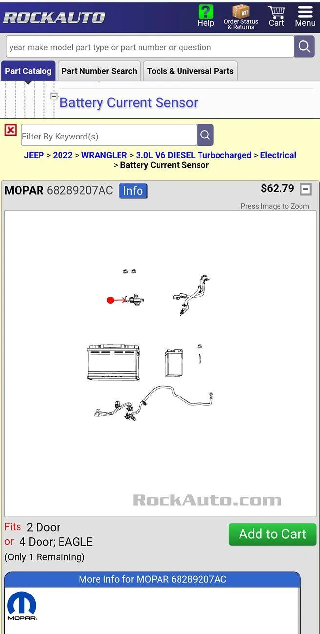

So while poking around the internet, my favorite place to find detailed information about stuff I don't find on here, the ram forums, had my back.
At this point it looks like my battery isn't charging at all times, which is what this battery charging sensor does, it communicates with the PCM and tells it to activate alternator to charge up the battery, that's why our Wranglers have what they would call a smart alternator, it doesn't run at all times to save some gas, it just runs when the battery needs it.
According to the ram forums, when this part above goes bad it doesn't just go kablooey and it's dead, it starts working intermittently, which makes sense why I will start having battery issues a month ago and then my battery just goes to shit at the worst possible time.
I just ordered this guy off of RockAuto it should be here by Friday hopefully whether it's bad or not I'm going to swap it out and with all of the other things I'm doing that should be the number one fix. My dad's coming over Monday and he has a tester that we can run some tests on other parts like the alternator and the starter, but at this point the main issue seems to be the battery isn't getting the charging that it needs and this part right here is the number one culprit in those instances.
Before I get a plethora of fuse and canbus comments, my jeep was in anti-theft mode for sure, and I had a low voltage code which I could not wipe, I checked all the fuses, I checked the canbus, i replaced the battery, all the normal simple stuff that we all hear on here everyday.
I guess if you wanted to be frank, where I'm standing right now, it looks like it was a combination of this battery charging sensor, and a weakening battery, combined with anti-theft mode and a low voltage code that I couldn't clear. And then, just some absolutely fucking terrible timing!!
But again I'm still early in the process so we'll see what happens
Sounds like a headache. Are you going to check that the PCM is sending the signal and its getting to the sensor and from the sensor to the alt? I tend to over complicate things, parts chucking has never worked out for me.
