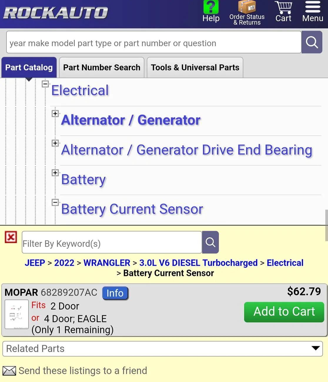

At this point it looks like my battery isn't charging at all times, which is what this battery charging sensor does, it communicates with the PCM and tells it to activate alternator to charge up the battery, that's why our Wranglers have what they would call a smart alternator, it doesn't run at all times to save some gas, it just runs when the battery needs it.
According to the ram forums, when this part above goes bad it doesn't just go kablooey and it's dead, it starts working intermittently, which makes sense why I will start having battery issues a month ago and then my battery just goes to shit at the worst possible time.
I just ordered this guy off of RockAuto it should be here by Friday hopefully whether it's bad or not I'm going to swap it out and with all of the other things I'm doing that should be the number one fix. My dad's coming over Monday and he has a tester that we can run some tests on other parts like the alternator and the starter, but at this point the main issue seems to be the battery isn't getting the charging that it needs and this part right here is the number one culprit in those instances.

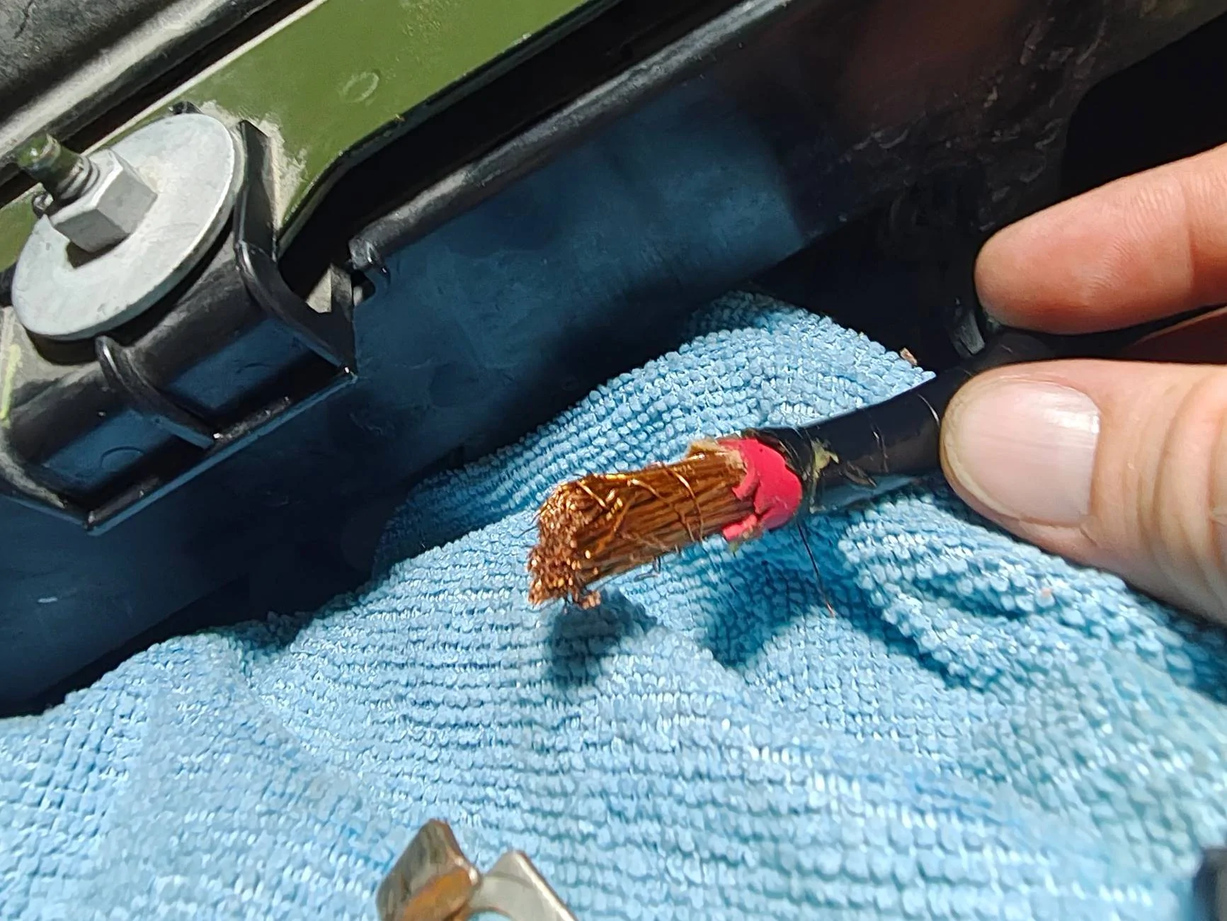

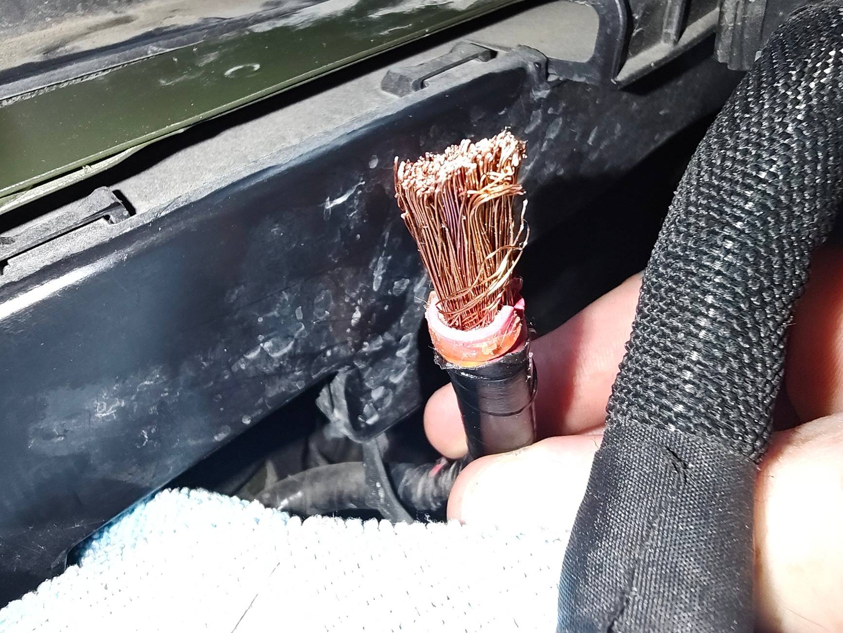

Was reading about the N-fuse rail / main fuse on here earlier today, and decided for $50 it would be worth it to replace that as well. Also too there's this...
So the alternator positive cable goes to fuse n7 (300amps) and then from there I don't know exactly where it goes, but eventually it ends up on the left side corroded terminal you see there in the photo above. That wire right at the end there is hot as hell.
I just ordered a new positive and negative three prong connectors for my battery and I will be replacing that burnt to shit wire, along with the three prong positive battery connector.
As an added bonus, whether it's needed or not I'm going to be replacing the main fuse (rail), along with the IBS sensor. On top of all the money I've already spent. :facepalm: :whew:
My dad showed me how to do this, and I do have a voltmeter at home, so I tested the battery at the terminals when the vehicle was off, I got 12 volts, and then I tested it again once the vehicle was on, and I got 13 volts, so according to my dad the alternator is in fact charging the battery a little bit, the dash in that moment also stated 13.6 volts coming from the battery.

Just curious, what's a 4 door Eagle I'm seeing there on the rock auto page?

In prep for tomorrow morning I already stripped this guy...
There you go, that answers that! Clean copper behind the corroded lug!! 😍
I think I'm going to replace the IBS just in case, and then after we get it started, I'll look and see if the main fuse is still good. I'm sure it is, I mean this thing wouldn't be getting hot if the fuse was bad, that's for sure! :LOL:
