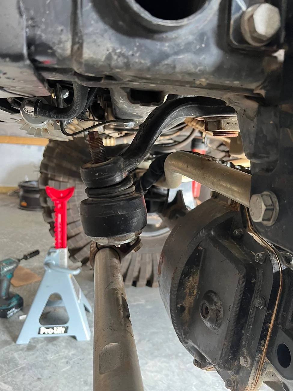

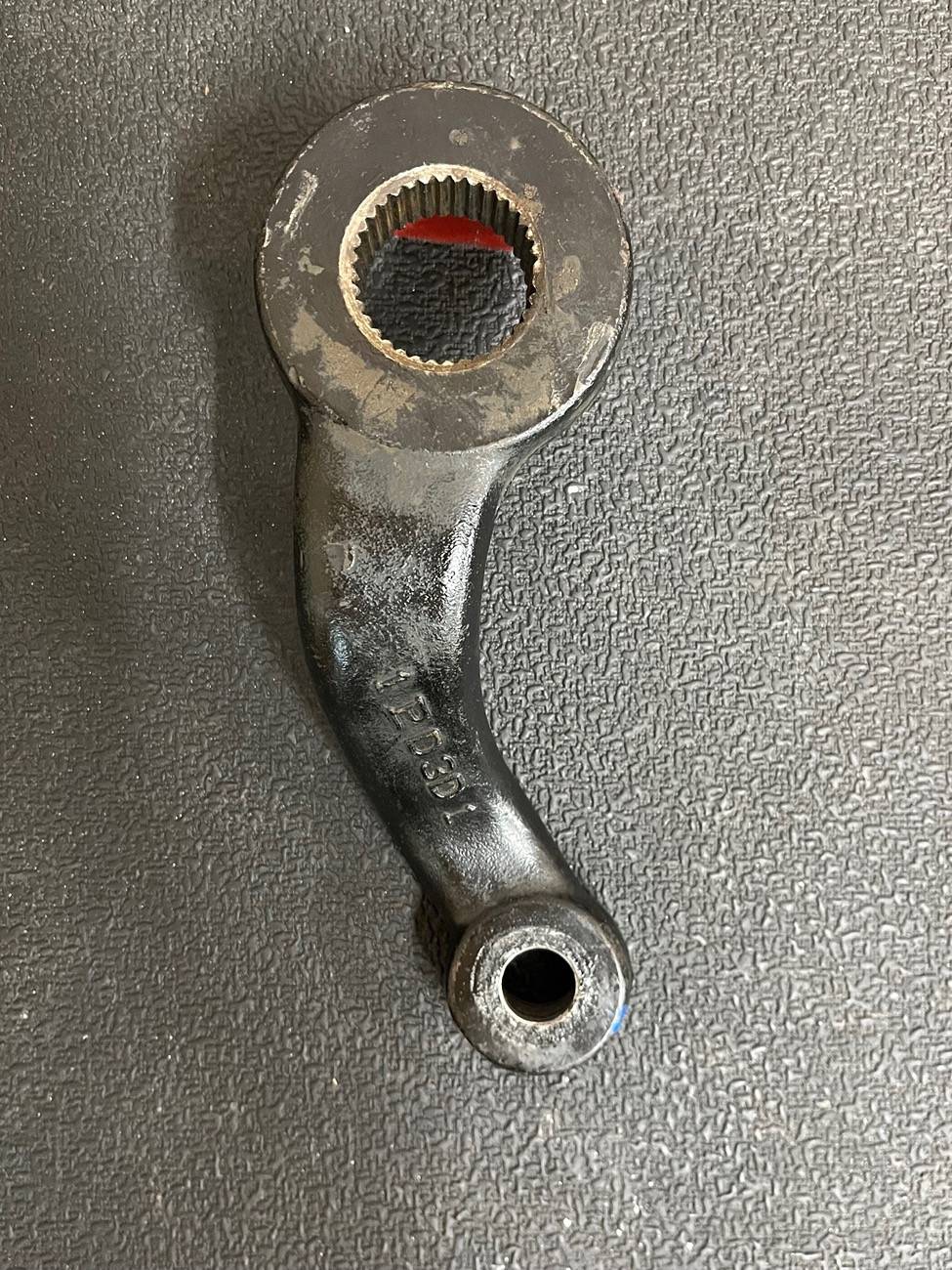

Weird request, but looking for some shots of your pitman arm from the front (not bottom or side, just straight on)
I think I might’ve bent mine but I don’t really remember what it looked like prior.
here’s what it looks like for reference:
Jeep Wrangler JL Pitman Arm Pictures! IMG_7288

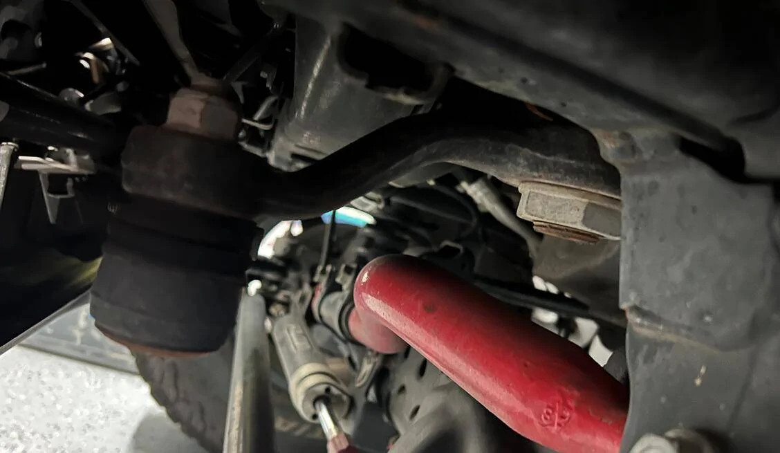

I couldn't get a front shot with the bumper in the way but here is a side shot if that helps:
Jeep Wrangler JL Pitman Arm Pictures! 1725569622159-qh

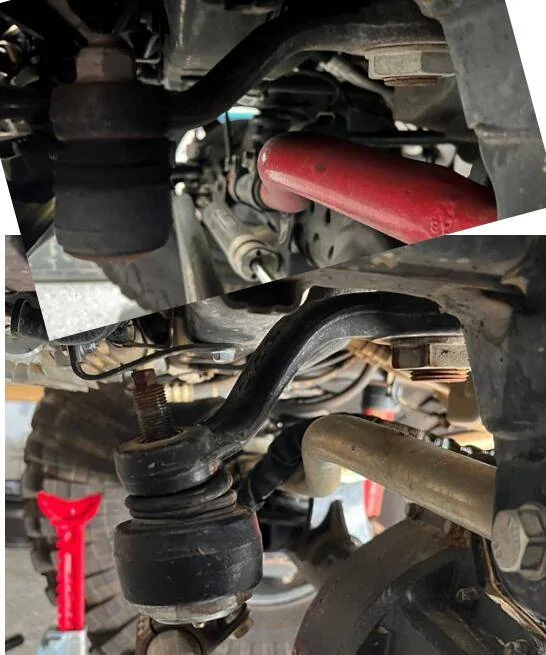

It’ll all help form a better picture, and I can already tell your drag link attachment is more level than mine

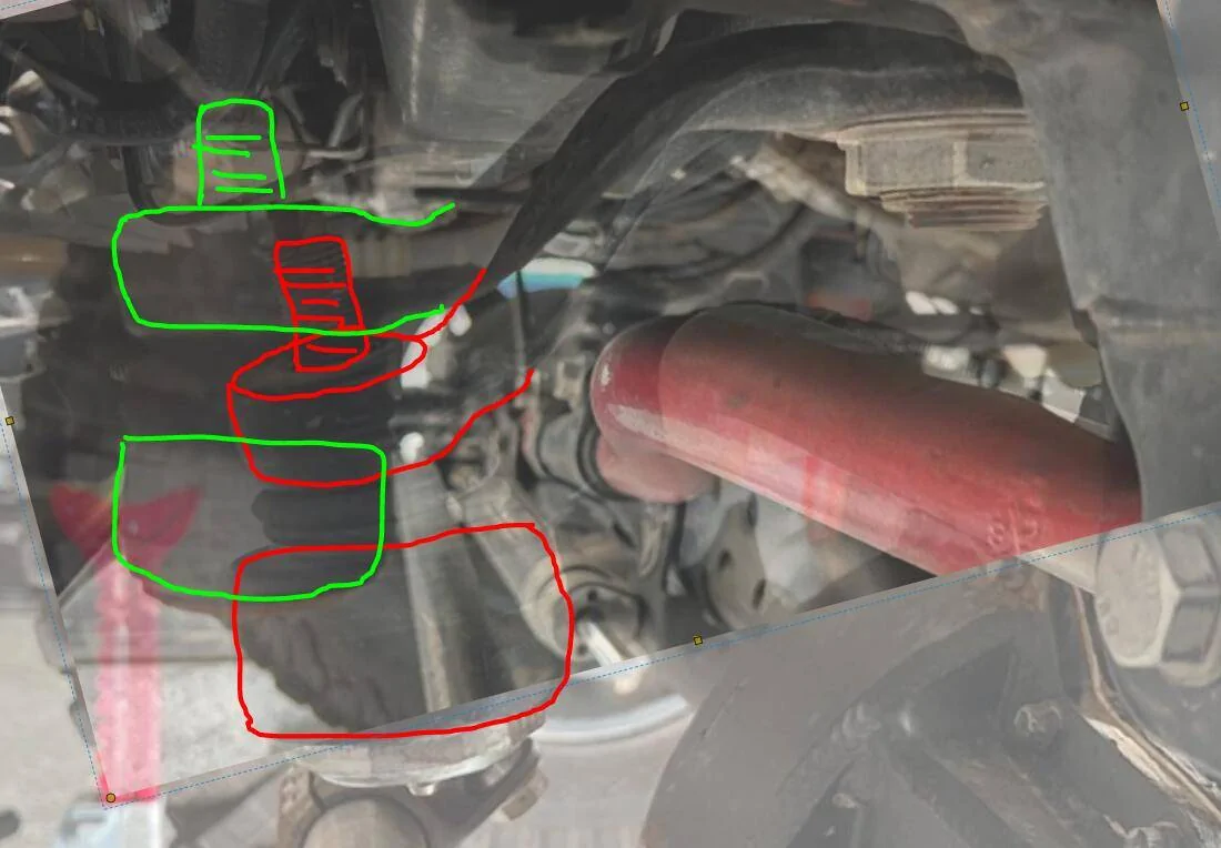

Could be the angle difference of the camera but....
Eh, they’re cheap enough to just replace anyways. Sweat labor isn’t so cheap but whatever
guess that’s what you get when the pitman arm is the weakest part of your steering
don’t go night wheeling into trees!
I checked mine. The draglink end should be slightly angled in the opposite direction yours is. That is to provide the hole for the draglink in a 90 degree position for a stock draglink angle (not lifted). Which makes sense when you think about it.

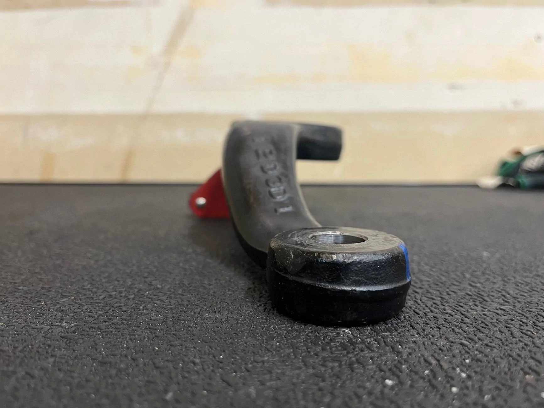

MY rough measurements when the draglink side sits flat with the bench. I'm measuring from the bench surface to bottom of the pitman arm on the sector shaft side:
Jeep Wrangler JL Pitman Arm Pictures! PitmanArm_02
