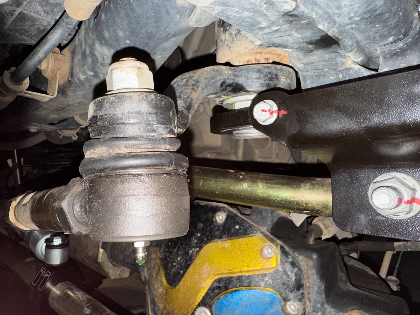

first one is the pitman arm and second is drag ling adjuster which is what was probably the issue. probably forgot to tighten it. for the record it is really tough removing a pitman arm.
Hang on, did they redesign the steering linkage and put a ball joint on the pitman arm and a tapered hole in the drag link or am I crazy?
Drag link ball joint points up

Interestingly enough there really nothing to go wrong with a pitman arm. It has no moving parts. So they must be referring to the draglink which has 2 balljoint ends. Those being worn and sloppy is common.
