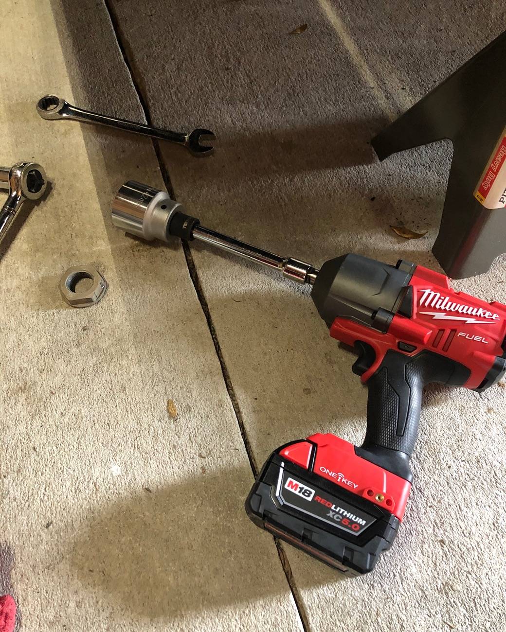

I use this…… I haven’t come across one that didn’t come off yet……

I have an HD Extension 42mm socket and a 250# Craftsman electric impact gun. But yet the nut just laughs at me!
The Milwaukee impact has 1200 ft lbs of torque, and 1600 ft lbs of nut busting torque, the craftsman is a toy in comparison…..

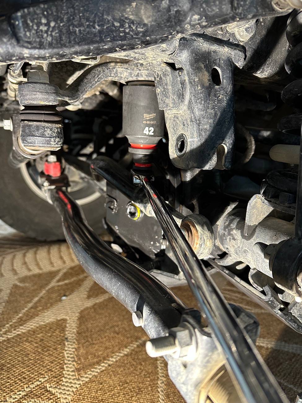

I have the same Milwaukee impact but when I installed my sector shaft brace I used a BigAss (trade marked) breaker bar
Yes, I do not recommend using the Mack daddy for installation, bad things can happen…🤣
I used the breaker bar to remove just out of paranoia and ignorance, then a torque wrench to install.
