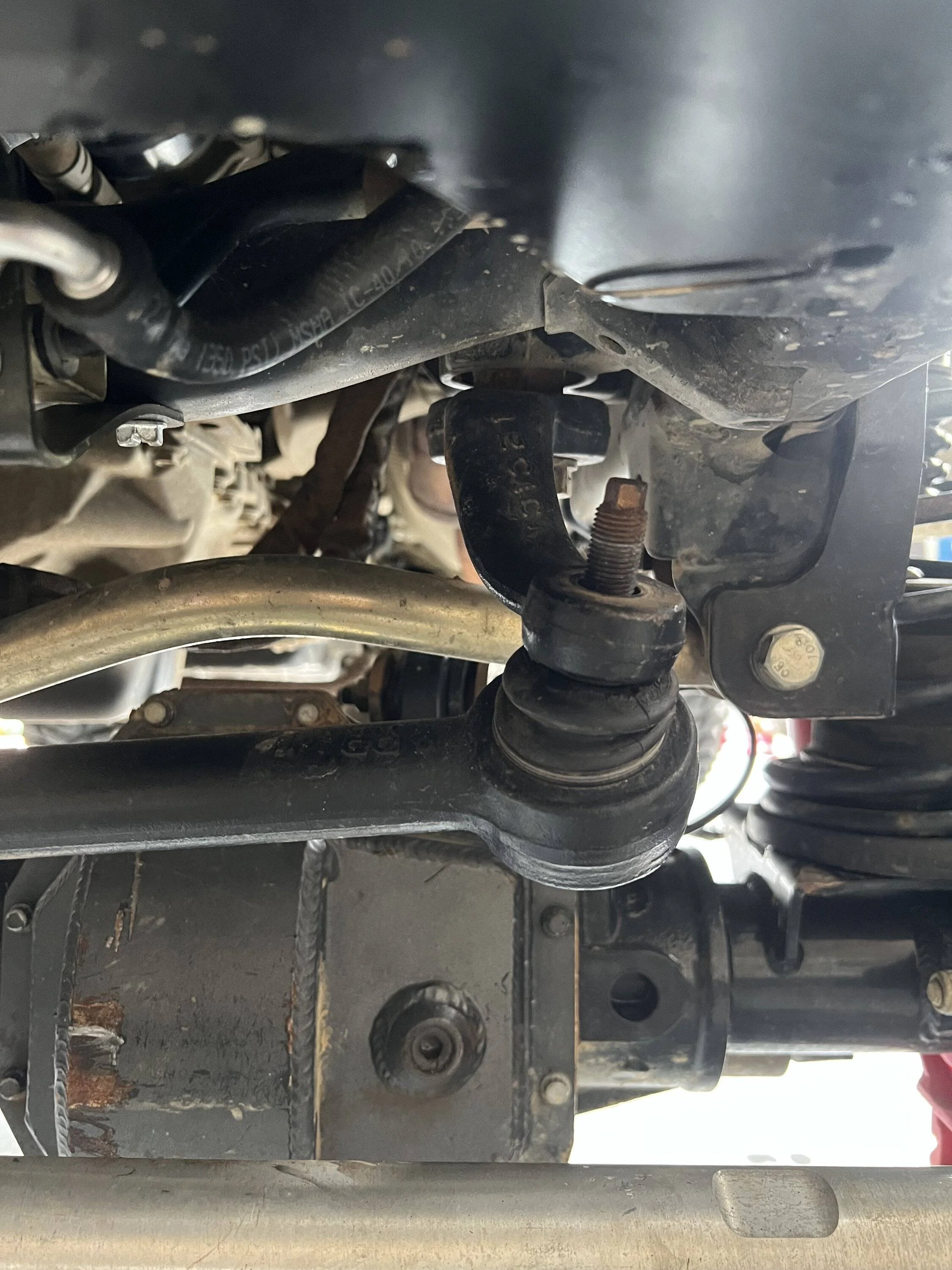

Weird request, but looking for some shots of your pitman arm from the front (not bottom or side, just straight on)
I think I might’ve bent mine but I don’t really remember what it looked like prior.
here’s what it looks like for reference:
Prior to what? Is your steering wheel straight?
All of this info is in my other messages in the thread, but, prior to running into a tree with my passenger tire. And no, my steering wheel isn’t straight
