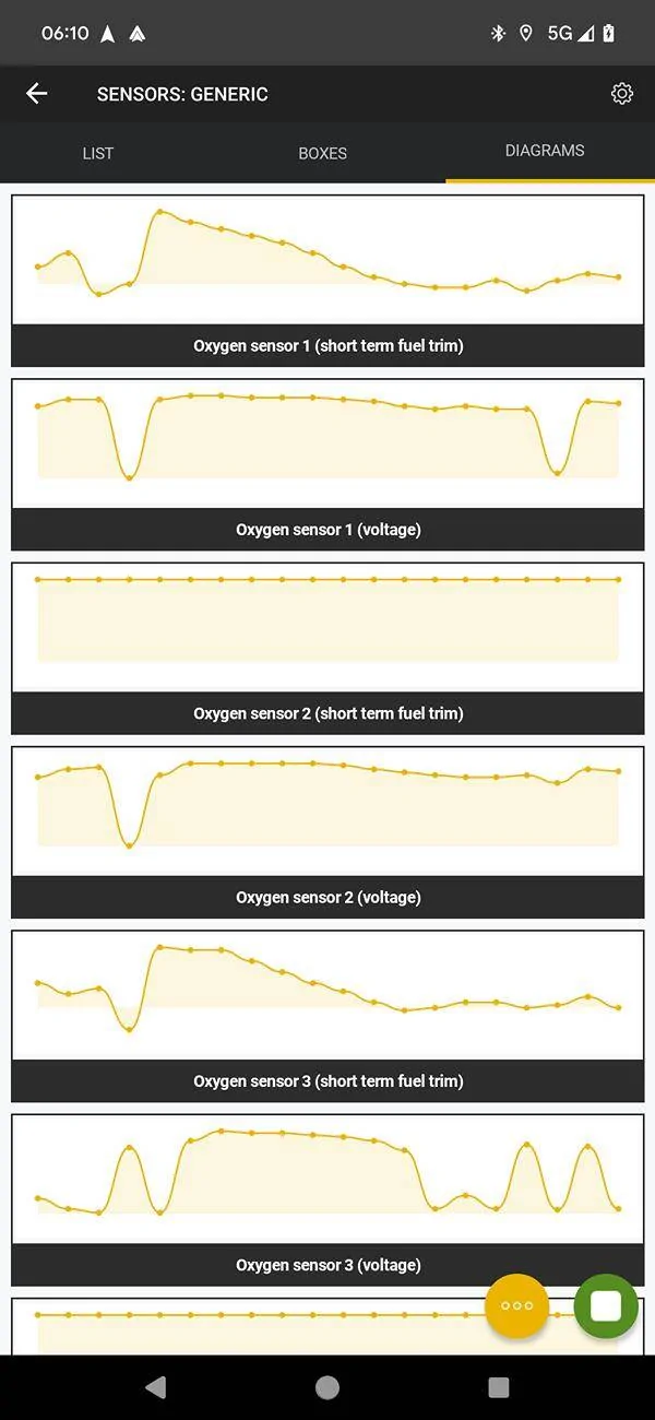

So I'm guessing that this would indicate a failed cat?
Jeep Wrangler JL Permanent p0420 code after valve cover leak Screenshot_20240625-061043
I'm going to be honest that is the worst graphing scan tool readout I've ever seen. Oxygen sensor "1" or oxygen sensor "2" means what? They're 1/1, 1/2, 2/1, and 2/2. No idea which sensor correlates to what here. No idea if this was tested during a drive, accelerator conditions, or anything. Hell, don't even know what scale this is, or what each point tested at.
Sensor 1 (i assume this is sensor 1/1?) doesn't even change voltage, which is impossible unless you're just idling it and nothing else.
You need to monitor the right bank upstream and downstream voltages (sensor 1/1 and sensor 1/2). Sensor 1/1 should jump voltage constantly with throttle input going representing the constantly changing fuel mixture. The downstream should stay a relative constant voltage. This test should be performed on a test drive.
