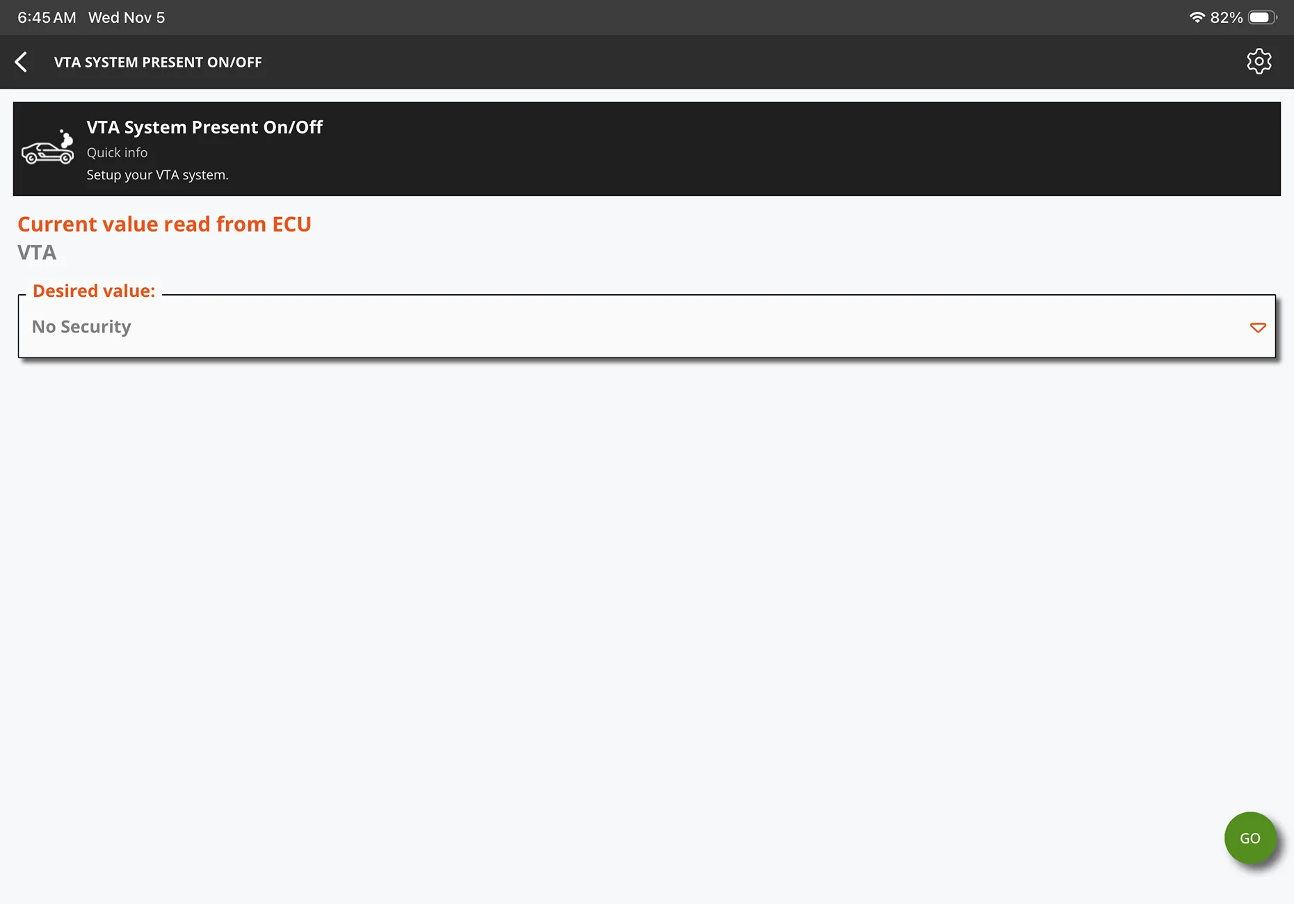

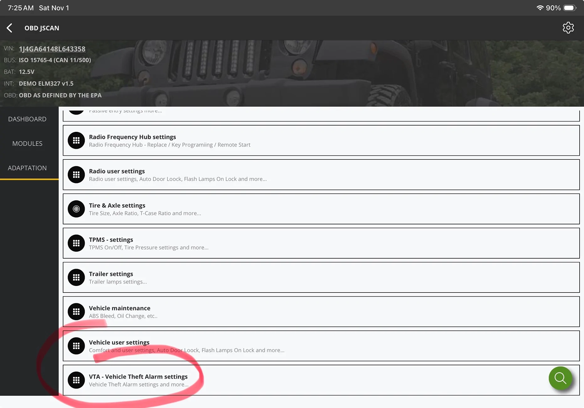

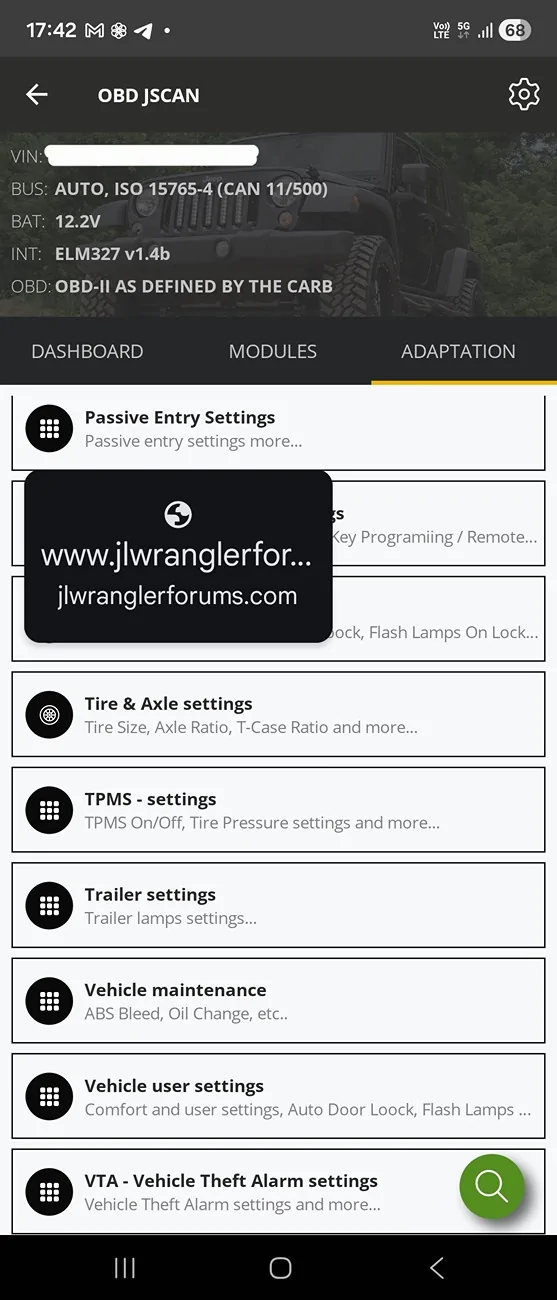

I used JSCAN to disable my panic button, for me the panic button is just a vehicle locator as ppl have become numb of hearing a horn blowing.
Can you please advise me in which module?

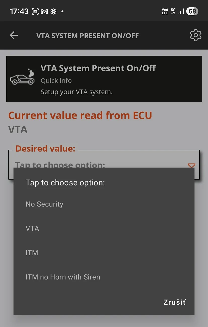

I have it set to no security

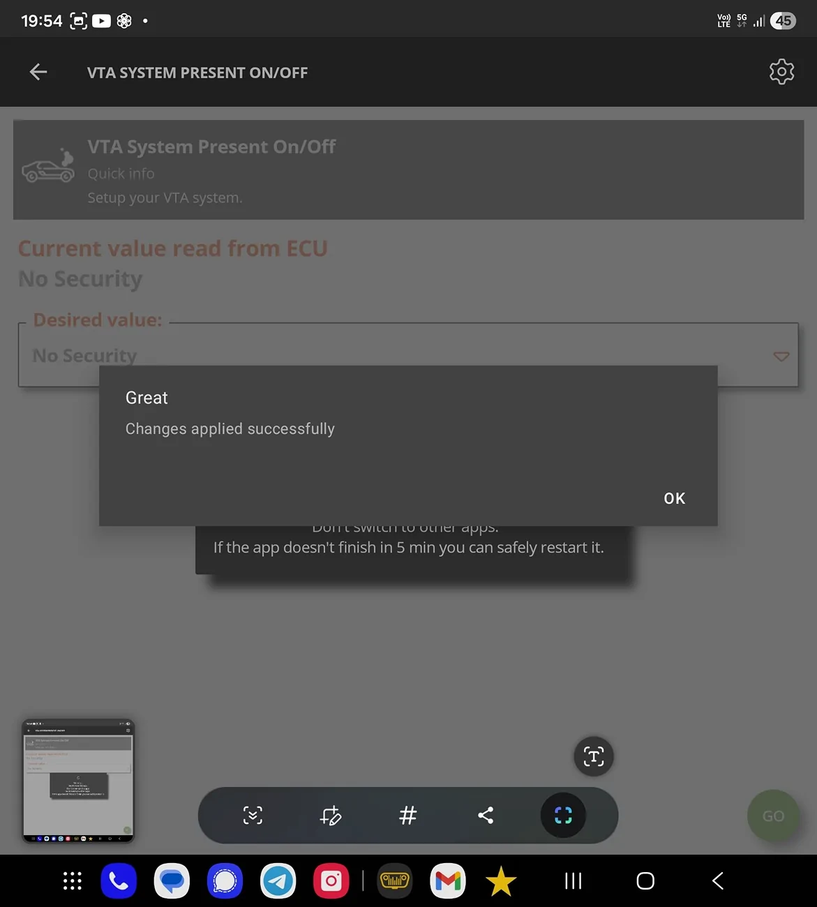

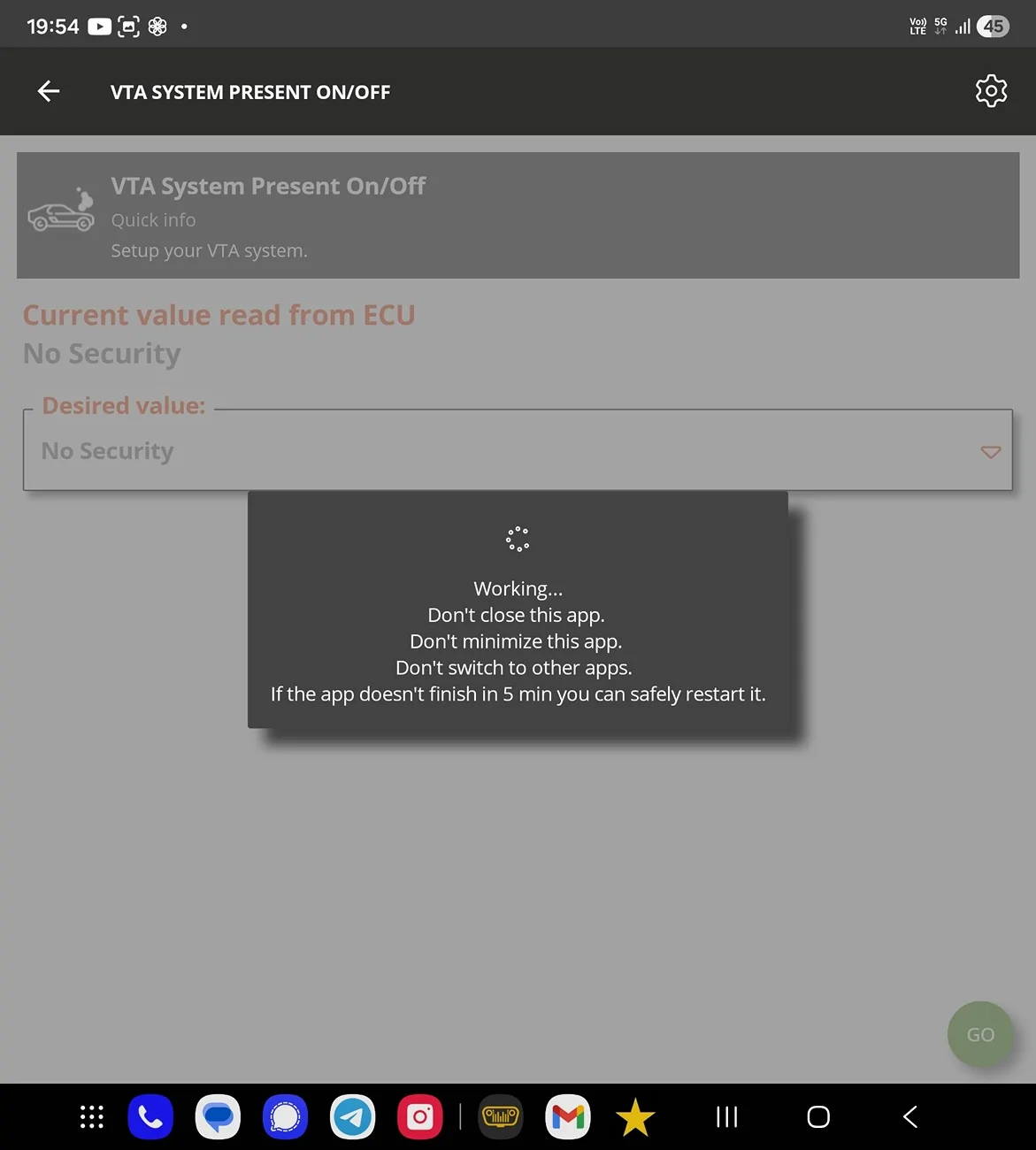

Changed but panic still working. S
Jeep Wrangler JL Panic button disable 14278
Jeep Wrangler JL Panic button disable 14280

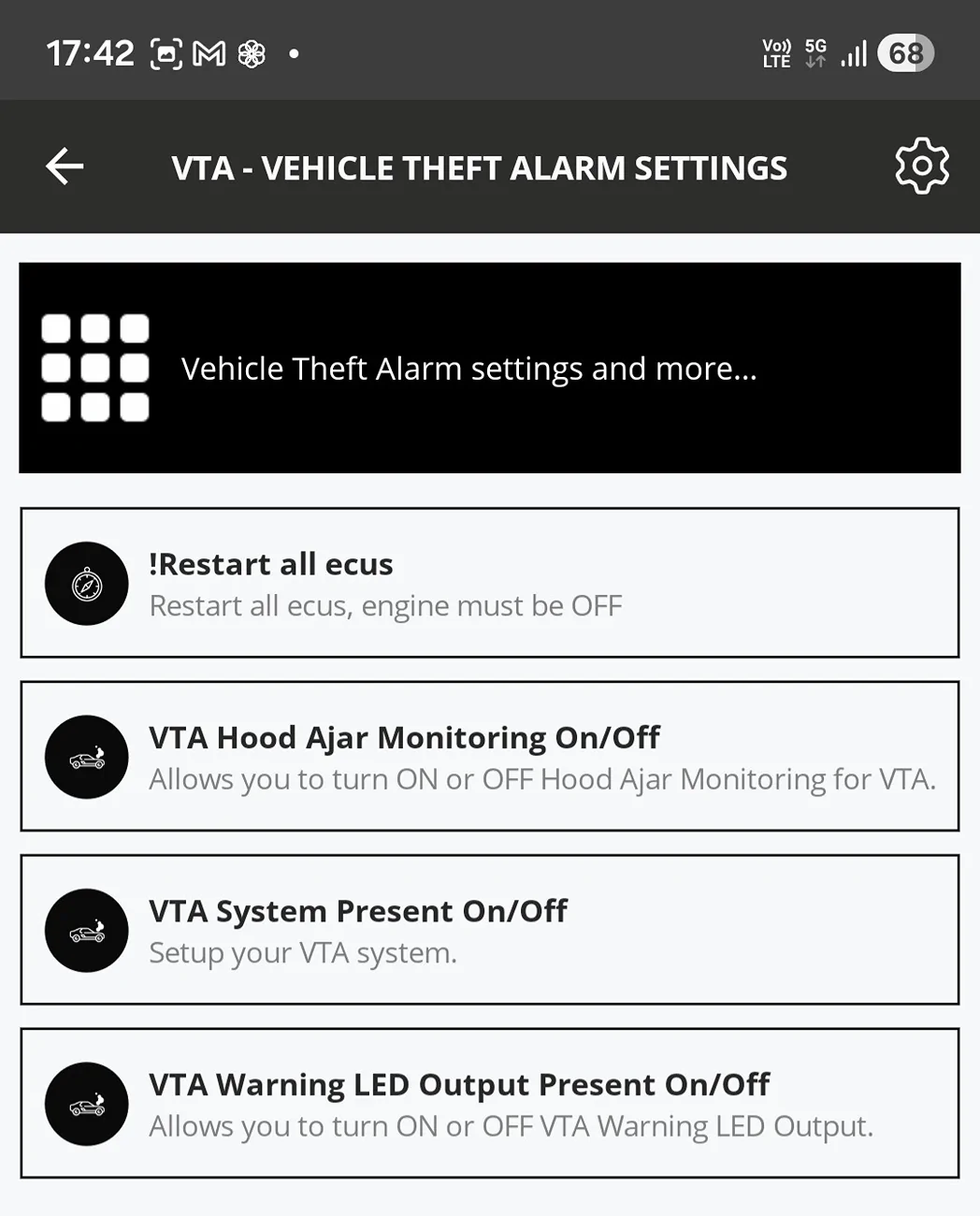

shoud I after saving, also restart all ecus? No security did not helped.
Thats weird, I tested mine by turning it back on and it worked and then turned it back off and it disabled it, I always choose to restart all all ECUS even though they say it’s not necessary.

So to be clear, you save "no security" disconnect the cable, lock the car and push panic button and nothing honked? if yes there should be another settings that anables this to work.
