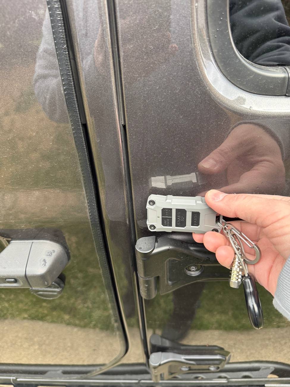

Resurrecting this for anyone that doesn’t want to go the tazer route, just hold your key here while you close your door and… no beeps! Works like a charm on my 22 Rubi.
Jeep Wrangler JL Disable Triple Honk IMG_4769

Resurrecting this for anyone that doesn’t want to go the tazer route, just hold your key here when you exit the vehicle, no beeps! Works like a charm on my 22 Rubi.
Awesome! Thanks! I've been leaving the door ajar.
I mean open slightly... not giving a Jeep offering of an empty jar...
I do what everyone else does and sacrifice my finest sheep on the full moon.
22 RUBI here too… will have to try this. Thx.
