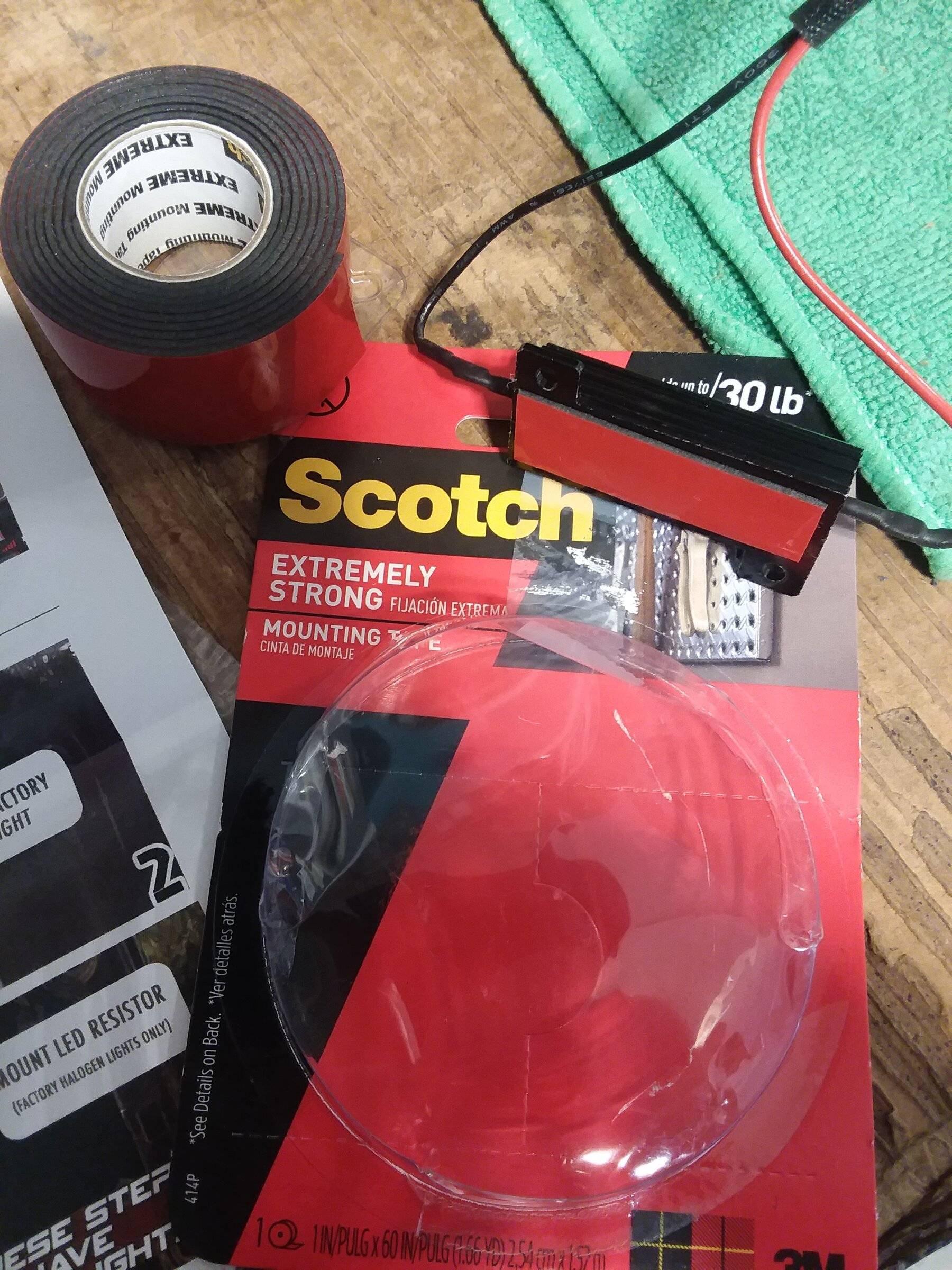

If the owner feedback in this thread (and the other one still active at this time) is accurate, the flush mount LED tail lights will function correctly on Wranglers with original halogen tail lights. No hyperflash nor dashboard error codes have been observed. Just plug and play.
N.B.: In the foregoing instance, the installer should be careful to use the included resistors. You'll need some double-sided tape to secure them to the vehicle, also, since it's not included (despite the installation video illustrating that it is provided.)
Jeep Wrangler JL Oracle flush mount tail lights!!! 20220106_130719
Wrangler owners with OEM LEDs are likely to experience, at a minimum, dashboard error codes, even if the Oracle tail lights otherwise function correctly when viewing them on the rear of the vehicle.

They're wire-wound resistors and are not needed if you have factory LEDs.
The canbus issue is fixable with a tazer or jscan.
