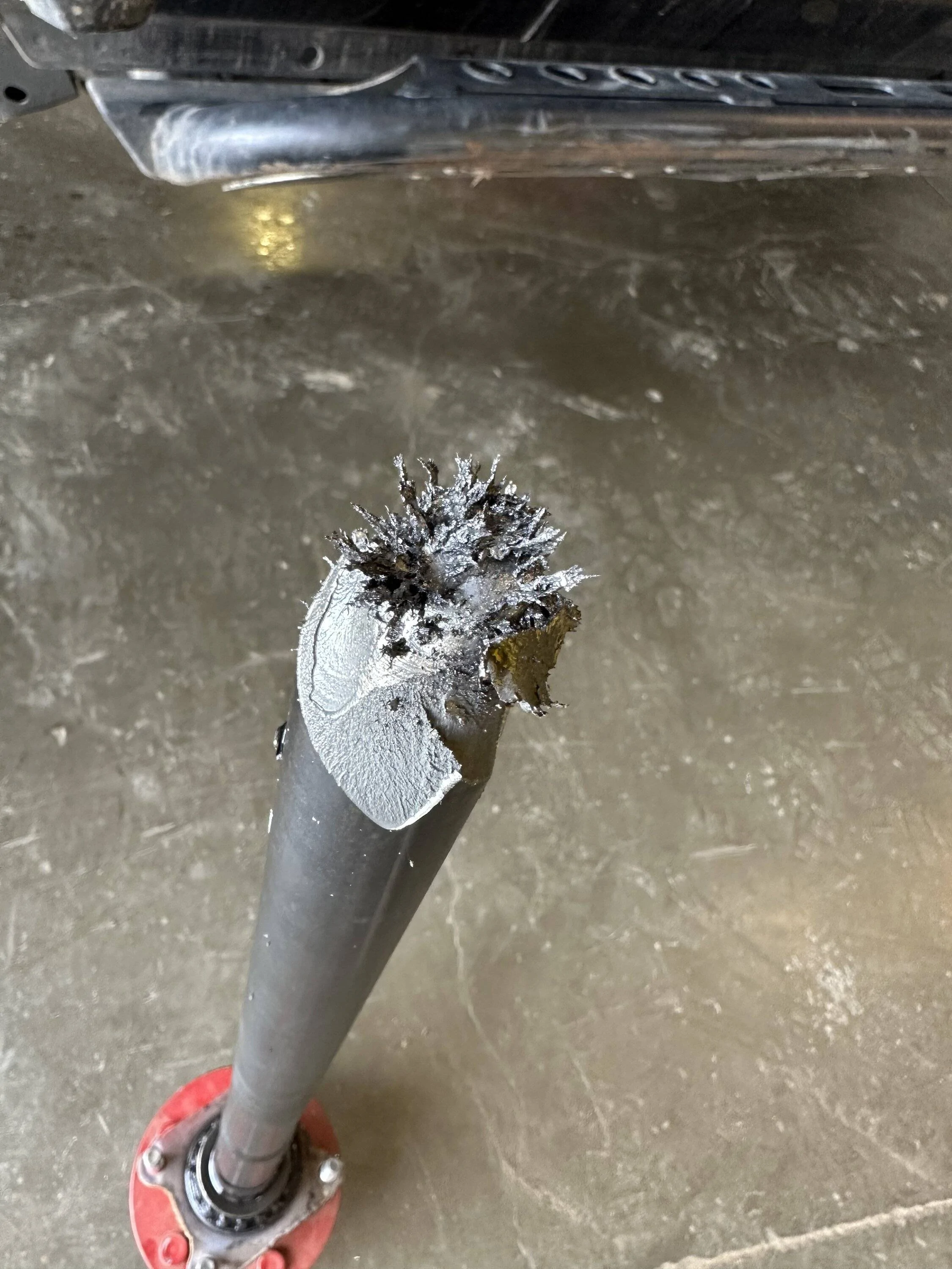

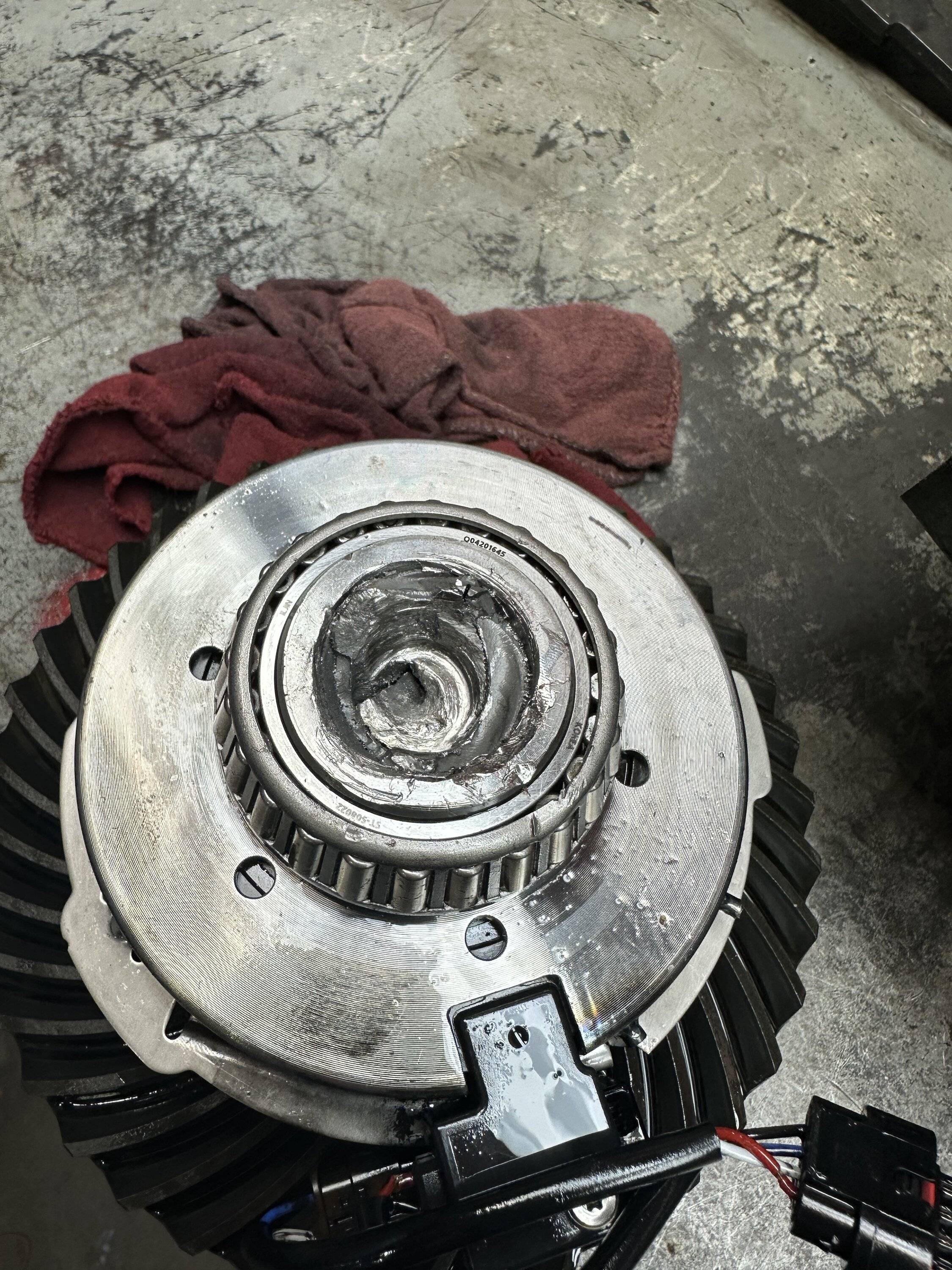

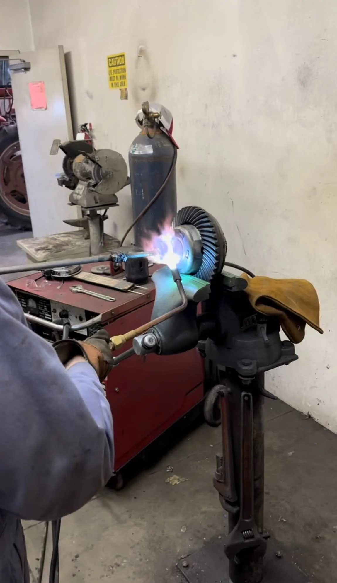

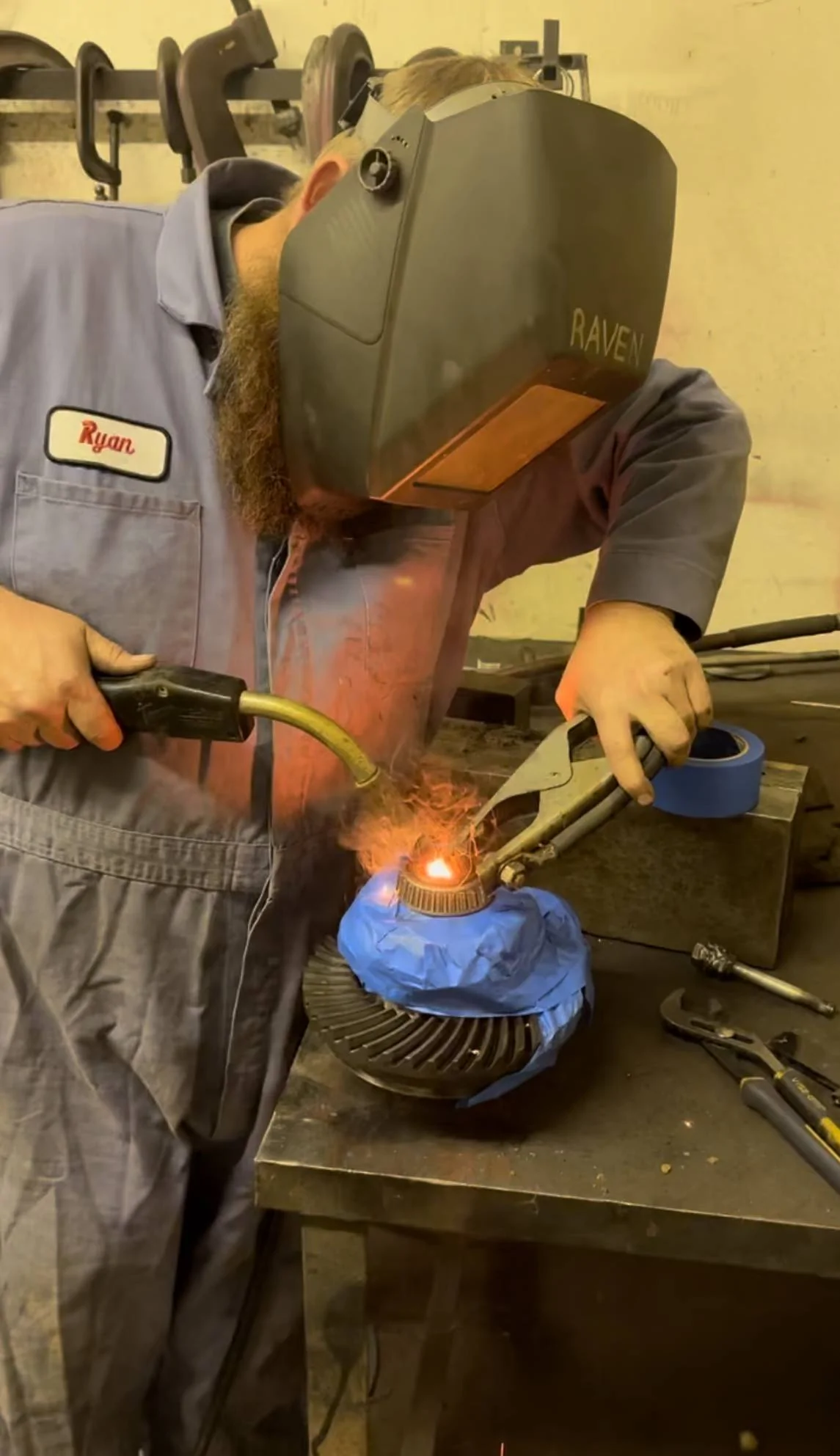

In case you need some extra motivation, I helped a friend slide hammer his busted shaft out of his carrier today. Diesel, factory axle and locker, 4.56 gears, Artec truss, Dana chromoly shafts, 37” tires.

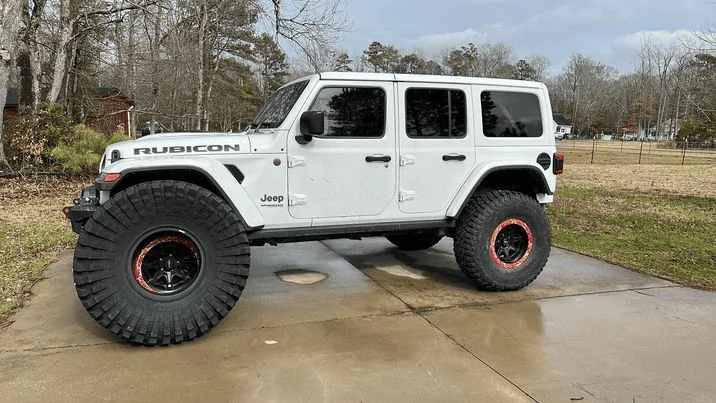

FWIW, I went with the KP60/Shaved 13 bolt Fusion4x4 to support the 42" tires I'll be running. They just showed up on Tuesday, and I ordered them on January 15th. Dan from Fusion was great to work with and answered all my questions and made suggestions based on intentions and I am really excited to get the install done.
Damn, that must have been some serious wheel hop going on.
