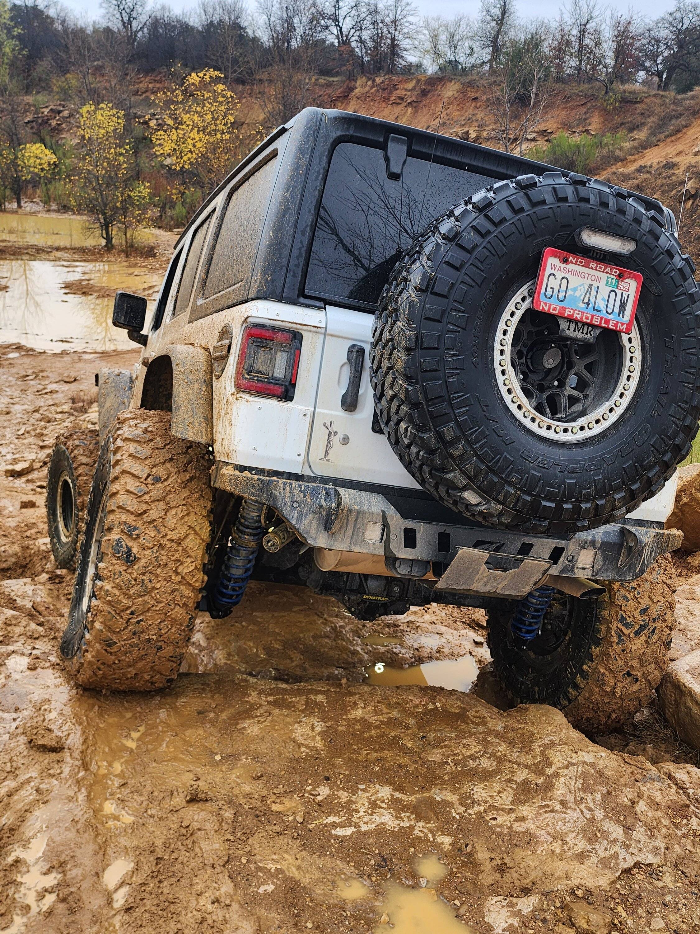

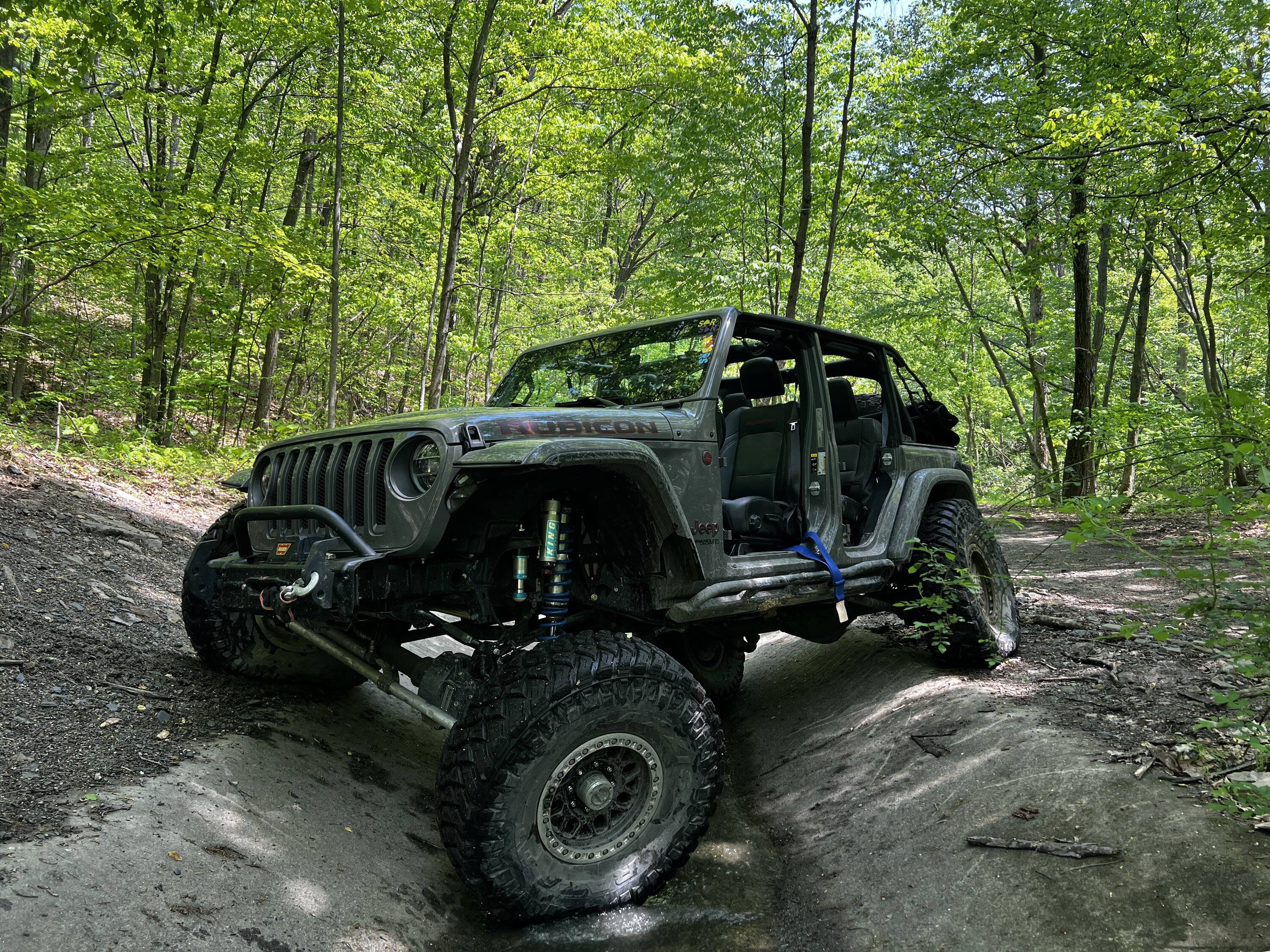

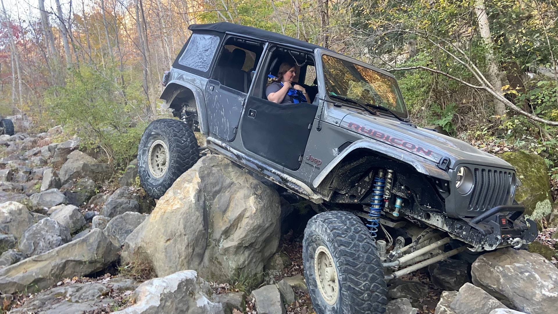

Research pointed me to Dynatrac. I went with the 68.5 because I was concerned about fitting on tighter trails...but I can't imagine anyone being unhappy with the 72.5.
The 68.5 feels really stable on the rocks, but I'd imagine the 72.5 would only add more stability.
