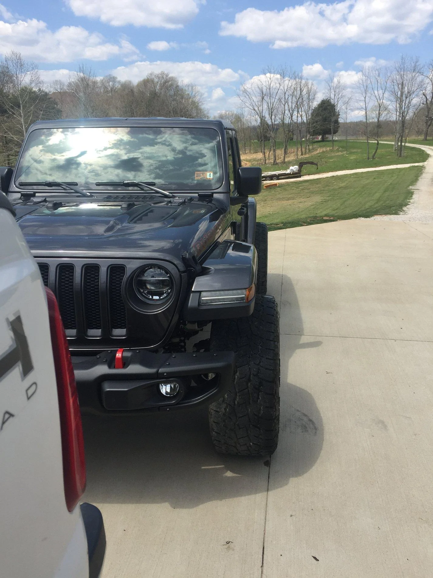

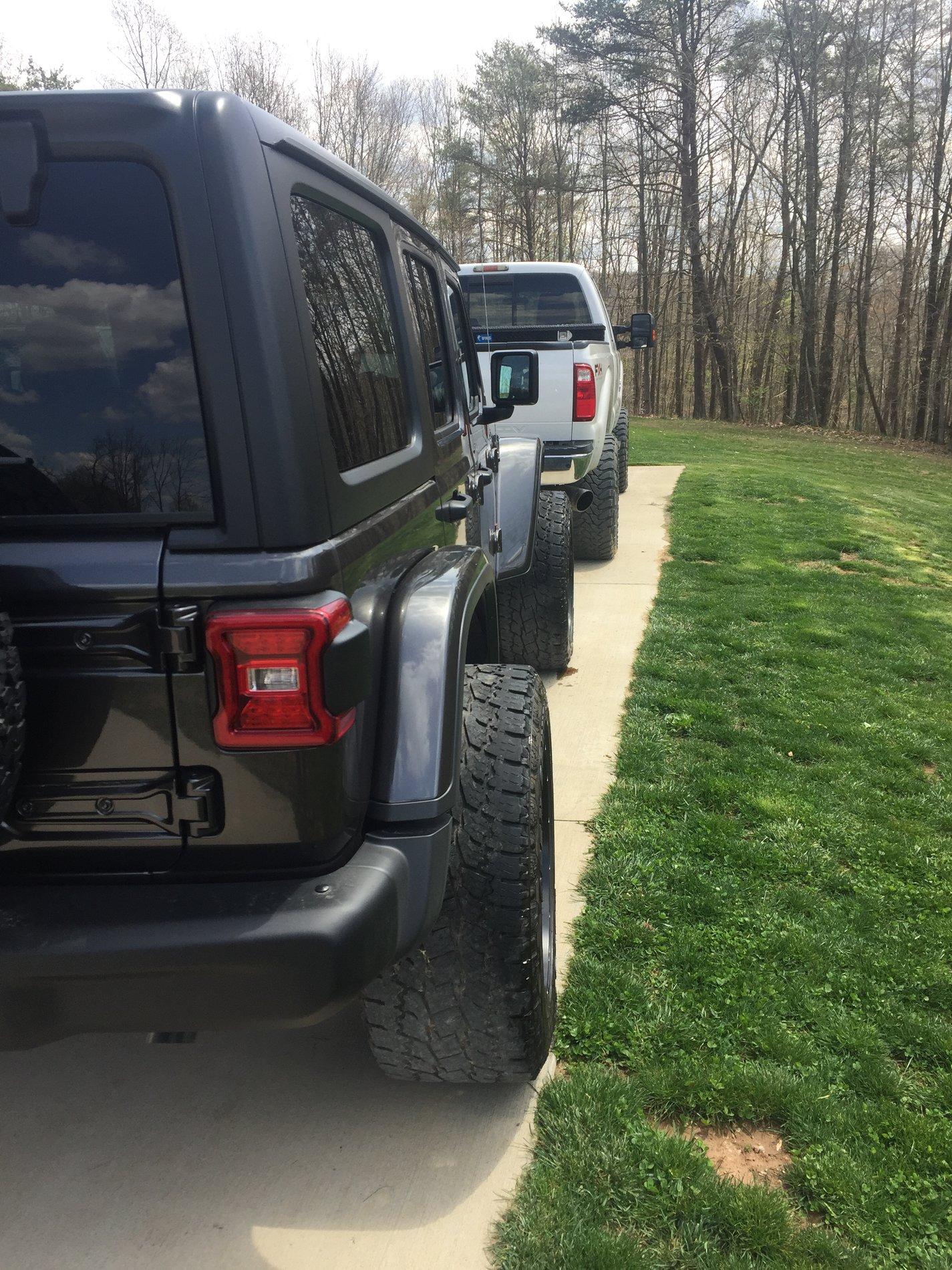

Yeah, I like the looks of the JK better with the tires not out as far. What wheels are in both? The same?I know this doesn't answer a lot of questions, but here is a comparison of my JLUR and my friends JK. Both have the same wheel/tire size offset and bs.
