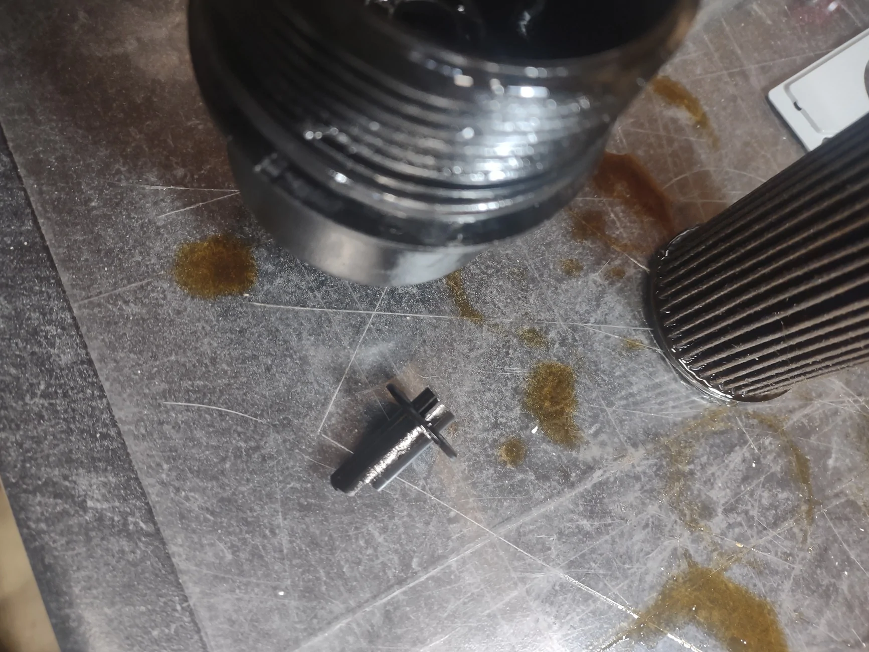

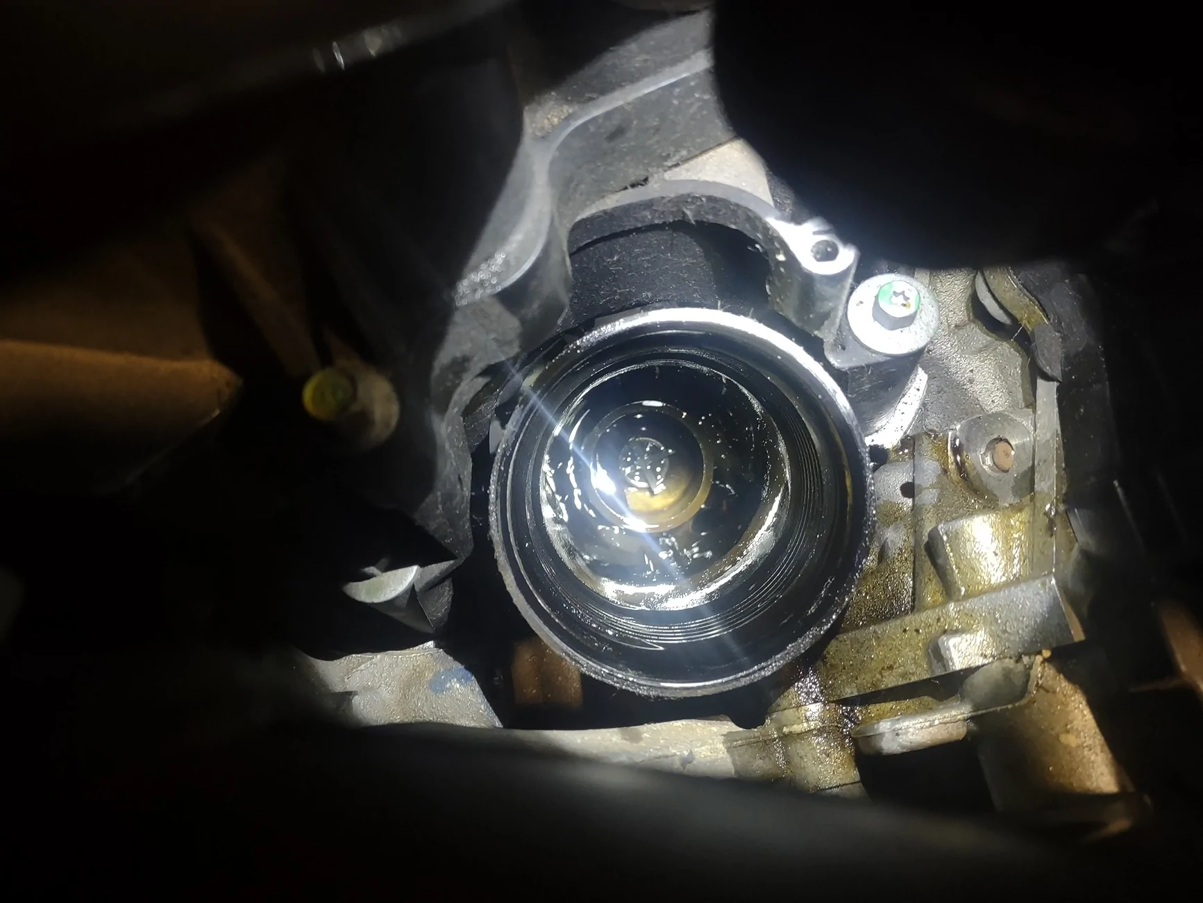

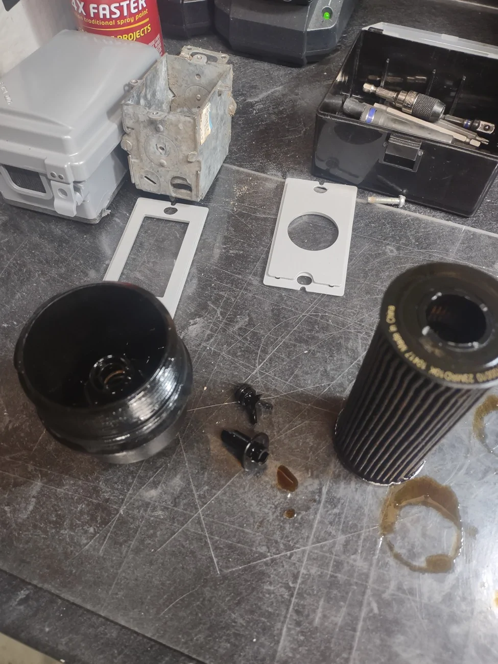

When pulling the old filter I noticed the cage was gone. Looked down in there and saw parts of it. Some from the filter...some from the cap. I was not able to locate the entire cage. Some of it went deeper. Perhaps processed harmlessly thru the rotating assembly and came out in the oil. Perhaps not
Dug them out and called the shop. Nobody knows what to do.
Now what? Some part of me wants to put a new filter and cap on and hope for the best. It ran fine up to now.
The cautious side of me wants to pull the oil filter housing/cooler assembly and either inspect/reinstall or put a new one on. Cant think of what more to do.

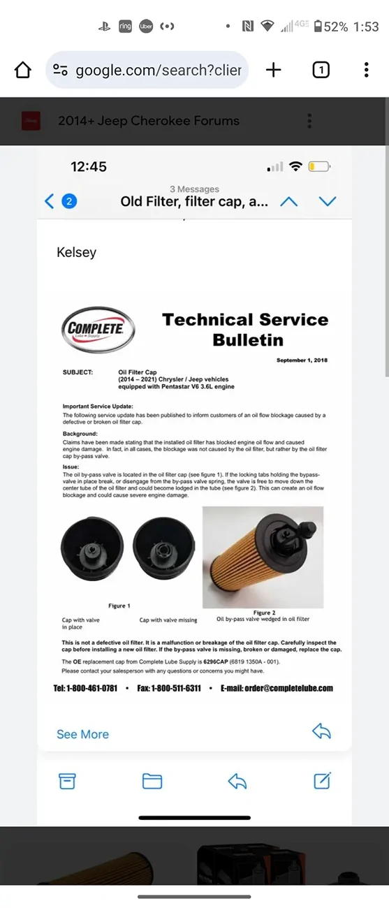

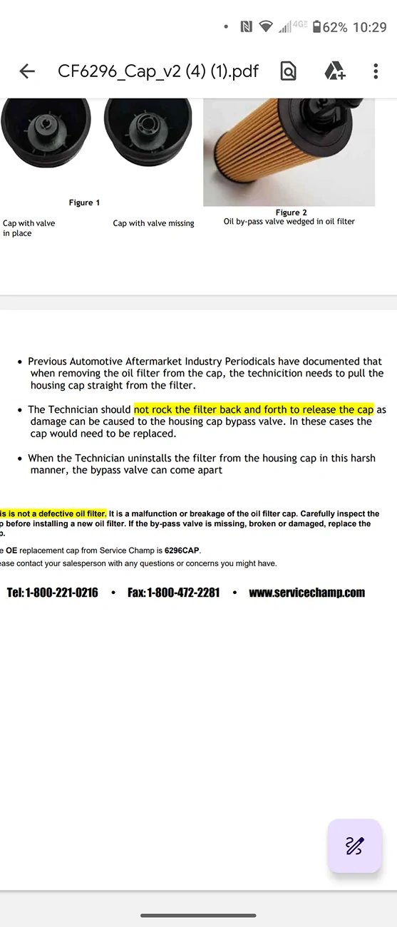

Who makes the oil filter? If the shop changed the oil, they may had used a junk oil filter and caused the cage to break off. Last time I did my oil change, it was ~$8.00 at the dealer for the mopar brand and $9.00 at Walmart for Fram. IMHO, not a huge price difference to take a gamble on a filter. If it was a bad filter, I would think they would be on the hook to getting it fixed, as it wasn't a mopar.
Another person had the same thing happen to them: https://www.jlwranglerforums.com/forum/threads/oil-filter-tip-broke-off.67968/

Looks like all the pieces are there. New cap and filter and good to go.
G.
That's the whole problem. Can't find all the parts. Tried fishing out, tried a boroscope... Some parts of this plastic cage went into the cooler. Will this hurt anything.... Maybe. Maybe not. Just trying to weigh out pulling the cooler or not

In case anybody is following this:
Changed out the oil filter housing. Could find none on the missing pieces of the oil filter cage.
Somehow they passed thru it. The only thing i can do now is pull the pan and inspect.
Oil pressure normal. I'm running it.
