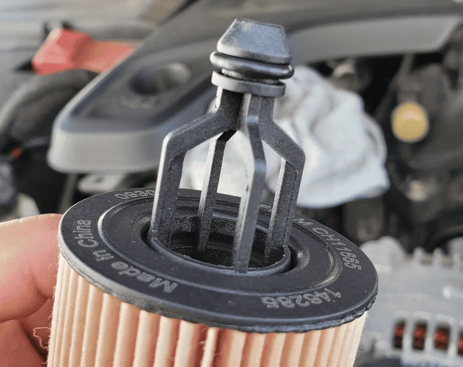

I'm not a fram expert here, but looking at the picture on walmart, the new one has the black o-ring. The one that broke has an orange o-ring.
Looking at some other pictures online, I think mwilk02 was correct in saying that it's a fram titanium, FS11665.
Looking at this though, I think I'll stick with mopar filters. I always hear bad things about aftermarket filters, but haven't heard much about OEM filters.

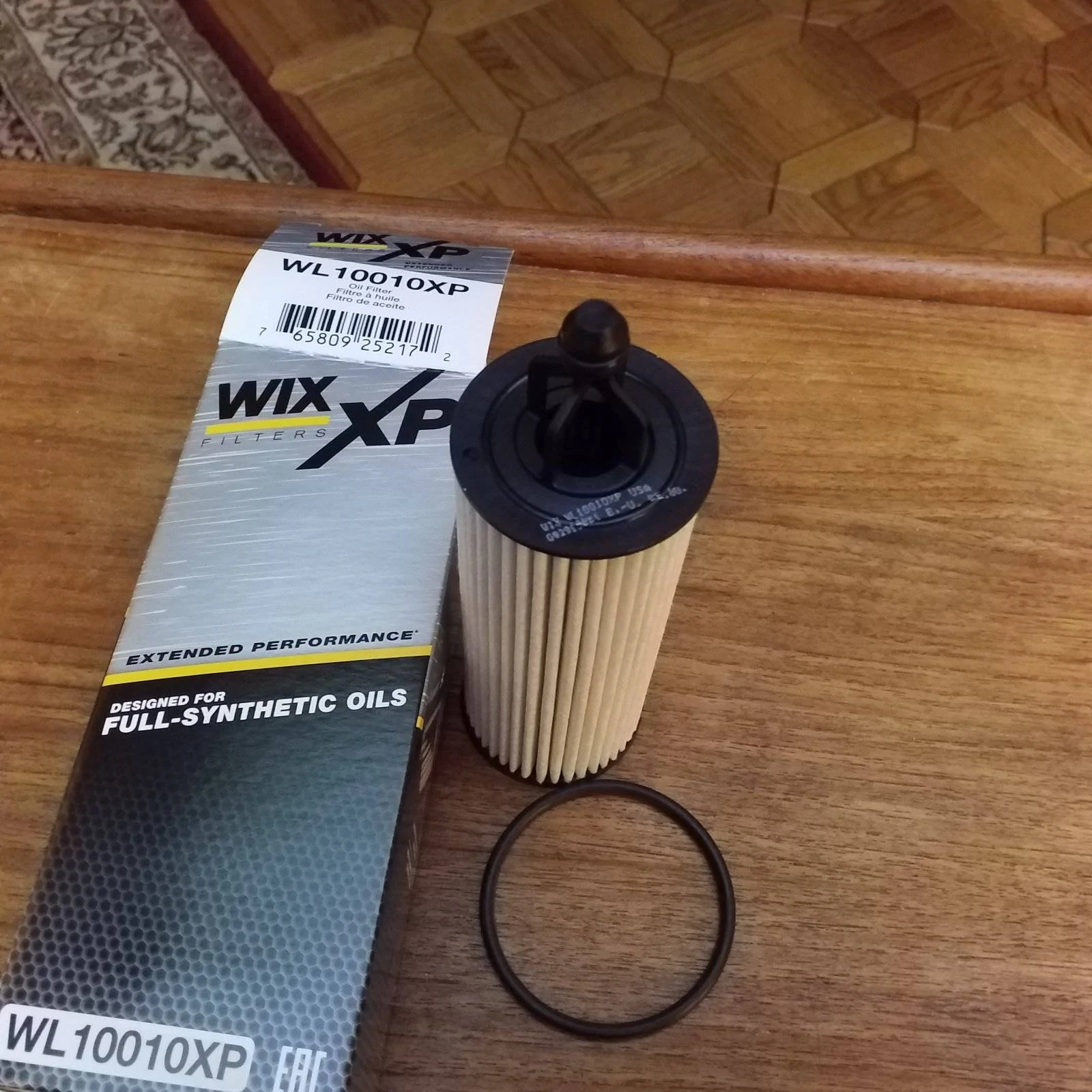

I've been using Wix filters in everything for years now. I bought a box of 10 of these before the first oil change.

Wix filters are excellent, not surprising they'd have a good option for our engines. Good to know if I need one in a pinch. I just use the OEM because my dealer gives them to me at a pretty decent price, and I like talking to the parts guys every now and then
