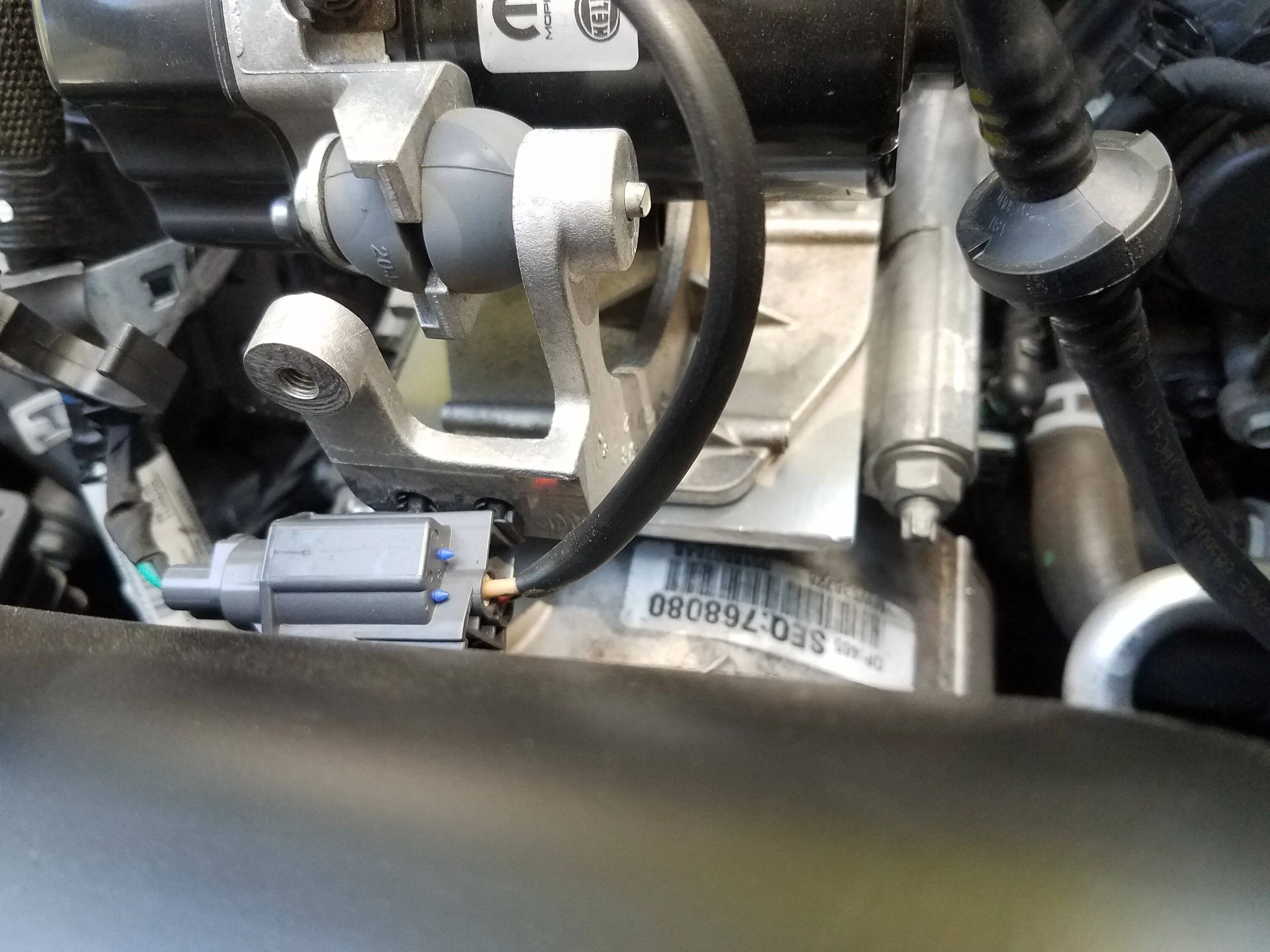

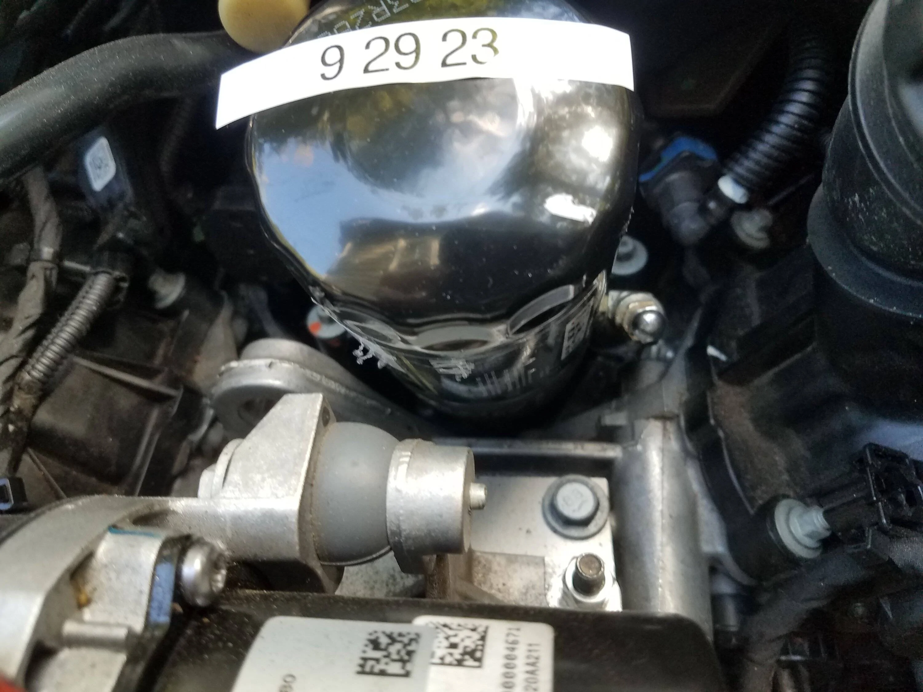

they said that was normal that it does have a two stage oil pump. i bought a ms201bk by baxter for my wrangler sport unlimited 2021. i had to buy a 8x12x1/4 aluminum plate for $20 on amazons to move the pump that is located towards the front from the oil filter. i think it has 4 small bolts that hold the pump in place if you dont move the pump the new filter will not fit. you cut it to fit .make sure you turn the new filter on by 10 turns mark the top of the filter so you know what ten turns are. i didnt at first and the next day after engine had cooled i got ready to leave and dump all the new oil on the floor of my basement ,now 10 is the turns for the filter not the adapter unit.

very easy to do i laid a piece of card board under the pump mount drew out the shape cut and drilled four holes. i think the little bit of work was worth it. i also installed a catch can

i have a 2021 sport unlimited wrangler. they told me they were hoping to come out with a different setup because he said it wasnt listed for my jeep but all that was required was moving the vacuum assist pump forward about 1 inch so the filter can can be screwed and unscrewed without running into the back of the pump
