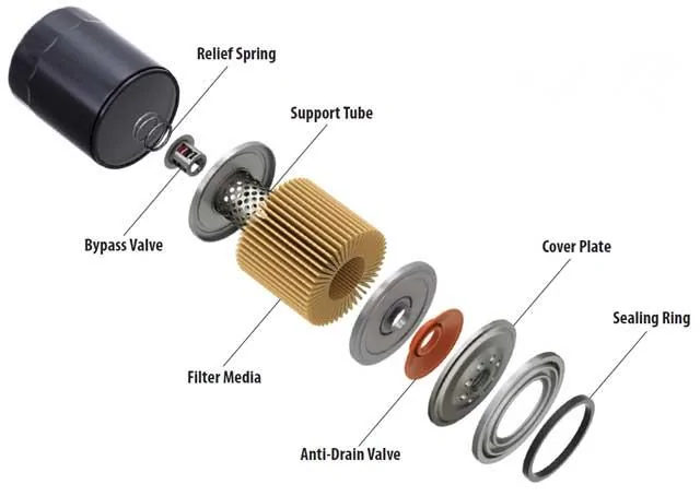

The Baxter along with the spin on oil filter both have a anti drain back valve keeping the oil up in the filter.
I was shocked the first time a change my oil finding NO oil in the filter housing and the filter filter was almost dry. All the oil had drained out of the housing and oil cooler back to the pan leaving a large air pocket that now has to be pushed though the oil galleys on cold start ups.
