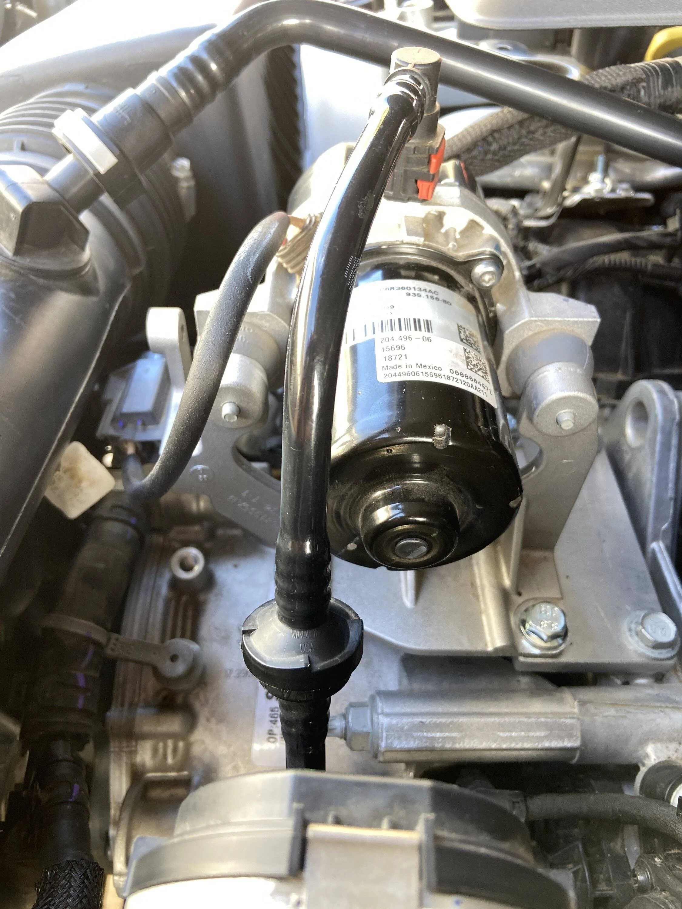

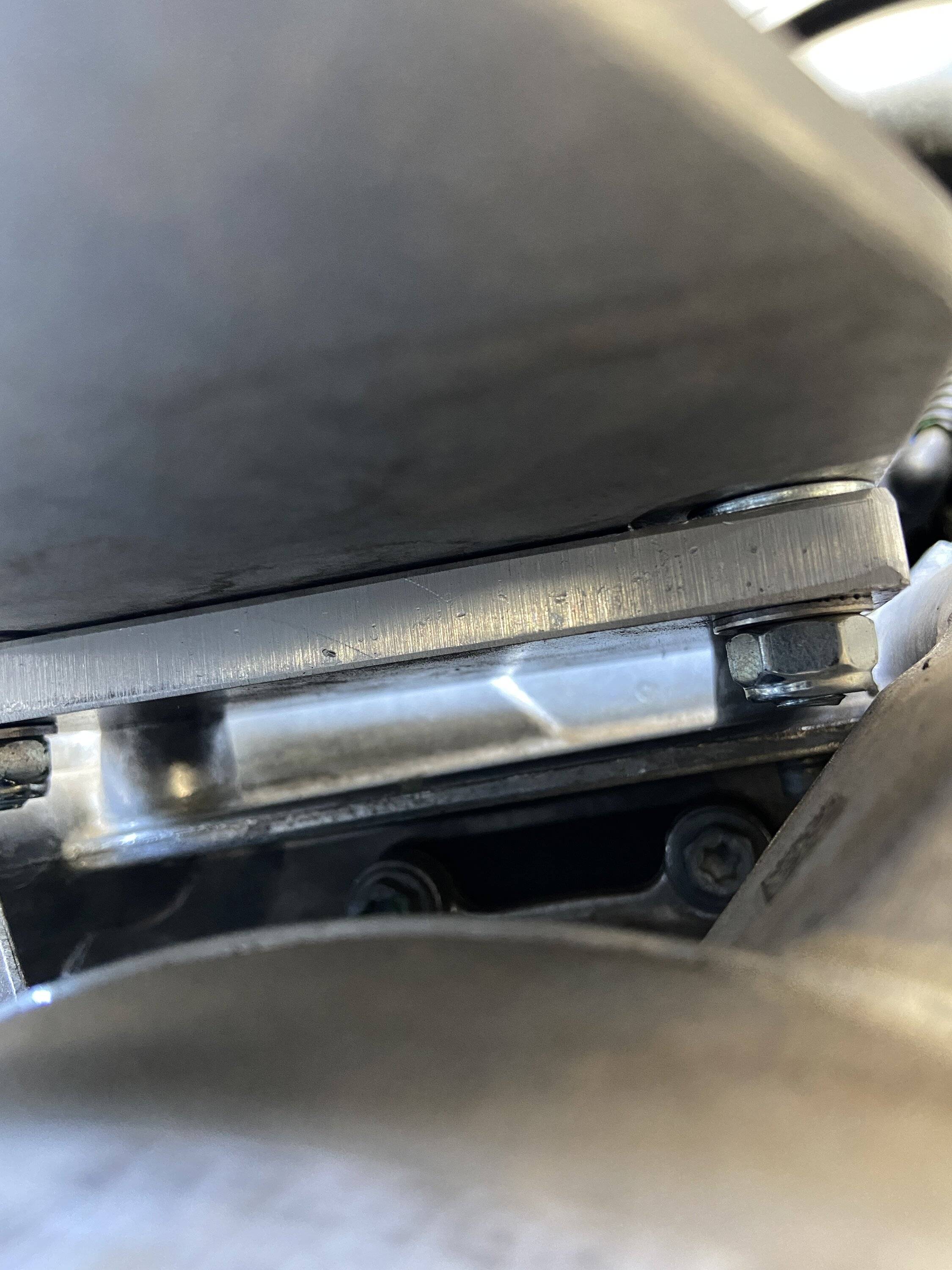

I ordered the baxter spin on adapter for my 2021 3.6 e-torque as the dry starts in the morning were driving me bonkers. Kevin contacted me and said it didn't work with the e-torque. I started looking at the issue, and Jeep put the stop start vacuum pump right in front of the oil filter that gets in the way of a spin on filter. I took the pump off, looked at it and figured I could make a bracket to move it forward. Told Kevin I would make an adapter and ordered the spin on adapter. Last night the jeep was due for an oil change, so I installed everything. The adapter is just some 3/8" thick aluminum I had a scrap piece from. The plate itself is 4 13/16 wide by 2 3/8 and 3/8" thick. I used 2 8x1.25 25mm long flange bolts with locknuts and some washers between the pump bracket and plate. We measured the center of the holes at about 3.95" but I used a transfer punch and clamped it together to mark the holes, so YMMV. The plate moves the pump forward 1.25" and gives enough room and thens some to get the filter adapter installed. I've attached some images of the installed setup here.
