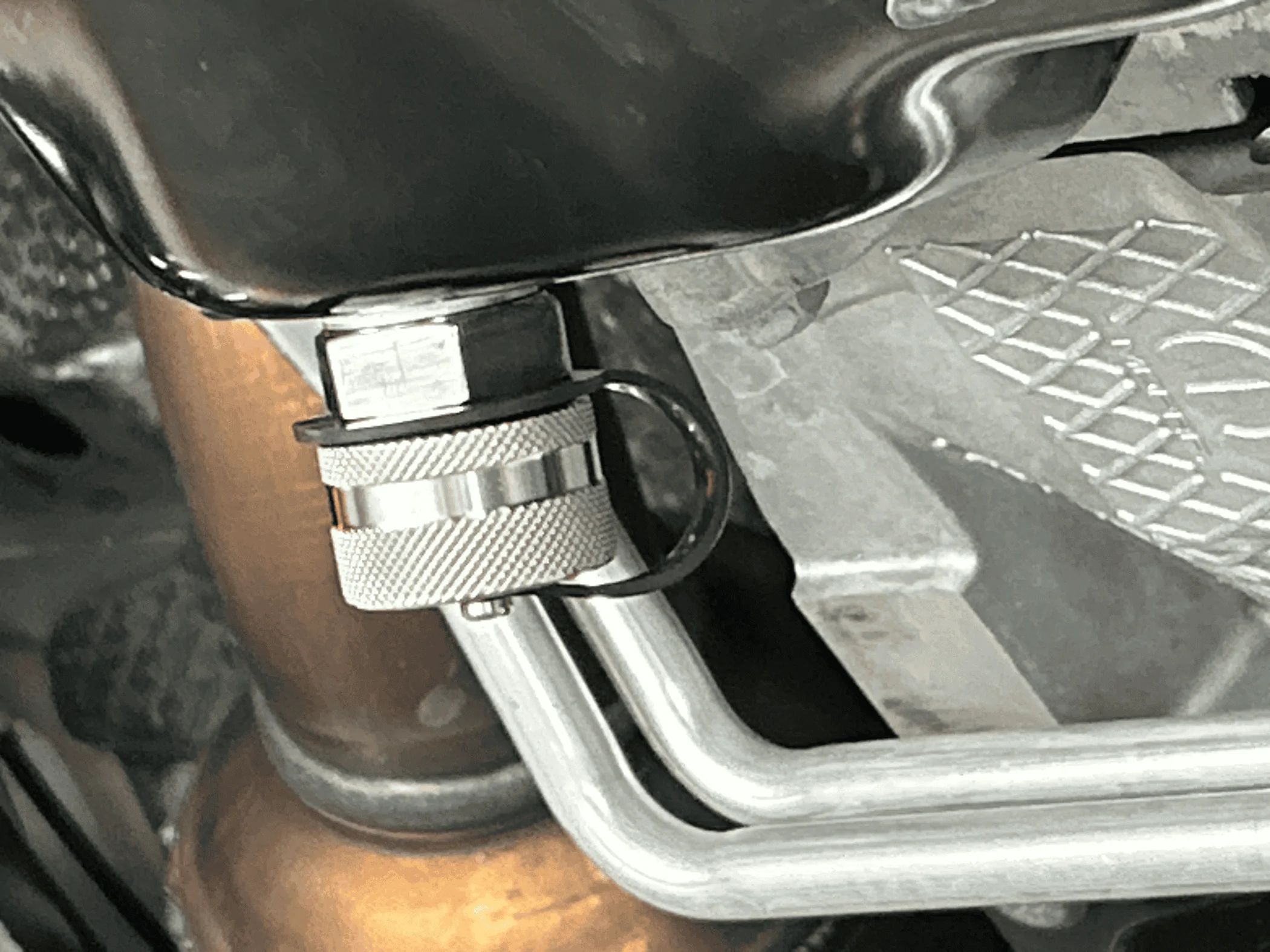

Valvomax is my go-to. I drain it directly into the bags they provide. No mess, no bs plug.
I love my Valvomax but what bags are you talking about? I drain into the 5qt oil container.

Just so it is in this thread: What size Fumoto? And anyone using ValvoMax?
Yes I am using the Valvomax on my 24 392. Works awesome! Thread size is M14-1.50. Made in the USA!
