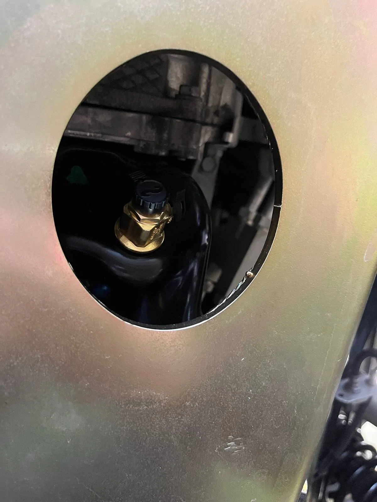

Every time I see this, I can't help but think it's a bad idea because of how far it would hang down. You're better off going with something like https://nospillsystems.com/ since then it's no worse a clearance/rock catching issue than a normal drain plug.
I have been very happy with my Fumoto valve and feel that it is not in harms way, with or without the metalcloak under armor. This is on a 392 steel pan.
