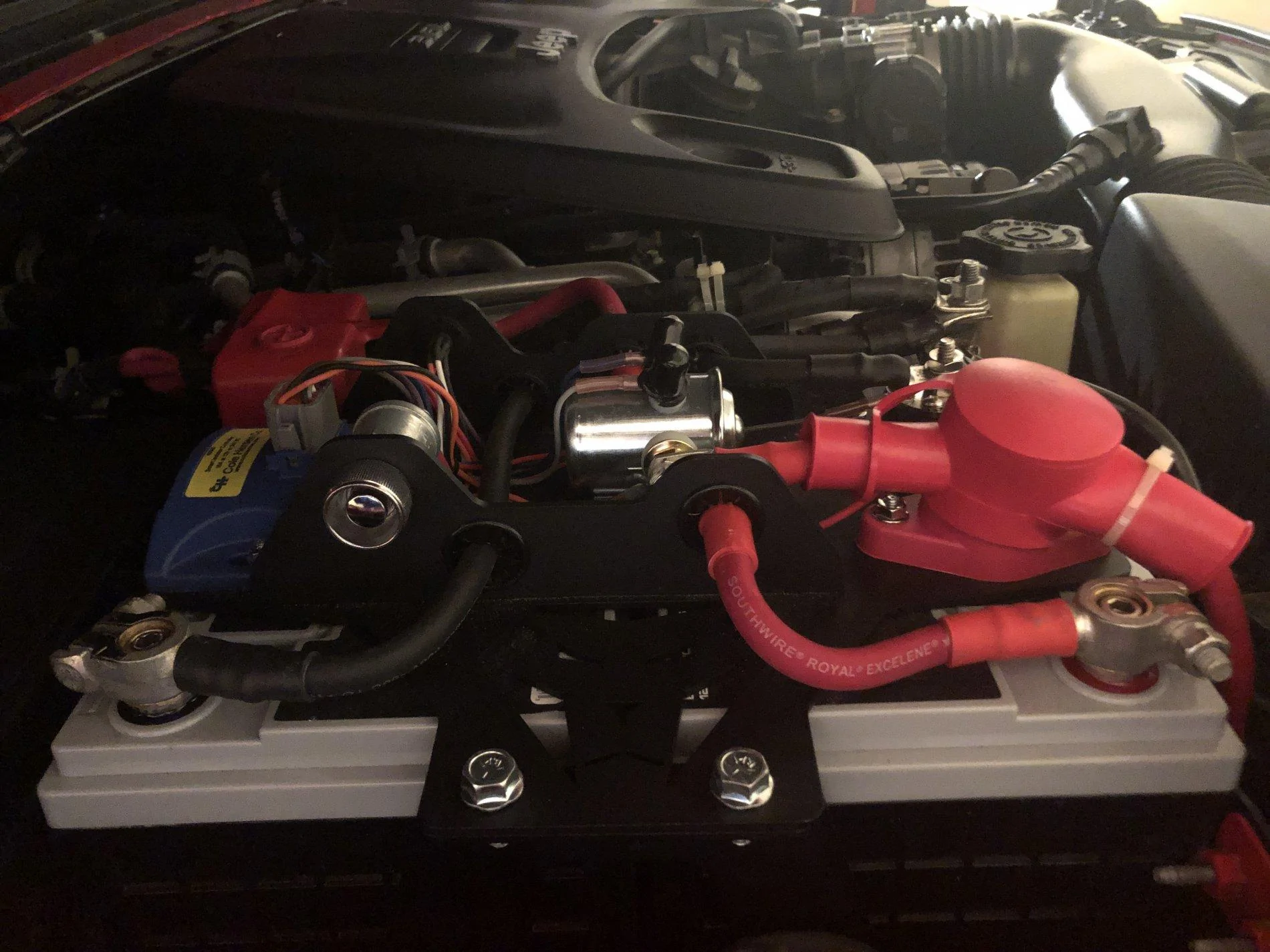

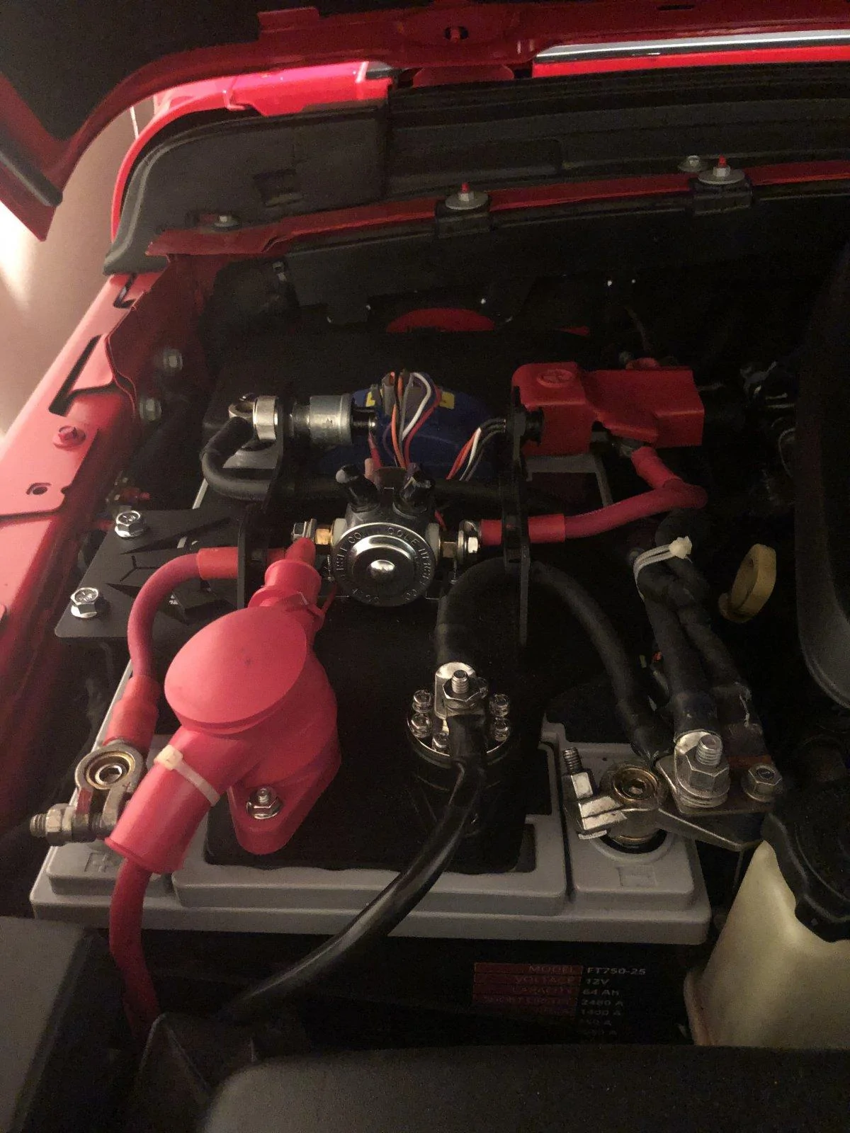

What is your set up? Can i see? Pleasseee haha
Dual Full River 750-25’s
Jeep Wrangler JL OEM Battery Replacement F65DD868-3BEB-46F0-87D1-AA2634E64E07
Jeep Wrangler JL OEM Battery Replacement 16690771-4C1F-40AC-A6DC-C07D2C64F23F
Noco 10 for the quick weekly top off
Jeep Wrangler JL OEM Battery Replacement 669EE251-4BA4-4A53-A6DF-179CC2E41850
Odyssey 20 for the monthly recondition, I like the Odyssey for this as it has a deep condition cycle and it holds the voltage at 14.5 for several hours.
Jeep Wrangler JL OEM Battery Replacement 0ADAF3D2-20BD-43ED-968E-D324584AE794

Did full river make the dual battery charger or was that home made or genesis?
Both the NOCO 10 and Odyssey 20 amp chargers will charge a single or dual battery setup, on the stock JL setup both the main crank battery and ESS battery are connected as one when your JL is parked so when you use the charger of your choice connected to the +/- main crank battery you are effectively charging both the main and ESS batteries.
On my particular setup the batteries have a smart isolator that keeps them connected as one battery 99% of the time utilizing a electromagnet solenoid that stays energized and once the main crank battery drops to 12.7 +/-.1 the smart isolator automatically disconnects the two batteries so you main crank never drops below 12.7 while using things connected to the aux like winch, air compressor etc...
Once the JL is started after the isolator sees 13.2 for several minutes it closes the relay again and the batteries again are seen as one.
i hope this answers your question

I meant like the actual dual set up in your jeep, sorry for the confusion, like did you wire up the smart soloniod and all that your self or was it a kit?
Oh no worries.....I got it as a kit and had the local Offroad shop here in Houston do the install. It’s supposedly not hard to install but I personally was not comfortable removing the PDC.
Its not an inexpensive setup once you add good quality AGM batteries in, you can get less expensive on batteries but I chose Full River....If I had to do over I would have likely went with Odyssey as the small increase in cost yielded a slightly better battery but my main reason was to have all the aux add ons connected to the full size aux battery plus just having two full size 64 ah batteries that are identical and charge the same makes it simple plus the dual system I’m running has a boost button so say you leave lights on in your JL or similar and pull the main battery down and your Jeep won’t start you just push the boost button and it will connect the main and aux for about a minute so you can start your Jeep and be on your way but this is providing the aux has sufficient power and it should.
My system has been installed for a few months and just recently I was listening to some music and had some lights in and sucked the main down and it would not start :whew: I was like WTF... anyway I popped the hood and pushed the boost button and after I heard the click of the solenoid I jumped in the jeep and it fired right up and down the road i went and this one time event justified the cost to me as I was out and away from anyone to get a jump start.
I will say my JL seems electrically more satisfied with the additional power, maybe it’s a placebo affect on my part to justify the cost but it cranks up easier and just seems to run better
Heres the info
https://www.genesisoffroad.com/jl-dual-battery-kit
